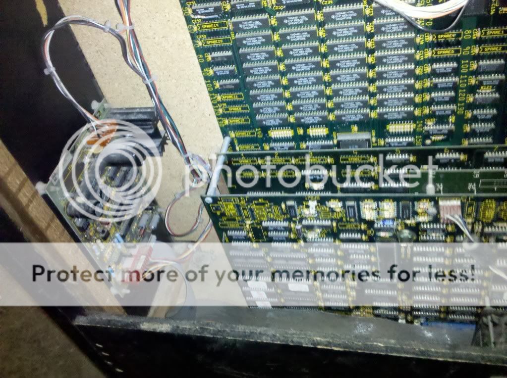

Does the light on the shifter board come on when you power the game? Mine doesn't, and my shifter doesn't do jack squat on the tests. Registers nothing. I put a different shifter board in, no change. Checked voltage to the board, it's good (17vac). Haven't gone into detail in the wiring, I'm assuming it's an issue in the shift mechanism somewhere, unless there's something wrong with both my shifter boards. Neither are known good or bad.
Rest of the game tests out fine aside from the seat magnet, which I haven't looked at yet. That's next.
If you can google me up a link for a picture of the shifter board and let me know exactly what you are looking for I will check on mine.
Sorry for not knowing. I am not a game builder or technician so I really do not know what I am looking for.
-Ronnie
It's the small board on the left in the following picture...

Fixed my issue. The shifter board ribbon cable #1 pin goes on the left side of the board as you face it, not the right. I flipped the ribbon cable and it powered up and it's working. The lock isn't, but the wiring is so nasty to the shifter I was surprised anything worked.
What a ton of trouble for a backwards cable. Thanks either way, guys!
