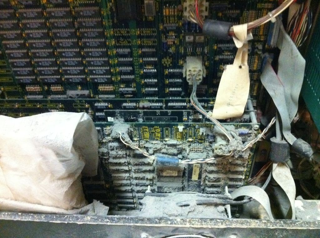

Got the chips yesterday - I went for the timekeeper in the end as there was a minimum order charge from the company I used (Farnell), but they were still cheaper than Mouser in the UK.
Removing the PCB and the two ZRAM chips was surprisingly easy, I thought it was gonna be more difficult than that. Took lots of photos first to make sure I connect it all back up correctly.
Here are the little critters.
http://s1176.photobucket.com/albums/x322/dannyboyy75/Hard Drivin/?action=view&current=IMG_0856.jpg
I've installed the new chips but not put the PCB back in yet, as I want to clean it with compressed air first (and hoover all the dust out of the area where the PCB goes, as it's pretty nasty in there). Hopefully it all works ok when I fire it up again :-O

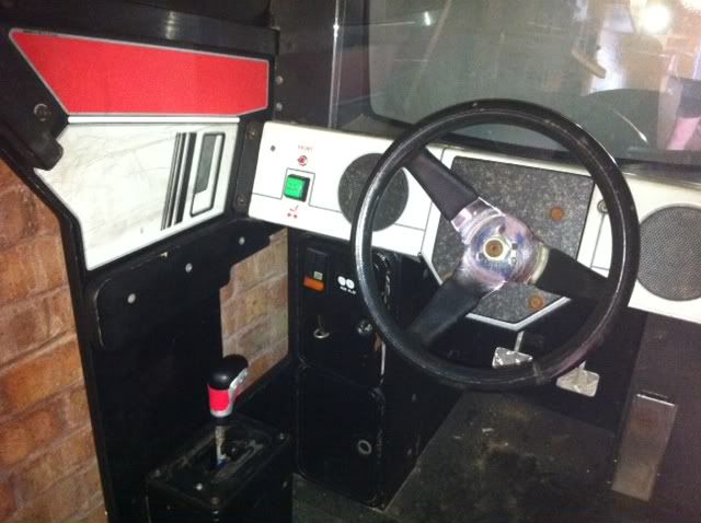

I was just checking out your photos. It's interesting that the UK roms have the gear shift indicator on the right side. Is the actual shifter on the right side of the cabinet as well? Did they change the tracks to place you in the proper lane?
Mine was the filthiest game I think I've ever seen. It must have been in a laundry mat or something. It was full of lint like dust.
Wow, maybe mine isn't so bad after all. That's a LOT of dust :D
I hadn't even noticed that - where is the gear shift indicator out of interest?
Yeah mine's a RHD version that was built by Atari Ireland. The gearstick is on the left, same as it would be in a British car. Is it also on the left on the US version then? You're right that the cars all drive in the left lanes too, so as you crest the first hill to take the speed course, you have to keep left to avoid the green car.

It was so dirty, that it took me a while to figure out there was a plastic bag full of manuals tucked in front of the PCB! You can see it in the picture. Luckily, it was just light fluffy dust that was easily sucked out with the shop vac.

On the screen in one of your pictures, it's on the Left side by the gauges. On the US version, it's on the right side of the screen.
That's awesome. The US version has the gear shifter on the right hand side, and the oncoming traffic is in the left lane, so you have to keep right. Also, I notice the rear view mirror (on screen) is on the left side on yours and the right side on mine. I love the attention to detail that Atari did on the Hard Drivin/Race Drivin games.
