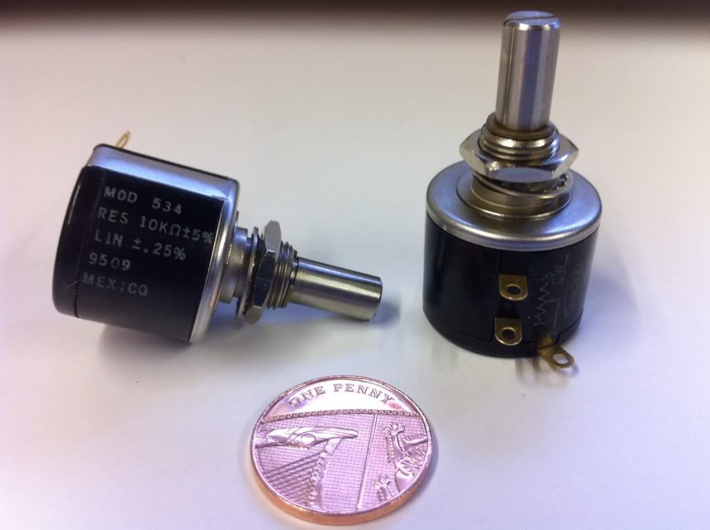

Here are the spare pots that I found inside my game, with a British penny for size comparison (~ 2cm diameter):

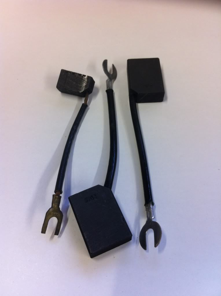

Going slightly OT here, but I also found these spare parts inside the game, I have no idea what they are though. Any ideas? :)

The other pic is of the motor brushes. While you have it out, you should check the ones in the motor now and perhaps install the new ones if they look worn. The 2 on the right look new, so they would last probably another 30 years...
Ah, so those are the brushes. Not so OT after all then. I guess there's no harm in me installing the 2 new looking ones while I've got the steering assembly out then - hopefully between replacing those and the pot it will sort out the twitchy steering.

They are Spectrol 534 pots. I found them for sale locally at my favorite parts supplier, RS online:
http://nl.rs-online.com/web/c/passi...4886244&lastAttributeSelectedBlock=4294956758
The cheapest one that doesn't have a picture actually has a link to the original Spectrol datasheet. It looks like Vishay acquired Spectrol as the datasheet of the Vishay 534's says Vishay Spectrol. They also changed the color. Good to know I can order them, relatively affordable, no shipping costs :)
Checking the datasheet Atari chose the sturdiest one, rated at 1.000.000 turns.....

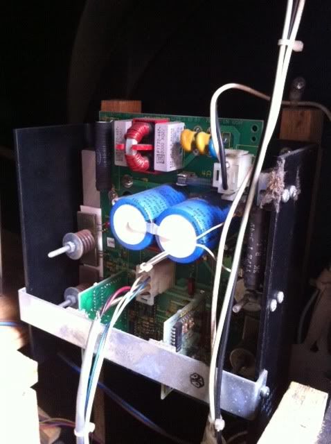

* Remember the motor and motor amp board handle 120V, so make sure the game has been unplugged for at least 5 minutes beforehand! *

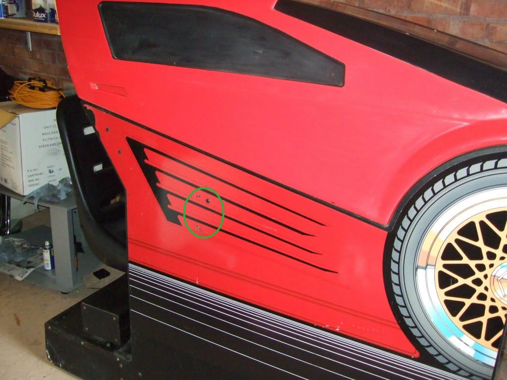

1) You have to start by removing the two bolts on each side of the game:Pic 1
2) Then remove the two Philips screws in the front of the dash assembly (no pic for those as you can't miss them). EDIT: Also remove the cover under the dash (2 Philips screws). I forgot this as it was already removed from my game.

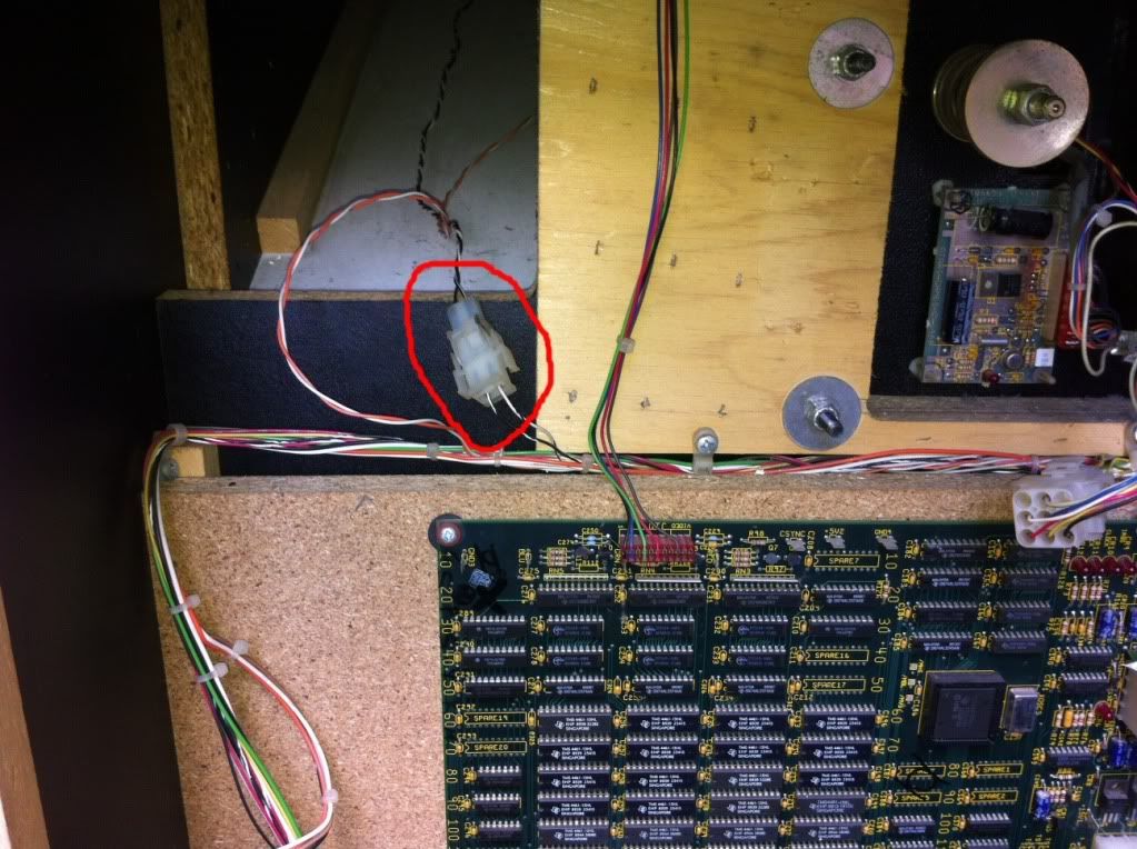

3) Next you disconnect four wiring harnesses in the back of the game. On the left side is the right speaker connector: Pic 2

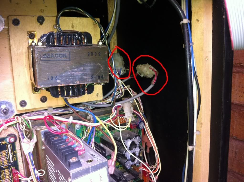

4) Then on the right side, the 3-pin and 9-pin connectors in Pic 3, followed by the 6-pin connector on the motor amp board (below the blue caps) Pic 4

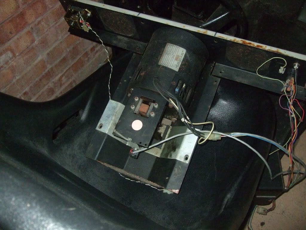

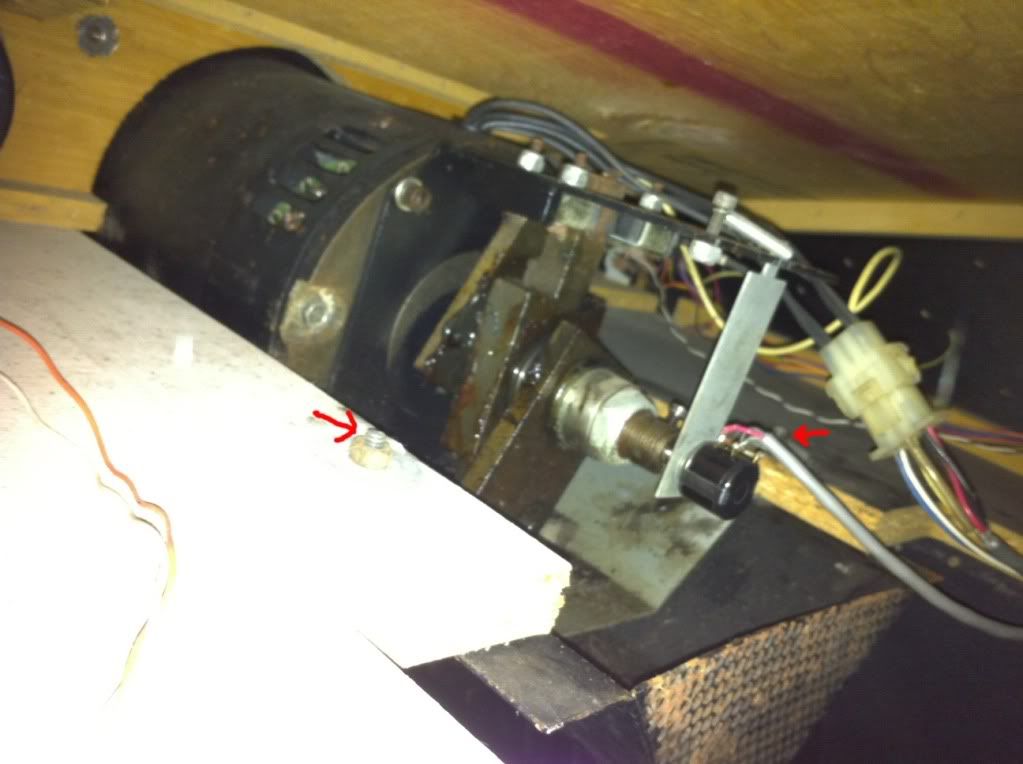

5) Now reach into the space behind the pedals in pics 3 and 4, and undo the two nuts highlighted in Pic 5. The bolts will drop down into the cockpit area at the front. N.B. I also had to unscrew the bit of wood with the transformer bolted to it in Pic 3, to allow me to access the nut on that side.
6) You can then sit in the seat and slide the dash assembly out onto your lap (did I mention it's heavy :) ) . Also take care not to scrape the side panels as it's a very tight fit.
7) Once it's out, turn the wheel all the way to left and make sure it stays there. Next, loosen the little grub screw that holds the pot in place using an allen key (I think I used a 9/64" one), then undo the nut that holds the pot bracket in place - Pic 6. Note the pot bracket will flip over when you do this as it's under tension from a spring.
8) Now remove the pot, desolder the 3 wires and solder them onto the new pot (red at the top, nearest the shaft, then the clear wire, then black).
9) At this point, check again that the steering wheel is still turned left as far as it will go. Next turn the pot all the way anti-clockwise, then turn it back a little way clockwise (about 15 degrees will do) and refit the pot, making sure the pot bracket is flipped back over once so there's some tension on the spring (you'll see what I mean when you do it), and tighten the nut and grub screw.

11) Lastly, reattach the four wiring harnesses, and the wooden transformer mounting from Pic 3, if you had to unscrew it. Job done :)
