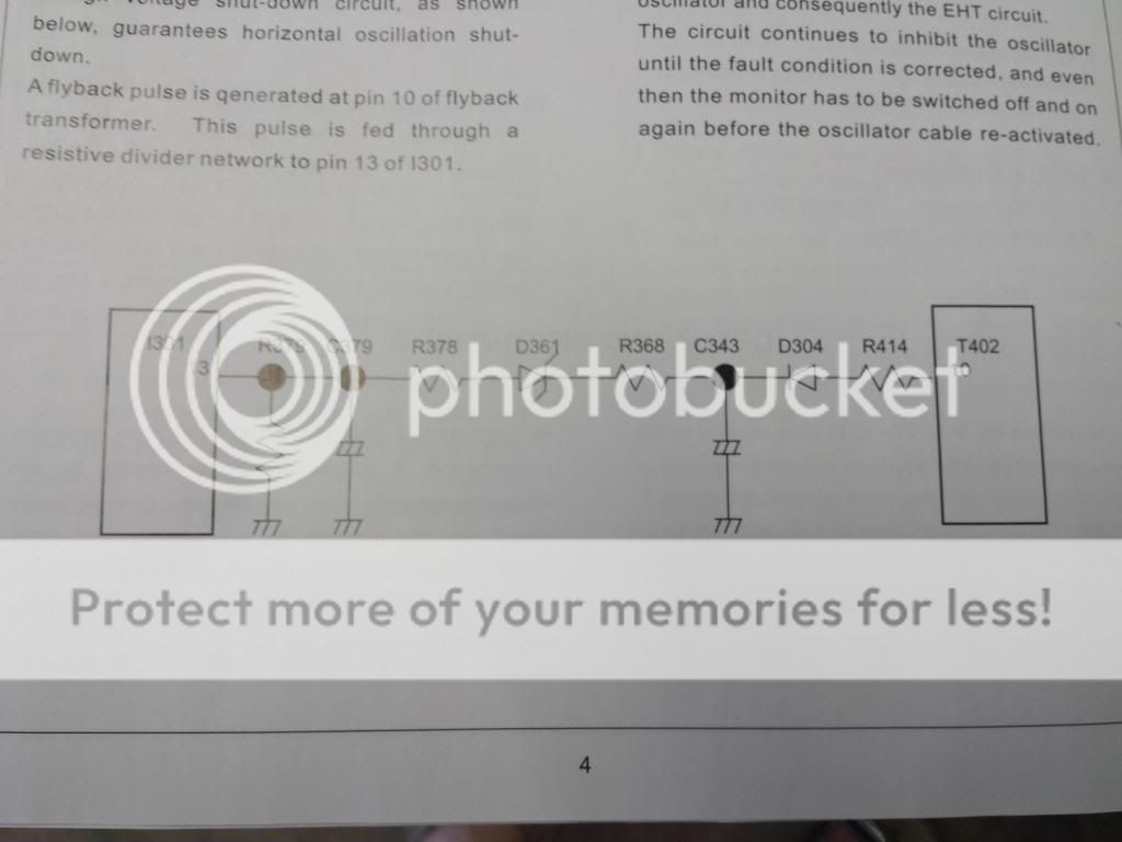

This is the HV diagram from the manual. You need to lift zener diode D361.

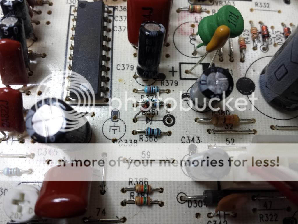

Here is my malfunctioning board...

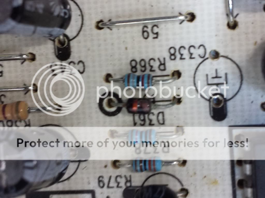

Here is the diode on the component side of the board...

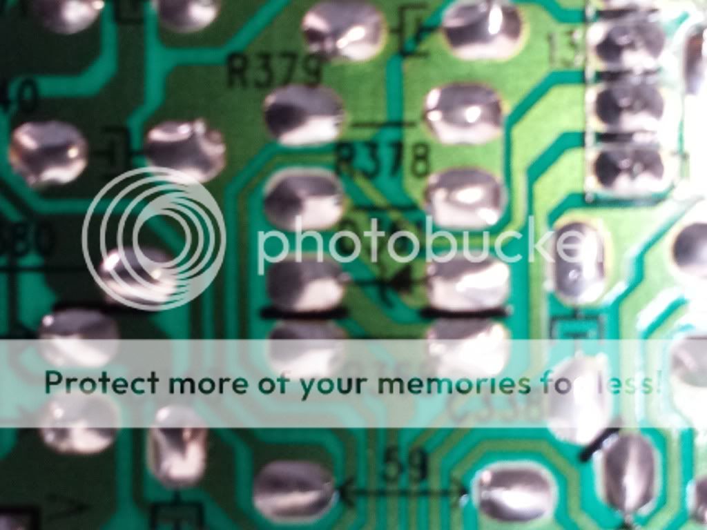

here is the solder side....
Here is a pic of that diode lifted....just desolder one side and lift it up from the board.
My monitor is back up and running. During the cap kit installation i noticed that many caps near the main RGB input were very wet on top. When i powered on the first time after the cap kit, i had no red. I noticed the connector was actually dirty with spilled soda! After some cleaning she powers off and on just fine. Millipede is back up and running.
