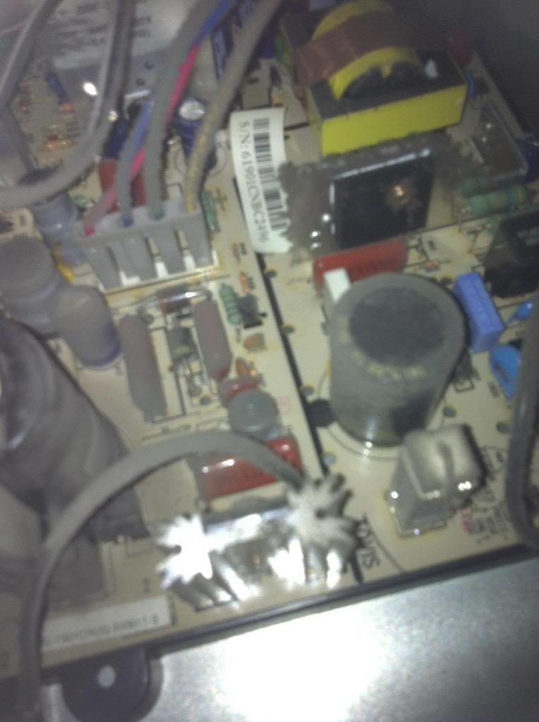

I'm not 100% sure on the chassis model; I just noticed my pictures don't have the model number in them and I'm a forgetful bastard.
When I apply power, the monitor sounds like it's gonna start for a fraction of a second, then abruptly stops, and no neck glow. It'll do this again if I remove power and try again, so it's not the fuse. HV shutdown, right? My first instinct was to adjust B+ down, but I couldn't find an appropriate pot in the service manual. Anyone have more info on this guy? Thoughts/ideas?
-E- It's an MTG-1901CN, sorry about that.
-E2- I'm starting to think it's actually a 2901; pictures:
Happ confirmed what I suspected -- the chassis is out of warranty. So, I'm gonna be taking a crack at it. Based on other threads about this chassis, first stops are HOT and flyback; I'm gonna play with resistance readings, some datasheets, and searching the forum, but... any tips for testing these?
Try using the MTG-1901
The numbers on the chips can be checked on schematic.
If the Ics matchup it maybe good enough to TS chassis
The Bi Polar Switching Regulator, I802 STRS6707 the one in the top picture
on the heatsink..maybe working if its warm?
The transistor on the other side of heatsink Q802 would be a suspect..
If no secondary voltages..
Measure the cathodes of D810,D809,D808, for voltages and circuit resistance
The D810 cathode should also ohm out to the collector of the HOT 2SC4769
And the 24vs to the vertical Chip if they short it will disable the SMPS.
Ic802 is a fixed 120 volt regulator to keep the b+ within range
there is no B+ adjustment,at plugin the SMPS would be up
and running and the Feedback Ic801 sence's the load and will switch off
the Switching regulator if to much.

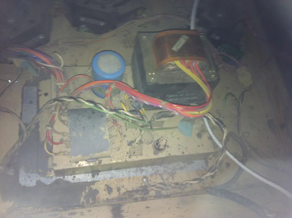

I'm going to jump into this thread here. Not trying to hijack, but I have the same exact monitor doing the same exact thing. I have a b+ of 123 volts. I'm going to lift the zener and see if I get HV back. Btw, mine was intermittent. Now it no longer works at all. I did order cap kits from Zanen but I really don't think that is going to be the issue. I checked multiple caps with an esr meter and found no bad ones.
Firstly, please forgive my sloppiness. Given that it's a millipede, my monitor is the 19 inch version. MTG-1901
How do I check for B+ and and how do I know from the schematic or manual what the spec value for B+ is?
Here is a pic of the power supply. The 4A fuse that was blown was the one at the bottom of this pic, between the two yellow wires.

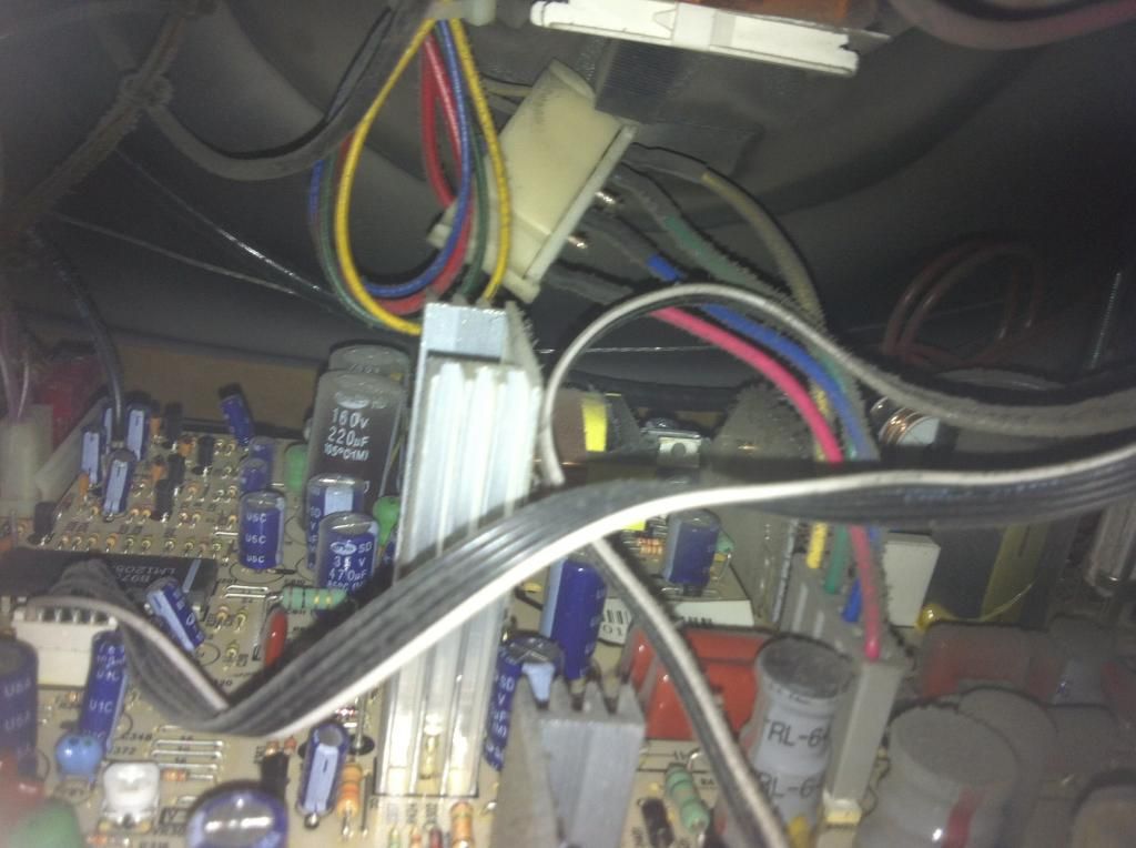

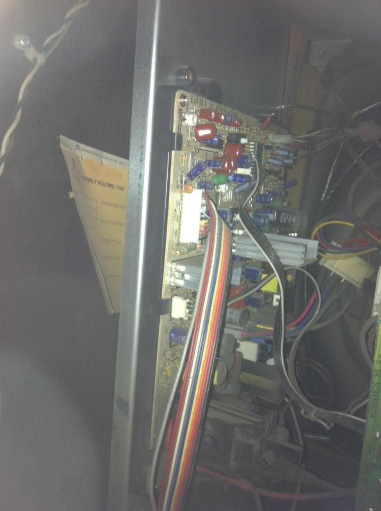

Here are some chassis shots:
Heres the Schematic MTG-1901
http://na.suzohapp.com/pdf/service_pdfs/support/visionpro/49-1329-vp2_schematic.pdf
If you don't have any secondary voltages at, C818 or C811 or R818 then
I would check Q801 and d802,fuse and the others in that same area.
The str I802 would be a suspect as well does the heat sink get warm after its
on for a few minutes if no then it maybe dead replace it.
From my experience Q801 and around it were an issue when you don't have B+
The B+ diode can be an issue it does fail, not always shorted.
sometimes you may hear a whine and then it stops and then works it because d810 RU3
The resistors around Q801 look overheated for me so check them as well
When you have secondary shorts you may hear ticking, confirm
theres no shorts on all three test points.
If there is a short, using your ohm meter, remove the part and see if the short is gone.
Like the HOT on the 123v B+ line
and the vertical ic, and remote board on the 24v line
now the 12v supply at R818
So caps first then check for shorts on all the supply voltages.
Before you order caps and you can add more parts to your list if needed.
Resolder the standup large watt resistors in the power supply too.
Let us know what you find..
