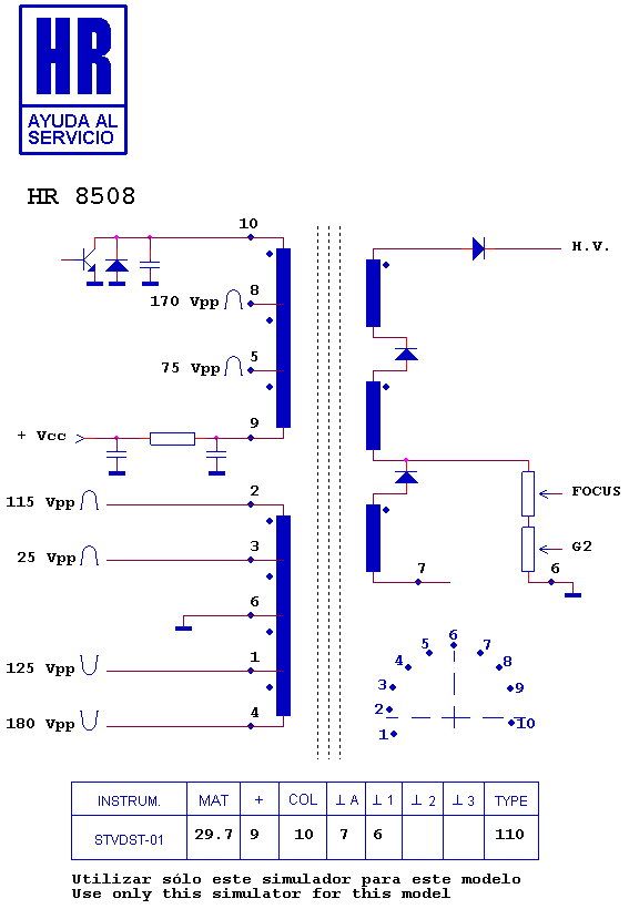

They have a rudimentary schematic available. Perhaps I should learn how to measure unknown flybacks and see if one of the many scrap transformers I've removed from TV sets will work.
