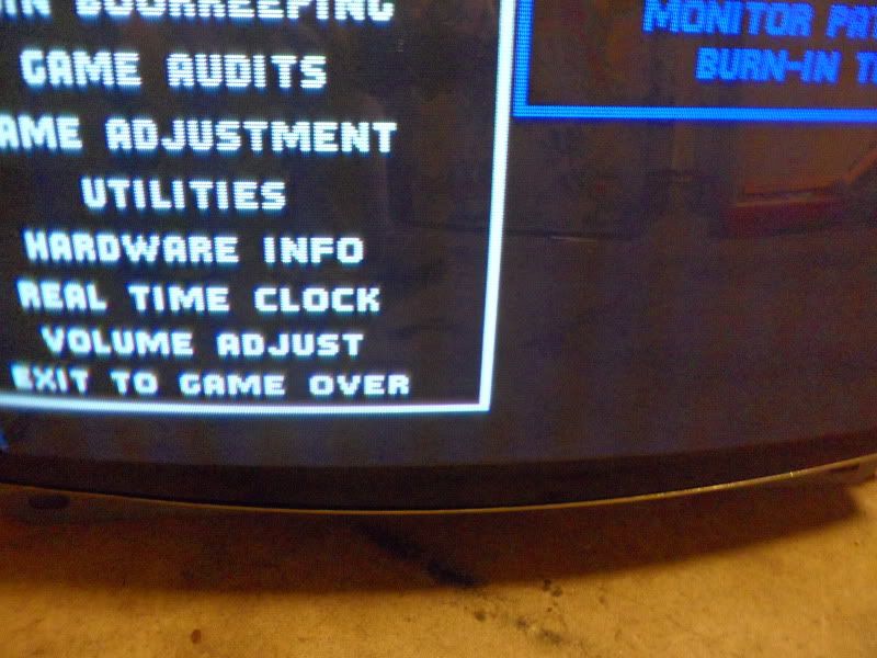

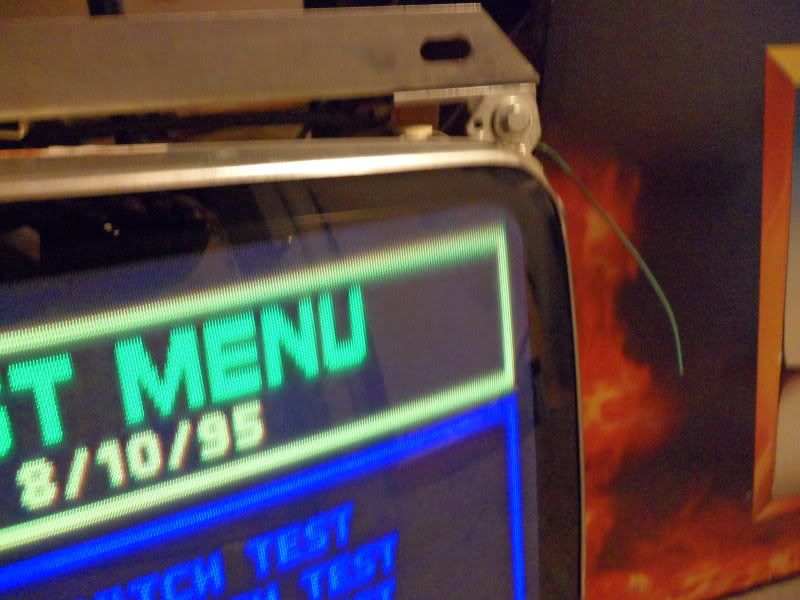

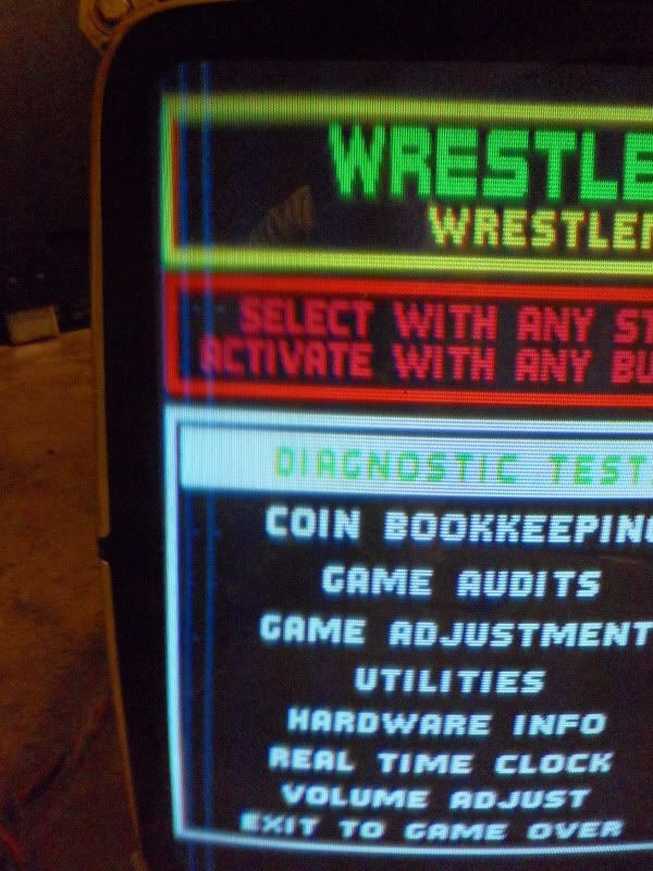

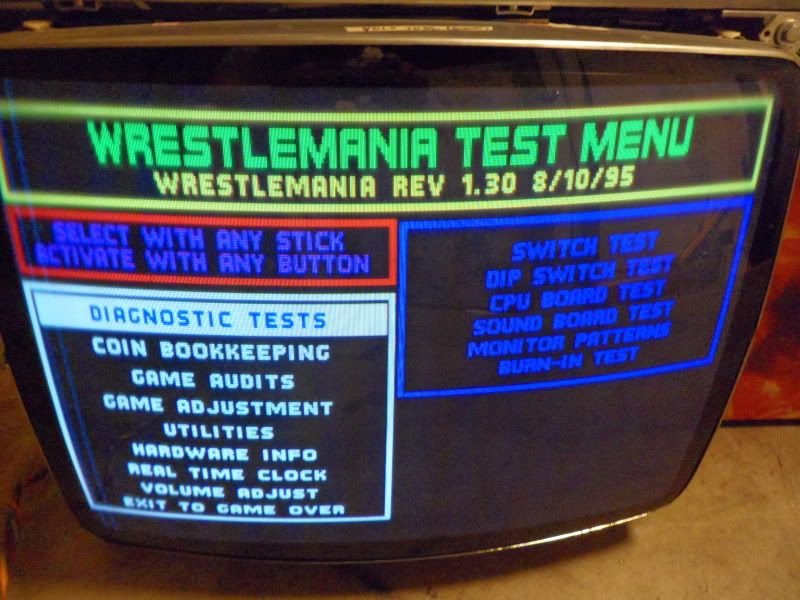

Hey guys. Just picked up a dedicated Wrestlemania. It came with a working Hantarex/Polo chassis, but it had jailbars and a blurry corner. I swapped the chassis to a better tube thinking that might fix the problem. I now have an AWESOME picture thanks to the new tube, but I still have the jailbars and the blurry right hand corner.
The chassis has a new flyback and has already been capped, so my question is, does a cap kit normally fix the jailbar/blurry issue because I have it on two different tubes, one of which I know is good.
Second, I suppose it's possible that the original person who did the kit might have missed a cap, so my next question would be does/do the cap(s) that fix the jailbar/blurry issue come with the kit? Should I just do another cap kit? Here are some pics. You opinions are highly valued.
I think you'll find that decreasing the h.size will make an improvement. In my experience a lot of chassis do not like producing full screen pictures.
Ok. Re-did the cap kit. New fly was already installed. No difference. Still have jailbars and blurry corners. I have tried this chassis on two different tubes, so it's not a tube issue. No clue where to go from here. It's not really a big deal. This is just a spare monitor for the moment, but I'd like to get it fixed in case I need to use it down the road.
Thoughts?
