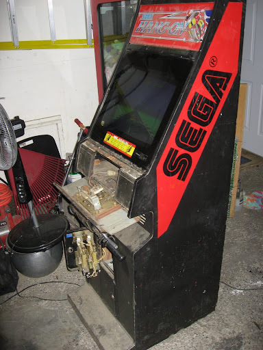

My new hang-on cabaret
has a issue with corrupt sprites. The logo is busted up vertical lines, the bike is messed, and the signs are also screwed up.

Anyway, I should have done this properly b4 posting, but I just reseated the ribbon connectors between the CPU and ROM boards and voila! instant fix :D

Now I just need to fix the steering .... out of cal? bad pot? ???
