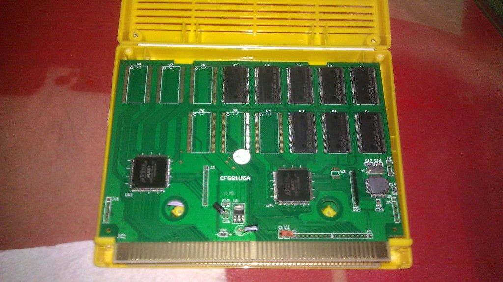

So I opened up my 120-in-1 and snapped some photos.
The whole thing is just 3 Altera CPLDs, and bunch of Fujitsu Memory (all the same), and a 8 bit microcontroller with flash.
Microcontroller:
ATMEGA8L-8PI Datasheet - ATMEL Corporation - 8-bit AVR with 8K Bytes In-System Programmable Flash
http://www.alldatasheet.com/datasheet-pdf/pdf/80252/ATMEL/ATMEGA8L-8PI.html
CPLDs:
Altera EPM3256ATC144-10
http://www.arrow.com/item/detail/altera/epm3256atc144-10
Memory:
Fujitsu MSP55LV100S
There is a lot of people selling these, but I cannot find a datasheet anywhere.
My thoughts are that the menu is all controlled bt the microcontroller and if we can read the flash in it and hack it we can at the very least edit the menu.
If you look at the photos there are places to add more memory that are not used. I bet it would be possible to add more memory and more games!
Top board:
Bottom board:
CPLD:
Microcontroller:
Mysterious Cable 1 and 2 header!?!
I just noticed that my cart is a 120 in 1, but the board is screened with 138 in 1! That explains the 3 missing memory chips! ;-)
Does anyone want to open up their 138 and snap some photos??
What is really funny is to look at the labels on the memory, this memory was salvaged from all sorts of places, some has Chinese writing, others Japanese, and English too.

Interesting. I'd start by dumping all those flash chips to see what's on 'em.
All those chips have epoxy on them, the microcontroller does not.
Also they are all smd mount.
Also what pisses me off is that when I got this there was no 138 board. That means that they planned on making the wee 138 with a few more games ahead of the time...

Seems that should be the easiest thing to do, pretty sure that dumping the microcontroller and hacking the dump should be how to do it.
How about some photos of the boards in you 160?
I figure the microcontroller controls the whole thing and the CLPDs are just used for bank switching. The microcontroller probably has all the address ranges for each game ROM and instructs the CPLDs to map those addresses to addresses the neo can read.

I have two 138-in-1 boards, one working 100%, the other crashes when you try to go into a game. I can try to get some pictures of the boards this weekend of the 138 in one. My guess is one of the two headers you are wondering about is for the daughterboard of the 138-in-1, which is what allows you to control and modify the game list in the menu.

another thought occurred to me... if you start dumping, there's a really good chance you might actually be able to develop your own carts, if you can source the proper materials... i have zero exp with those altera max cplds, i'll check out some data sheets... the rest of it looks super basic... just a thought... a far off thought, this exercise will be a good proof of concept if you are able to modify the user interface and be able to load a custom rom set into memory...
baby steps though, i'd really like to see that atmega8 dumped
