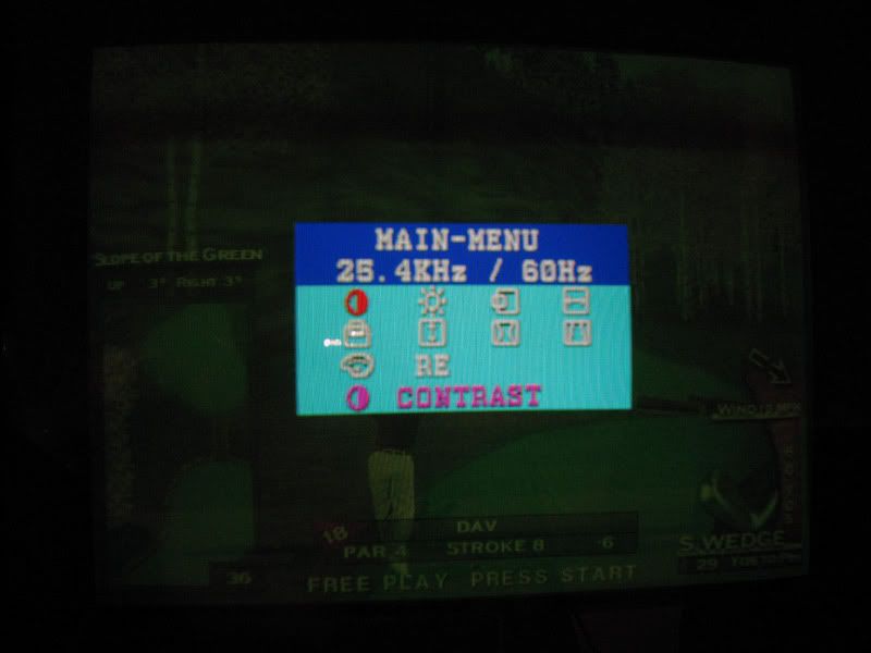

Alright... I was finally able to get back to this monitor. I recapped it using the components Bob Roberts sent me. The kit did not include the uf490 35v I caps I think it was... the two at the back left of the chassis... it included 12 other caps.

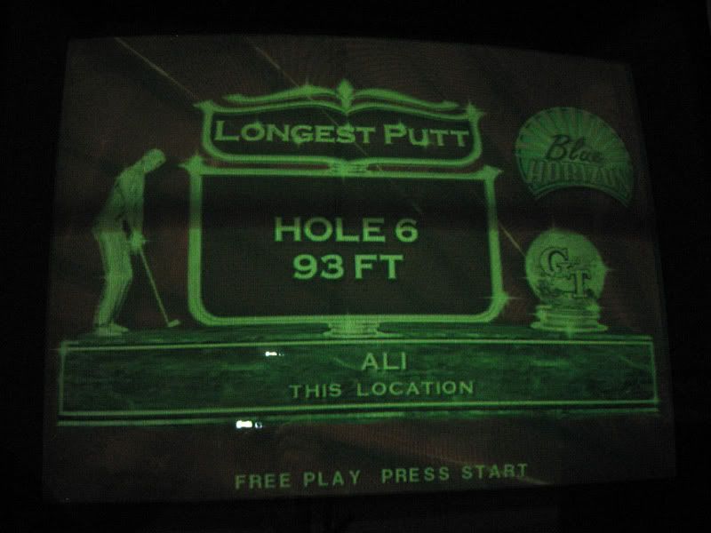

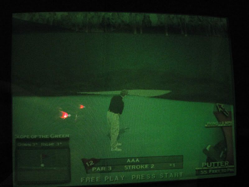

After recapping I now have a nice stable screen... but it still has color issues / a green haze over everything. Using the easy to access red line I tested each pin at the monitor... they all showed SOMETHING. I noticed that Red showed very little... Green showed the most... but Blue showed a lot as well... and they were all green...
These shots were all taken with the brightness turned to the max, all colors maxed out except green which was turned down to nothing....contrast at max too...
Now...normally I'd think this was a bad tube... only the green gun was firing... until you see the on-screen menu...
Any suggestions?

Since your onscreen menu box looks okay, I'd assume the monitor is okay. After you did your reset, did you turn the brightness and contrast up in both the factory and regular menu? And did you adjust up or down your color gains?

Color gain has all been turned up. Factory and regular menu has been set. Brightness and contrast has been increased. I've eliminated the PCB and harness as the culprit because the green issue happens even when no RGB signal is fed to the monitor... just the sync... (if I remove sync it goes black because the monitor shuts itself off with no sync signal).
I don't have a 60-in-1 lying around unfortunately. I did plug a Taito Multigame board in and ran it CGA with the same green results. The GTFore runs at EGA with the same result...

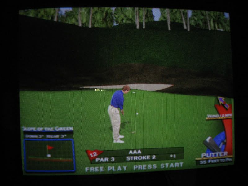

GOOD NEWS! Mod... I went in to the factor menu and reset. It did jack squat. But then I noticed the GAIN option that allows me to also adjust bias etc... I ASSUMED it was the same as the regular menu's GAIN options...oh how wrong I was. The GREEN was maxed out... Blue was down to 30... etc. Needless to say after some tweaking the screen looks GREAT now. Well... almost great (I need to tweak a little more)...
Now, the only remaining minor issue showing up is there is a slight "wave" going from top to bottom... it's nothing major, but its' there... Any idea where to look?

I had some time to go out and adjust the monitor. After adjusting the settings in the factory menu and then re-adjusting the settings on the regular menu...and then adjusting the focus on the flyback I now have an absolutely stunning looking monitor. The wave appears to have gone away (my guess was the factory gain/bias was too high)...
