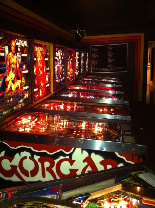

Thanks for the comments. To answer some questions, the stripes are painted and the circles are wallpaper. I bought one roll of wallpaper from 70's wallpaper and cut the circles out. I was thinking of having the stripes come down the wall again around the pinballs in the corner like over by the scoreboards. Since the stripes where done a few years ago I didn't want to deal with repainting. I also wanted the stripes to be fatter but I had a light switch to deal with by the scoreboard.

What are the metallic looking round thingys in the corners at the ceiling? They remind me of security camera housings.
Regardless, very, very cool -- all around.
