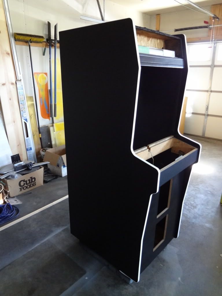

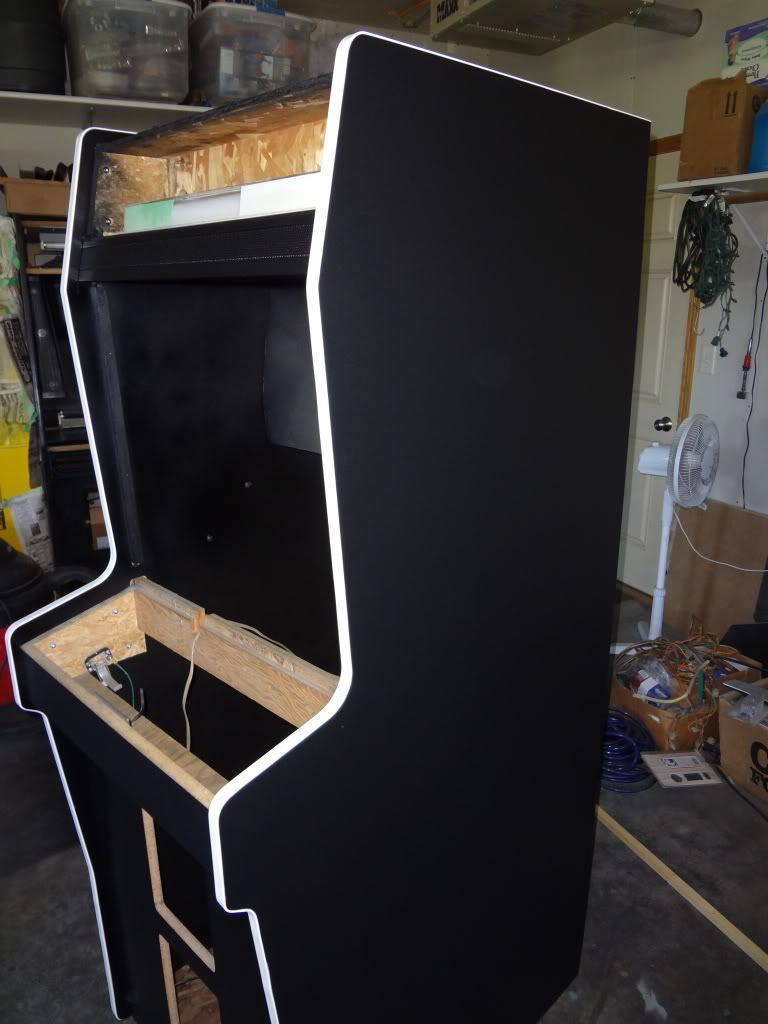

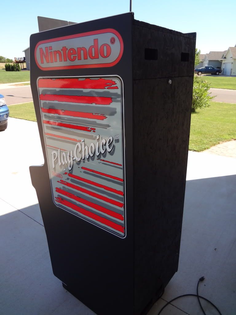

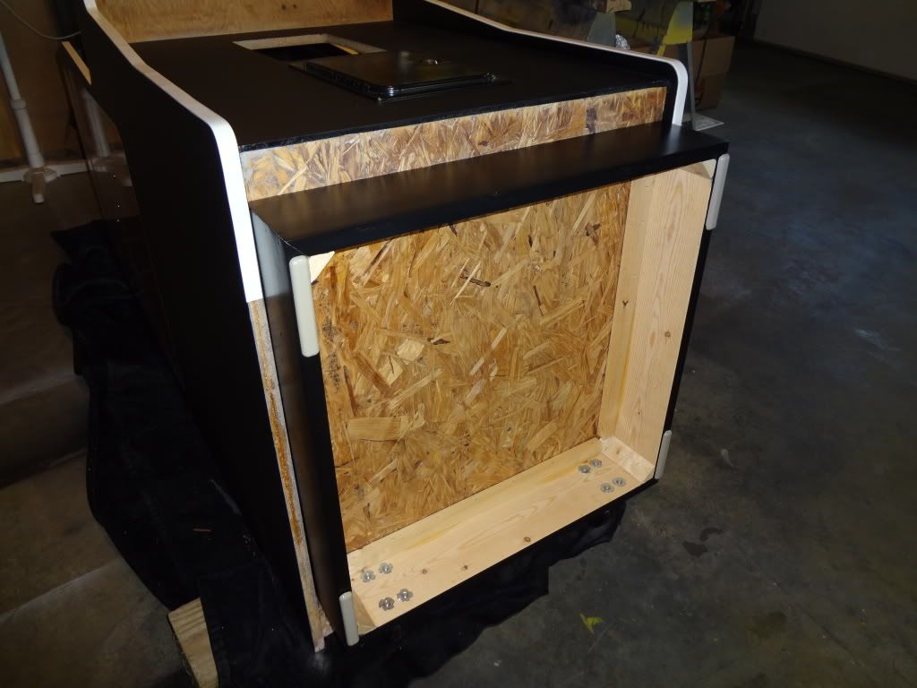

Thanks Johnny. I am very happy with how this one turned out. The only thing left to do is some tweaking to the interior wiring. It doesn't seem routed correctly yet and kinda seems messy. Doesn't flow like it should. I may also upgrade the wheels on the back of the base as well. These are new, but seem too small. When I tilt the cab back to roll it, it seems like I REALLY have to tilt it back. I went with 2.5" wheels initially but think I am gonna jump up to 3 inch wheels. One thing I will say about this cab. It's tough to make OSB look pretty:

Well this was originally a dedicated Vs. cab and came with a Sanyo (the newer model with the degaussing button) from the factory. After hosing it down and capping it, it has a beautiful picture, even with Dr. Mario burn in the tube. I'd much rather have a Sanyo in a Nintendo game than a 7000 anyway. Sanyos (and Sharp XMs) are the shit.

Nope, Pica from HAPP. This vinyl is much thicker and far more forgiving than Rich's thin stuff. I've used both, in fact, sometimes in the same day. I've been working on my Rampage simultaneously with this PC-10 and I covered that one in Rich's vinyl. Let's just say that even though they are both black adhesive vinyls, they are vastly different.

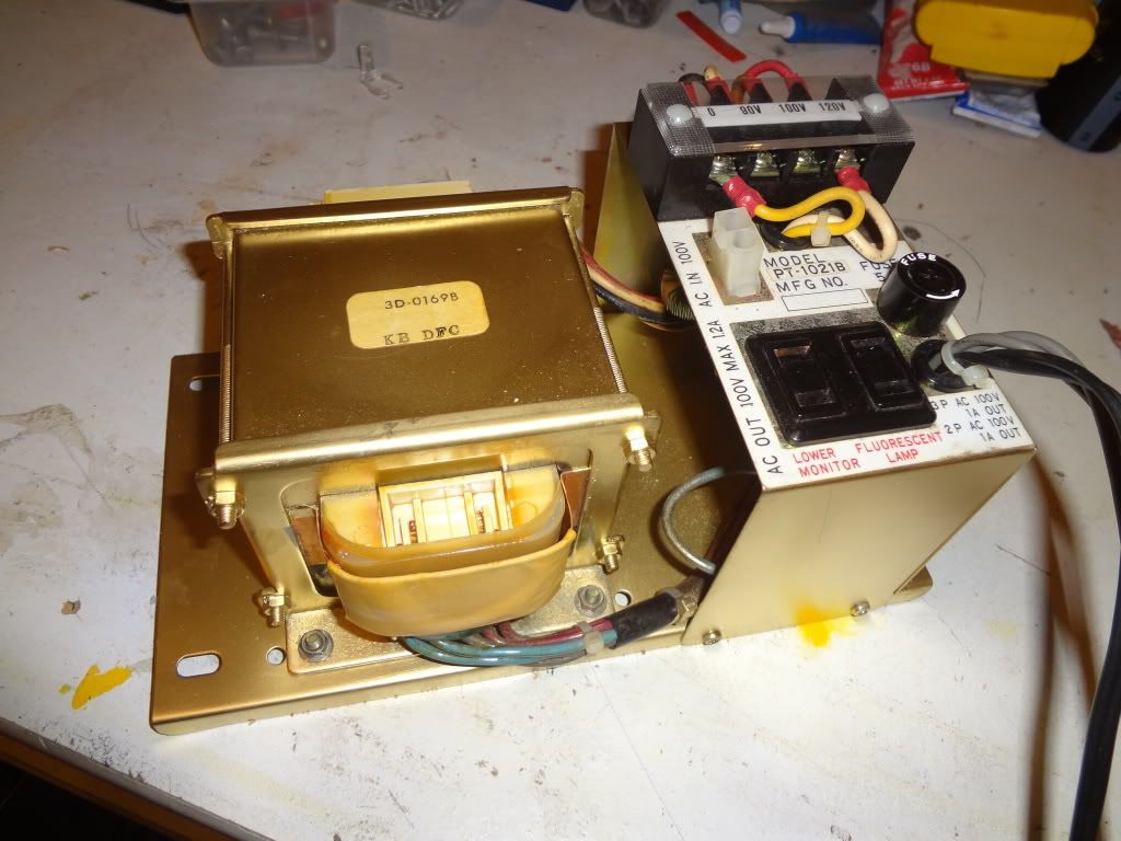

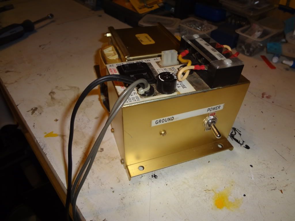

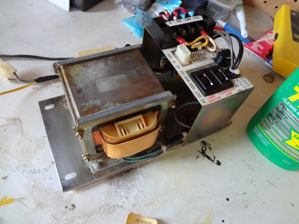

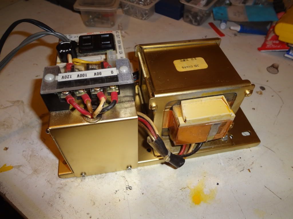

Phet, what are you using to do the gold on your Ps's? ?
Gold spray paint. It's a lot more golden looking than it should be, but it works out OK. I only do this when there is rust and severe tarnishing, otherwise I polish them up and leave them alone. This one was used as a rat urinal for several years.
