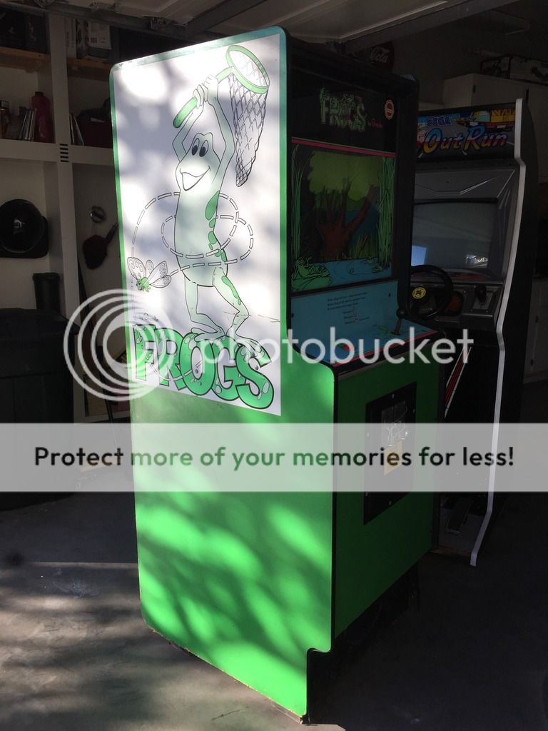

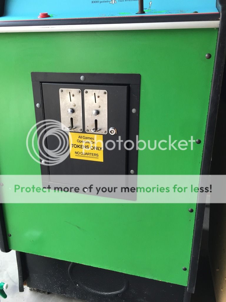

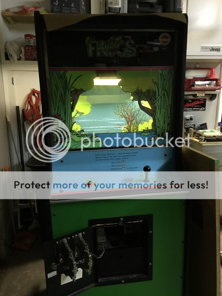

I bought this game recently after playing it at Grinkers. It was bought non working. I've decided to start going through it and cleaning it up.
Overall it's a fairly clean machine for it's age. Appears to be all original. About 17k plays on the counter unless it's rolled.
Here are the pics of when I received the game:

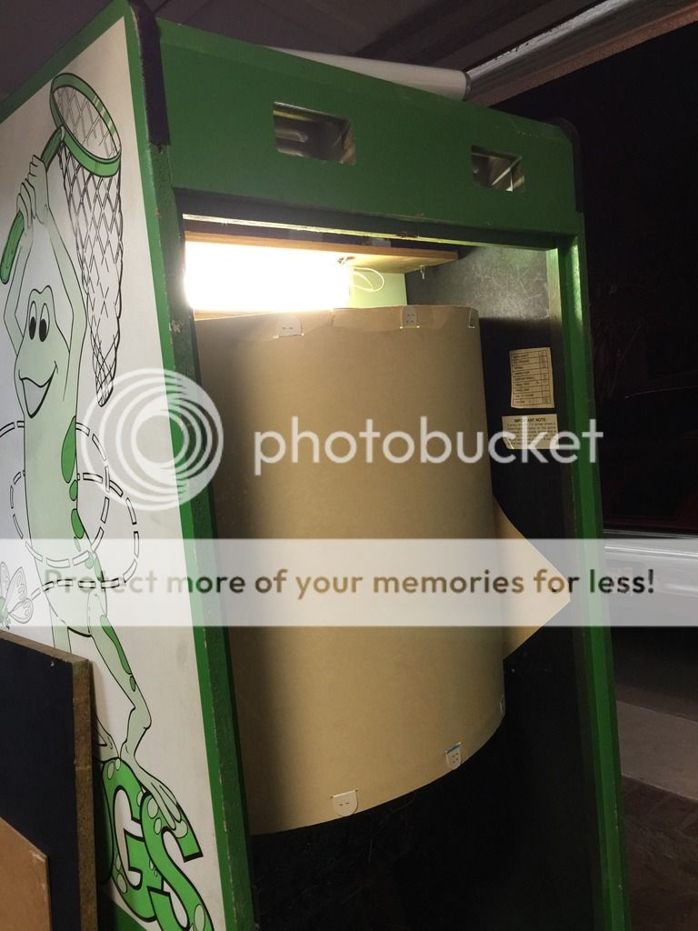

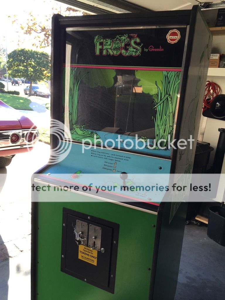

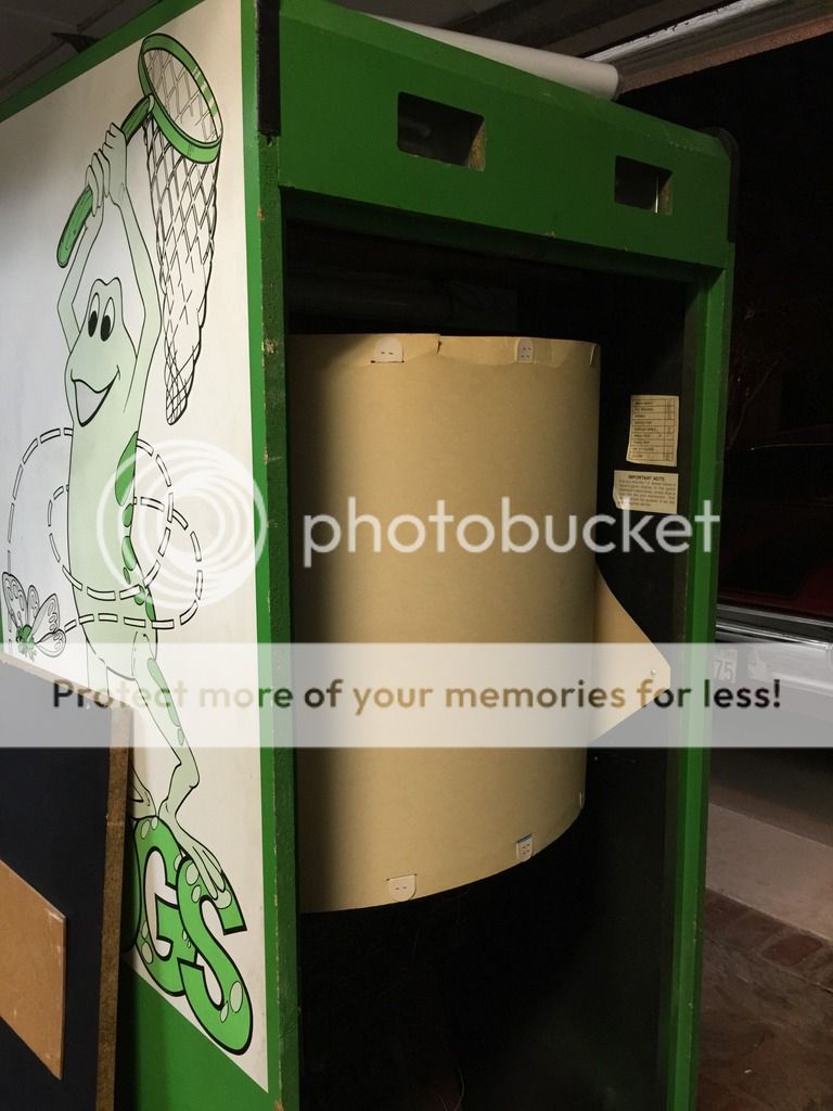

Got a chance to open it up last night. Plugged it in and got no lights (interior or marquee).

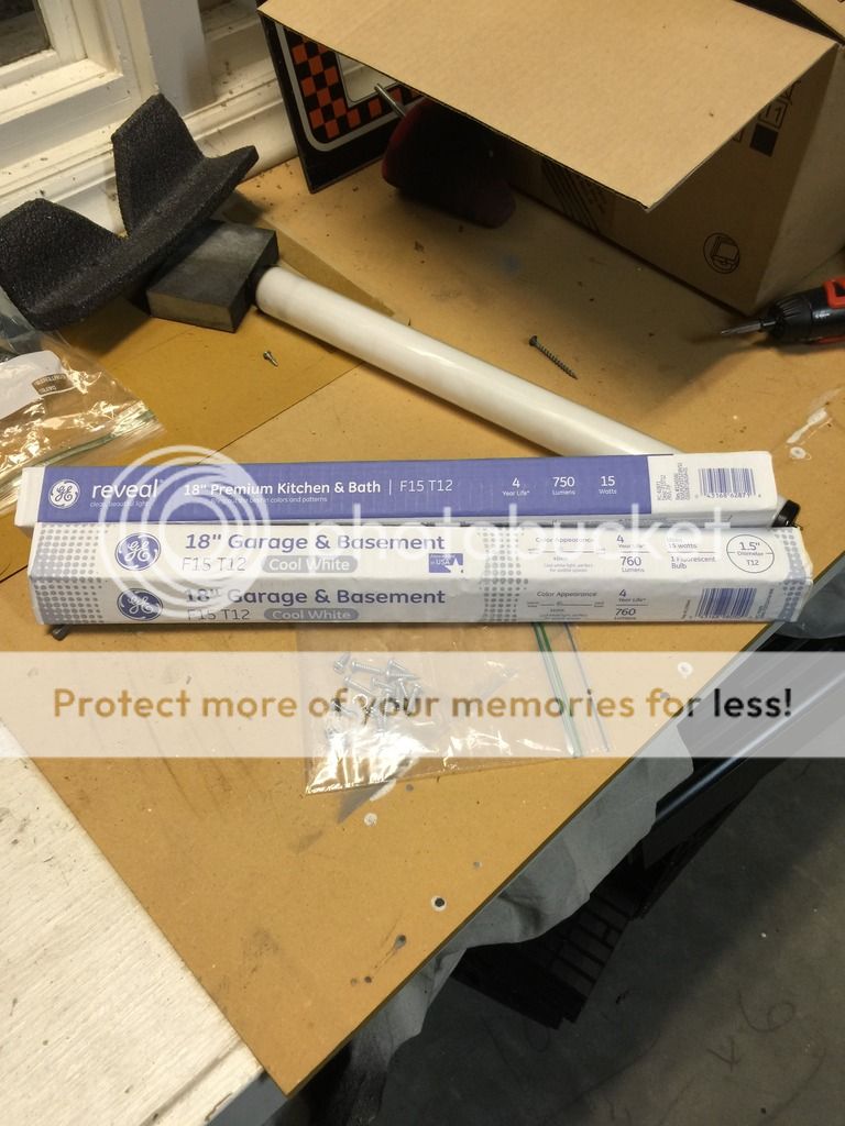

Decided to change bulbs for both.

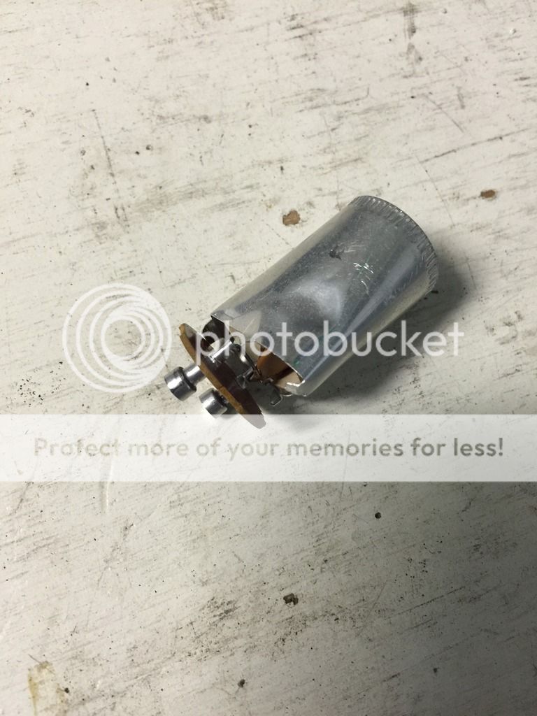

Still didn't work - found the culprit:
After a new starter - Let there be light!

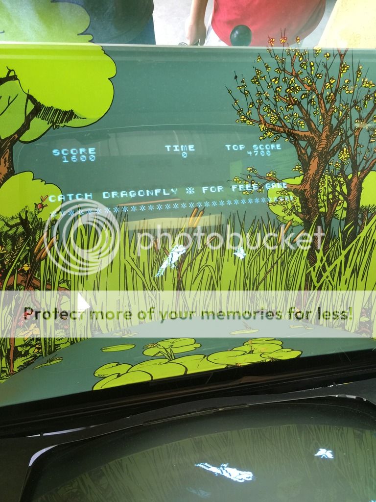

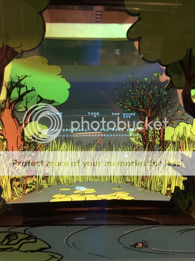

Still need to change the front bulb here - finally figured out how to get the bezel off to work on it. Here's a quick pic of what's showing up on screen:

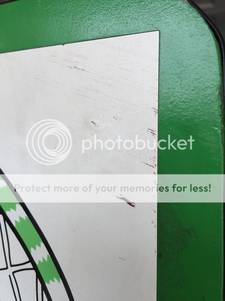

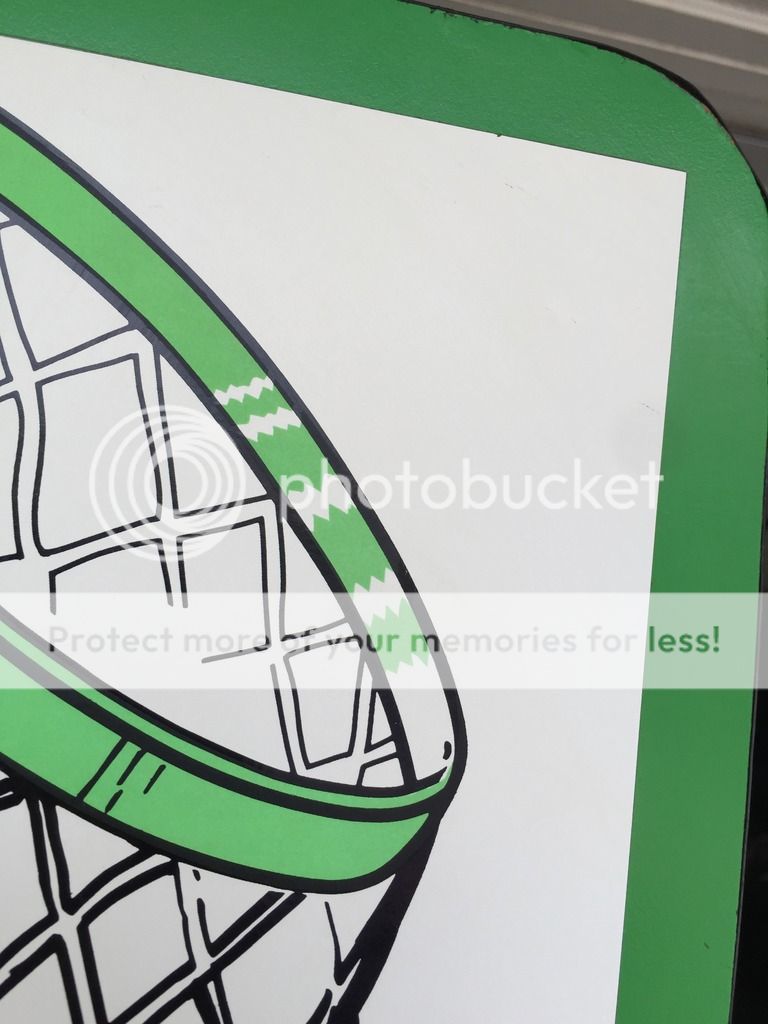

Man, this thing needs some serious elbow grease.
Used a Scotch Brite sponge pad and Simple Green.
Before:
After:

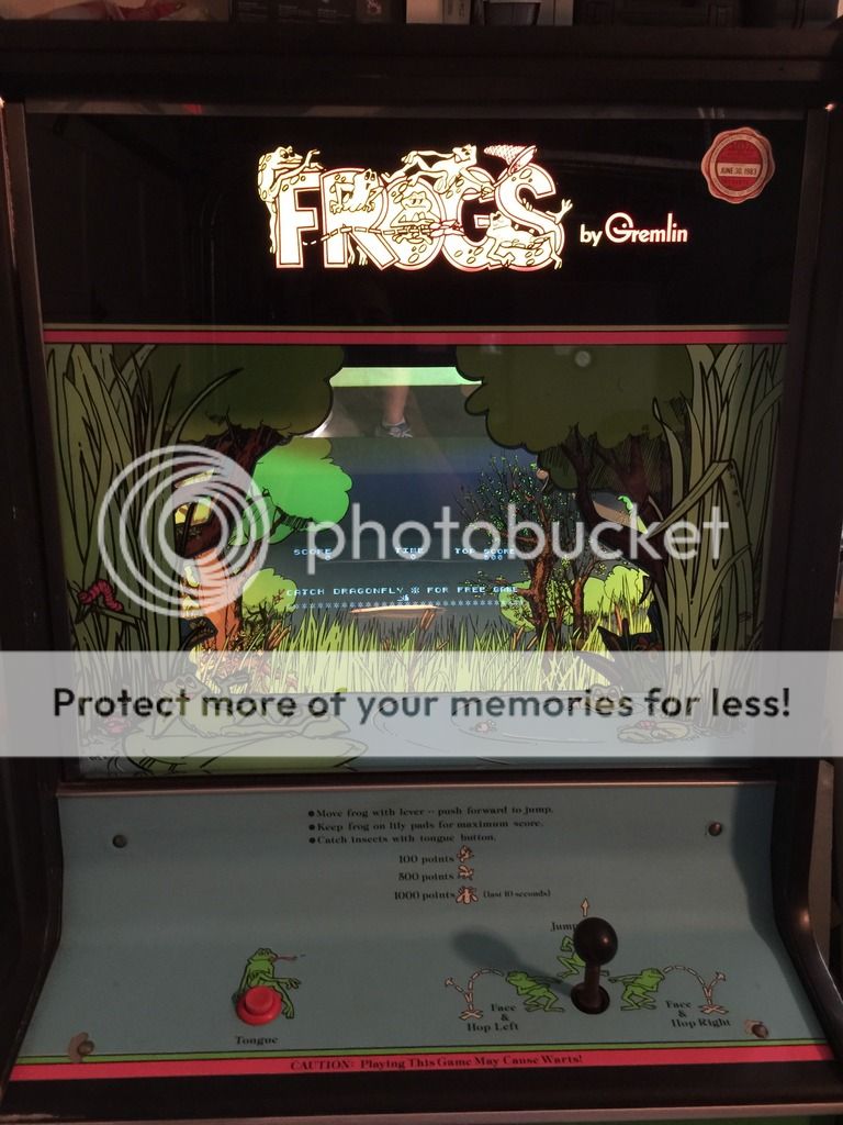

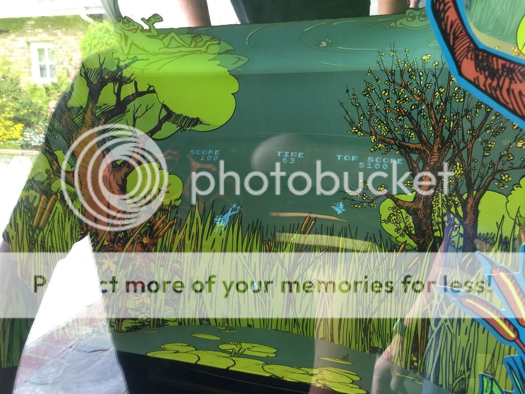

I could hear attract mode sounds - started fiddling with the monitor controls and got the picture to come up! Seems to be something loose somewhere - when fired up game will make a white noise sound, or image will be frozen/jumbled on screen - then every once in a while it will boot up fine! After turning it on/off around 10 times, it comes up fine. Will have to figure out the issue, but for now I'm thrilled to be able to play a game - especially one that was bought non working!

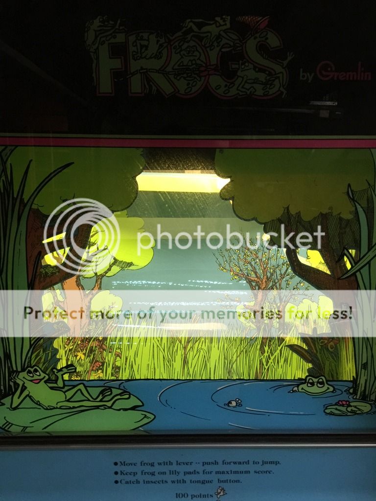

Figured out the rear bulb was supposed to be a black light - so switched it up.
