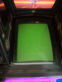

Giacomo Member VAPS Joined Jul 8, 2012 Messages 148 Reaction score 0 Location Scottsdale, Arizona Jul 24, 2012 #1 I am super new to this and was hoping that there might be some good troubleshooting tips out there. Also, there seems to be no sound.

OP OP Giacomo Member VAPS Joined Jul 8, 2012 Messages 148 Reaction score 0 Location Scottsdale, Arizona Jul 24, 2012 #2 Monitor seems to be fine. All the colors have been tested. I guess next step is power supply
divingbuddy Well-known member Donor 10 years: 2013-2022 VAPS Joined Nov 19, 2010 Messages 2,650 Reaction score 669 Location Utah Jul 26, 2012 #3 I had similar problems, could be roms need to be checked, ribbons cables are old and cracked, also read about the "Purple Wire" fix.....just some suggestions....good luck.... Attachments IMG_1089a.jpg 92.5 KB · Views: 7
VoicesInTheWind Member Donor 2012 VAPS Joined Jun 3, 2012 Messages 313 Reaction score 4 Location HOLLY HILL, Florida Jul 26, 2012 #4 Giacomo said: I am super new to this and was hoping that there might be some good troubleshooting tips out there. Also, there seems to be no sound. Click to expand... RESEAT ALL OF YOUR GAME ROMS and any Chips on the Video PCB...then Retest... prolly roms first..if that don't work check all cables Good Luck! END OF LINE. Daniel.
