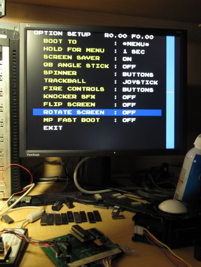

I've been working on the same thing, to keep the FPGA small and ensure perfect functionality it uses the original CPU and cycle timing/wait was matched to the original hardware.
It can play all the gen-1 mylstar games, along with screwloose & 3 stooges.
I've not really worked on it since March (!) ack.
Board: http://jrok.com/xfer/msf/msf_mar27_a.jpg
Menu: http://jrok.com/xfer/msf/msf_mar27_b.jpg
Setup: http://jrok.com/xfer/msf/setup.jpg
Reactor in Vertical mode, http://jrok.com/xfer/msf/react_v.jpg
Qbert in Horizonatl mode http://jrok.com/xfer/msf/qb_h.jpg
Eventually I'll release it like the Williams boards when I get a chance to build a few.
- James
edit: freaking links.... :(
