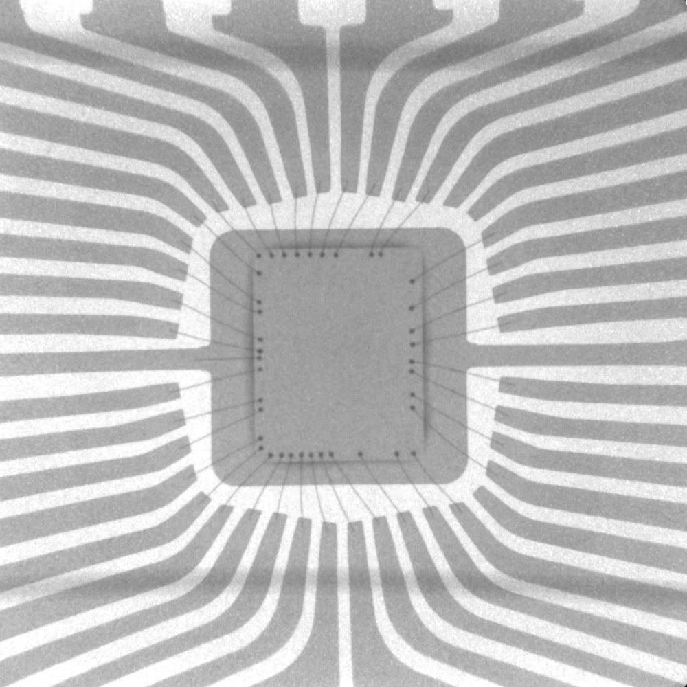

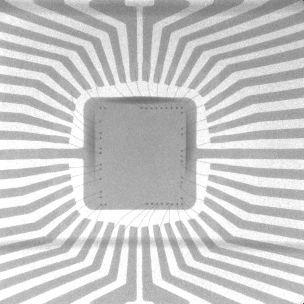

Well not counterfeits. :p Just for grins I took the chips over to assembly and had them x-rayed. It was funny, there was a younger gentleman there noodling about with something mundane. I approached the subject cautiously, can we x-ray some parts? His eyes got wide, "yeah! It's over here let's go!" LOL Like a 16-year-old kid with a new drivers license. Any opportunity to use the x-ray machine! :D It was cool - this was the first time I've seen one in action. Basically it's a big lead box with a blast door and fancy camera inside mounted above an XY table. He put the chips inside the door, closed it (woosh), and turned on the x-ray:
Bad part:
Good part:
So yes the die is there on all of them. :p Some are just plain broke.

As to the images of the dies, it's hard to tell w/ them (i'm assuming based on the long line of contacts and 2 points going down the next axis on part of it) flipped relative to each other so they're not showing from the same orientation/angle. The odd thing is that it almost seems like there's more contacts on the known working die but there's not as many connected to the traces. The pads (or whatever they are) on the good one look a hell of a lot larger in places, may just be sketchy manufacture and they're not making a good connection. Certainly differences, though I'm not versed enough in chip architecture to know where the issue is looking at it, hopefully someone will pipe up with an explanation.
*e* If you could flip one 180 degrees and edit it back in, that'd work w/o needing a bunch more pictures. If you don't have a graphic editor handy let me know and I'll take care of it real quick.
I've got more images of bad ones if it would help. I just didn't want to inundate the thread with large images. They are all almost certainly flipped 180 degrees. I also just noticed one of the bonding wires crossing an adjacent wire on the frame. Probably not making an errant connection, or maybe so? :)
The Xray's are TOO COOL ! I think with that picture it might be giving a distorted view of the bond wire, it may actually be clear of the pad as from the images I've seen the bond wires were in an arc from the chip to the lead. So when looked at vertically you can't see the clearance. I'm sure we'll now discover there's a pad-bonding expert on the board who can comment :)
- James
I noticed the bad one doesn't have a bonding wire connecting to the "plane" (ground? maybe?) that surrounds the die.
Edward
I don't think the one on the top is actually a 6502 chip. A real 6502 has pins 35 and 36 as N/C. This is clearly visible on the bottom where there are two contacts on the leadframe that aren't connected to the die. The one on the top has all leadframe pins connected.
-Ian
All of the chips were in 6502 packages. One thing is for certain, the manufacturer clearly failed to test these for quality control. Having a 30-40% failure ratio is inexcusable for the manufacturer.

If they really were counterfeit, I would think the chip carriers would be empty. Why put a wafer in a carrier you knew wasn't going to work anyway? I think they're just bad. BTW, I did check the other 'bad' pictures and the rest had bonding to the largest wire in the frame - GND I guess. I can post the rest of the pictures if anyone is really interested.
