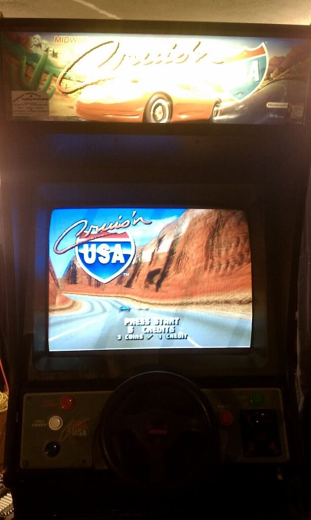

Anyway, here are some pics. Sorry if the quality sucks, the lighting was bad.
But I thought the side art was in pretty good shape. Exepct for the scrape in the middle, other side is actually better looking. Monitor looks good also.
Insides needed a good vacuum though.

The art looks good, and that scratch is not on the cab, it was part of the artwork representing a scratch on the car. That's my story and I'm sticking to it.
