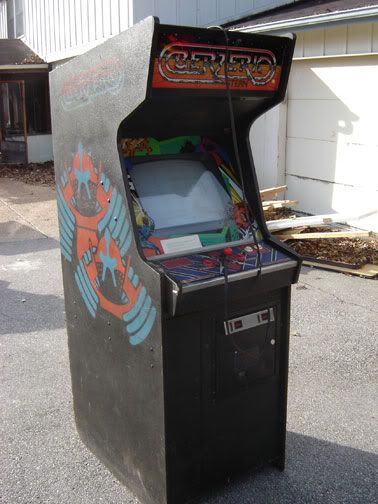

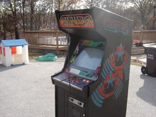

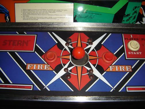

Last weekend I was able to pick up my grail. I've never traveled for a machine before, but this one just happened to be only 6 miles from a cousin of mine near St. Louis, MO where I was able to stay overnight and pick up the machine the next day. Thanks to joneddy for selling it to me. Great guy and a pleasure to deal with.

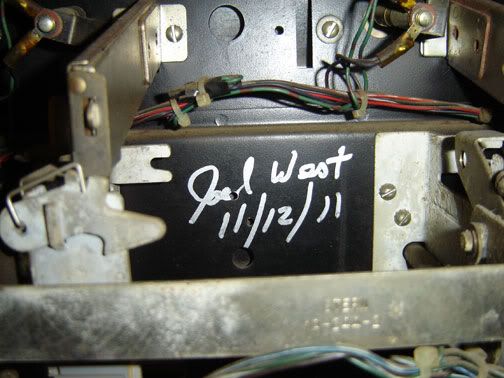

I also took a detour and brought it to Ottumwa, Iowa for people to play it during the Twin Galaxies festival. I knew Joel West (Berzerk/Frenzy champ) was going to be there, so we brought it in and he played some doubles Berzerk with me, which was a blast! I also asked him to sign the inside of the coin door, which he was nice enough to do.

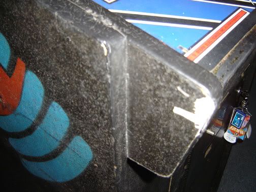

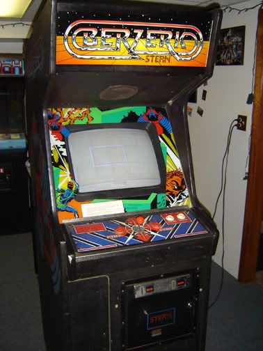

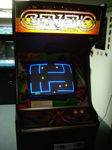

The cabinet is in fair shape, but it has the Spaeth ZZPU board in it that switches between Berzerk and Frenzy. No acid damage on the boards which made it worth it to me. Cabinet, control panel, monitor, etc. can all be altered/fixed/restored if I want to in the future. I was more worried about the condition of the board, and it's solid. Monitor has curl, but I'm getting the chassis repaired and capped this week. I've also started filling in some of the damaged wood parts already.
All in all, a good purchase with a fun story to tell.

Thanks guys! Yeah, Shusler...you know I was looking for this one. Long time coming, but owning one is finally a dream come true. Being able to play doubles on it with Joel West on the day I picked it up was an unexpected bonus, and an experience I'll never forget. I've been a Berzerk nut for as long as I can remember. Playing one as a kid and remembering all the voices, sights and sounds, playing it on the 2600, owning an unopened copy of it, having the arcade marquee for years, even the board game, etc. Having the actual machine just helps to complete it all.
It'll be getting some upgrades over time. First the monitor fixing, then some better buttons (the ones I have are original, but cracked all over the place) and then I'll be doing some work on the stick (it's a little loose).

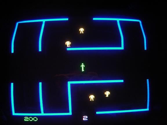

As for the image problem, I wouldn't call that 'curl', I'd call it 'keystone'.
It's due to a problem in the yoke or the output section.
You can swap the two wires going to the vertical section of the yoke to narrow down where the problem is.
The image will appear upside down when you do this.
If the keystone jumps to the bottom, the problem is with the electronics. If it stays at the top, the problem is with the yoke.

Thanks! The whole chassis was taken out yesterday; it'll get a full cap treatment and be back in within a week.
