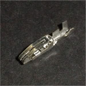

Unplug the machine. Check the fuses, both are fine. Game will not come on fully. Board will not boot. Take the edge connector off so I can lift the board out of the cabinet. *clink* "Okay, wtf was that?" This time I see something actually drop, I pick it up...it's a pin from the connector. That's what fell out earlier as well, I'm guessing.
So now here's my dilmena. I've got this beautiful Gyruss cocktail, with a beautiful monitor, and pins falling out of an edge connector. I've got a crimper, where the heck do I get the pins and how do I fix this edge connector so that I can get back to playing this pretty table that I now own?

Probably a molex split pin. If it fits your edge connector.
http://www.twistywristarcade.com/edge-connectors/776-molex-bifuricated-split-pins-for-ec.html
Bob Roberts also carries them.

You're right, I even see them in the pic. Was just too zonked last night to notice them I guess. Wouldn't have saved the edge connector, unfortunately. =\

Yep. I'm usually pretty careful with that stuff....figured the interlocks would have cut off power. Should've traced those wires before I did anything, or failing that, unplugged it. My bad. Friend pointed out that maybe the pins that fell out might not be used, there's no wire going to those holes in the connector and I don't see any strays, but I've gotta run off to work now. Troubleshooting will have to wait.
