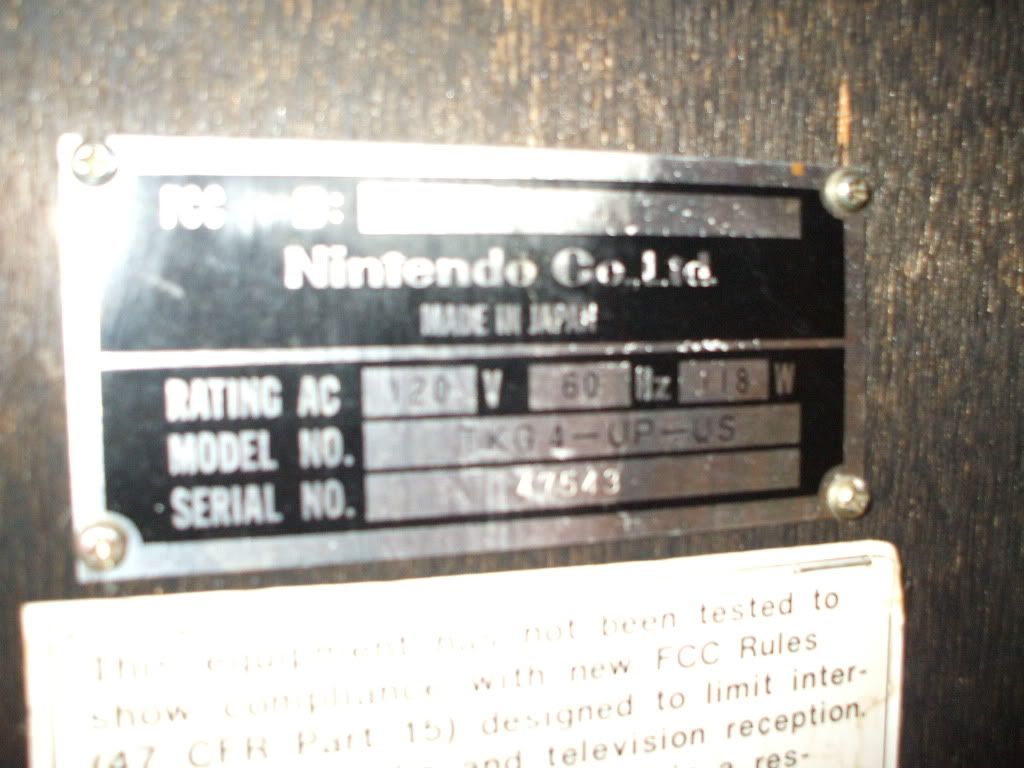

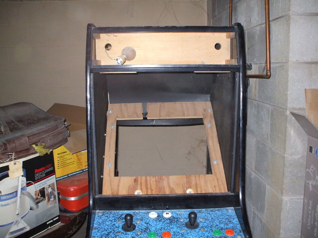

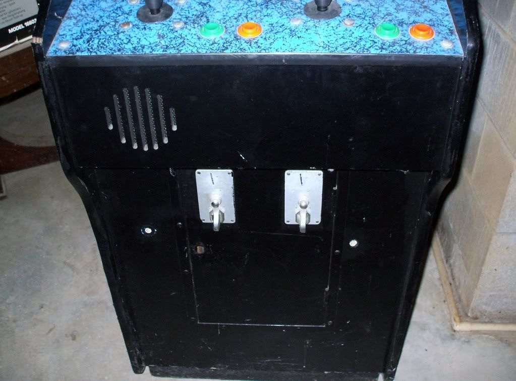

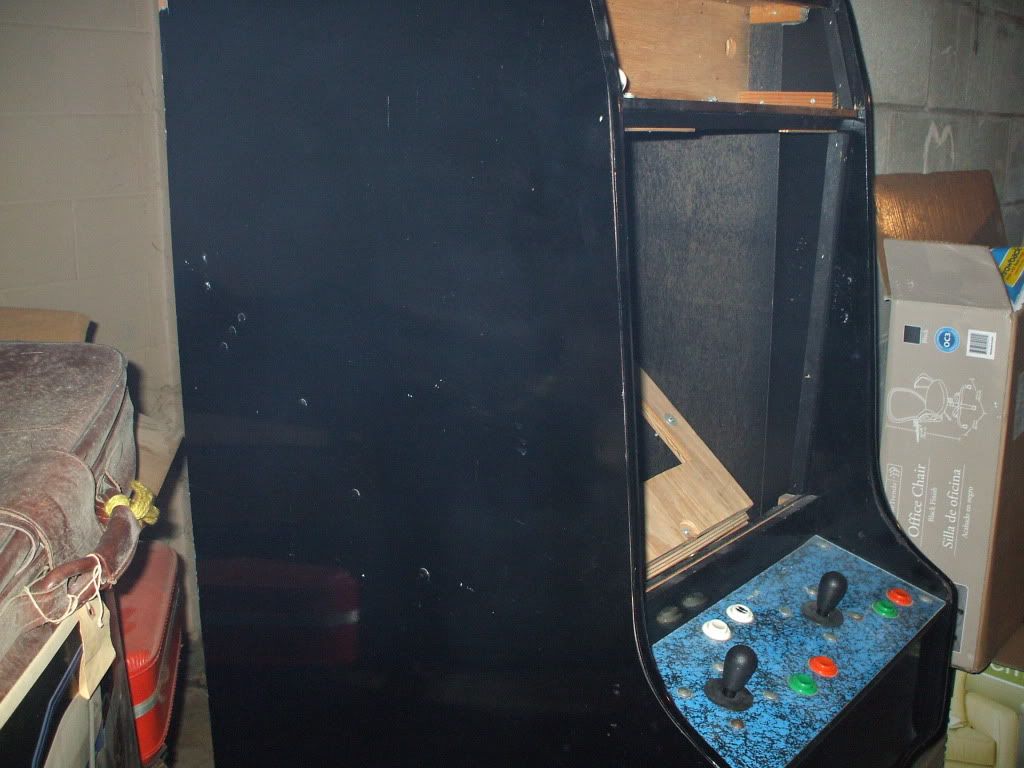

I got a DK cabinet, completely gutted a few weeks ago. At first my intentions were to MAME it because it was the first cab I had come across in years of wanting one, but after speaking to a few folks on here I have decided to restore it back to a DK (possibly a 60 in 1 instead).
When I got the cabinet it was a fugly mess. The whole thing had been spray painted black very sloppy. The CP was covered in ugly marble blue shelf paper and had been modified for 2 joysticks and 2 buttons per side. There was a gouge in the top left corner, and the laminate was peeling slightly. The wiring was switched to JAMMA and there was a mystery board in it (Made by Konami, but since there is no monitor or PSU, I can't really tell what it is.)
Looks like I got my work cut out for me. Here are some pics taken the day I got it:

I've gotten some great advice from you guys in the last few days. and I thank you all a lot for your ideas. Right now I'm thinking if i don't get any one around here who wants it I'm gonna slowly restore it...but, I am gonna make a larger panel too (15x30 max) that will fit over the machine. (without cutting the cab of course) Then I will have a restored DK cp, and my custom cp that can be changed around should I find another cab for my mame project, or someone around here decides to buy it. At least if I start on a slow restore/mame path I'll at least have something better than a crappily spray painted cab with a shelf papered cp should I find someone who wants it and would appriciate DK more than I.
I'm going to strip the black paint off, sand it and start painting it blue again. Then I should have the money next week to start buying parts for it.
edit: I'm pretty sure the joyticks still work, but they are happ style sticks and for a restore I'd wanna get as close to a Nintendo joy as possible. Just because DK isn't one of my favorites doesn't mean I'd want to cheat the restore.
You may not even need to sand/paint the entire thing. I have a Popeye that I picked up a few weeks ago that was painted some gray blue shade. I used Citristrip, and it came out VERY clean. The original blue wasn't harmed in the least by the stripping process. It's not perfect, but I'm going to apply the repro side art without a repaint anyway.
That would be nice. The way that black spray paint is layered on I'm not thinking I'll get off that easy. That being said I'm also a bit of a pessimist. Hoping to get the paint stripping started this evening or tomarrow afternoon. I already know theres going to be some filling in to do to as there is a nasty gouge in the top left corner of the left side, and there are 2 holes in the front where a bar lock was. I'm sure as more paint comes off I'll find some more things. I'll post pics as the process continues forward.
