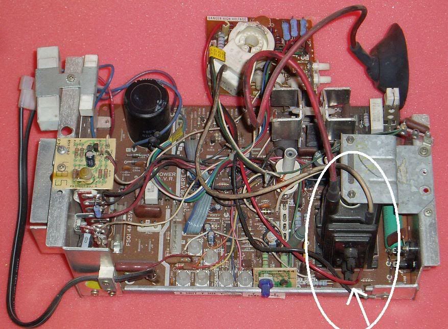

This is an older bartop that's been converted to take an iCade 60-in-1.
The image looks good, but the picture is a little dim. There's smoked glass in front of it, and the glass might be hard to remove because keys for the lock holding it in are bye bye.
Is there an easy way to adjust the brightness on this monitor? Lots of knobs, but I can't find a brightness control...
(Anything else you could tell me about the monitor would be kewl, too.)

The K5800 13" is basically a 4900 monitor. Just adjust the screen control on the flyback to adjust the brightness.
Okay - dumb dumb question: what's the "screen control" consist of? Are these the red, blue, etc. knobs, or a different knob altogether? (Wait...that's the neckboard, I think.)
BTW, I'll try to get pictures soon. It's a big countertop that's deeper than it is wide. Monitor is mounted vertically - almost looks factory, but might not be. Coin slot on right side at the back of the machine.
The screen control is on the flyback (circled below). it is the bottom knob (arrowed)...
