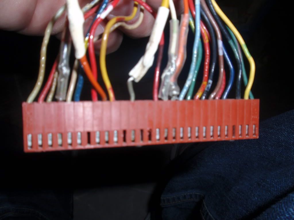

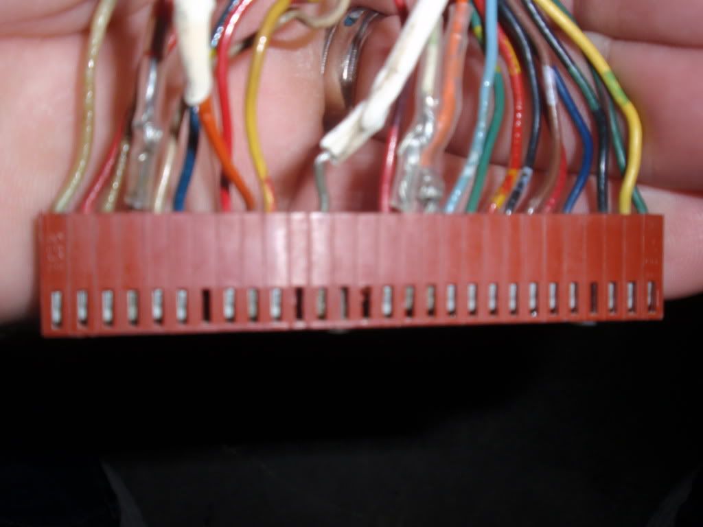

I was redoing some of the poorly twisted connections to the 28 pin connector that plugs into my GORF board-stack. I re-twisted the wires, one at a time, added solder and shrink tubing. Went to fire it up, I get a white screen. Audio is there, attract mode works, game coins up and plays. What gives? I rechecked the pinout and everything seems to be in the right places. Like I said, I did them one at a time.
Is there a color-coded visual guide for how the wiring should be hooked up? This has to be a video problem. I looked at the pin-out, and everything seems to be where it's supposed to be. Game plays blind now. Worked fine before I tried to 'fix' the edge connector. Help.

Here's what my current clusterfuck looks like:

Back onto Gorf, pull your boards out of the cage and reseat them, making sure the boards aren't touching each other. My issue seemed to be a heat-sink touching another board.
Damn Phet,
I would have cut all those splices out and crimped new pins on.
Here the pin colors...
J1
1-empty
2-empty
3-empty
4-empty
5-empty
6-empty
7-BU/YL
8-RD
9-BR/YL
10-YL/GN
11-OR
12-BR
13-empty
14-BR/WH
15-BR/BK
16-WH/YL
17-YL/BK
18-GN/BK
19-RD/YL
20-OR/RD
21-RD/WH
J2
1-GN/RD
2-YL/GN
3-BK/GN
4-empty
5-BU/YL
6-RD
7-BR/WH
8-BK/WH
9-RD/YL
10-GN/YL
11-Lt BU/WH
12-OR
13-WH/GN
14-RD/BK
15-empty
16-empty
17-YL
18-empty
19-Wh/RD
20-BR/YL
21-RD/WH
22-empty
23-BU/YL
24-WH
25-RD/YL
26-WH
27-RD
28-WH
The video signal runs through connector J2 pins 17 and pins 19-21 and 23-28.

I will be. I just didn't have those small pins in my parts drawer. That big yellow wire carries the video then? It's the one supposed to be at pin 17, next to the key?
Pin 17 is a larger gauge yellow wire. The video signal runs through pins 17/19/20/21/23/24/25/26/27/28.
From the motherboard, the signal then runs to a small board called a "RGB Board"......it then leaver this board and heads to the monitor. These RGB Boards can be a problem.

Well I have that yellow wire in the right place, and that was my only concern. Can these RGB boards be tested/ repaired/ replaced?
I'm only aware of three games Midway used these RGB boards in.....Gorf, Wizard Of Wor, and Robby Roto. It'd be nice if someone around you had a game you could test it in. There isn't much to them. I've had the oddball pre-amp chip bad......and those clunky delays crack loose.
Edward
The only thing that goes bad on the RGB board usually is the TBA530 chip. Actually they fail pretty commonly. I have these in stock, just got some in last week.

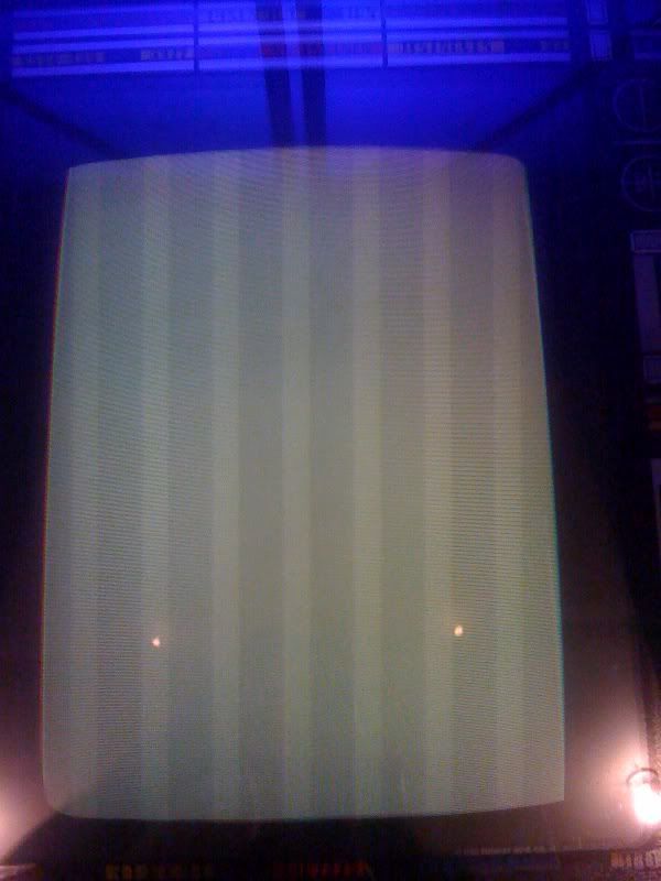

Looks like I'll need to try one. Other than crimping on new pins (which I will do when my Bob Roberts order arrives), all the wires are in the right places and making contact to their corresponding pins. I'm stumped. I get a white screen, but I can see colored movement around the very edges. I tried to mess with the pots, but I still get no image.
Oh, one more thing. I realized before I posted this thread that I had put the large yellow wire on pin 18 by mistake the first time, and got a blank screen. Then I removed it and put it on pin 17 where it belongs, and got the white screen. Could having it on the wrong pin cause that chip to fail?
Edge connectors re-pinned and/or replaced, RGB board tested, IO board tested. I am still getting a white screen, and the game plays blind. This is a rebuilt G07. Backed up a newer monitor to test and got nothing on the screen. I was later informed that Gorf doesn't like newer monitors (WG 7200), so I still need to test with an older monitor to rule the G07 in the machine out as the culprit. Here's the screen I am getting:
