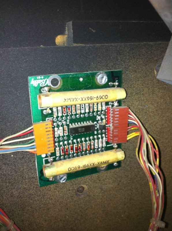

Make sure the monitor you swapped in has the correct interface card, there were a bunch of different ones.

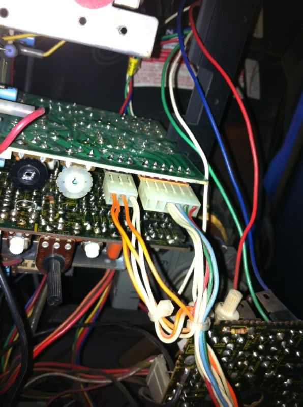

I would really like a picture or confirmation of the correct connections for RGB and GND and also where the sync wires are supposed to go. If this interface board doesn't go with this monitor then that is a problem?
I found a service bulletin from Bally/Midway that shows the video connection different from what the WG4600 manual shows. So now I'm confused on exactly where each wire goes and I've tried tons of different combinations with no video yet.

Here is how the video is looking right now.... I've tried a 2nd complete board set and having the same problems. No video - playing blind. My RGB board has a new TBA530.... Frustrating.
