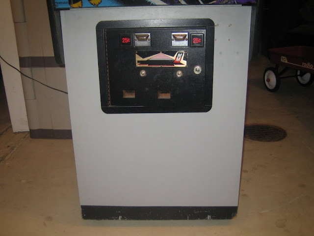

I picked up a Gorf cabinet in really great shape but it is converted to Time Pilot 84. I am converting it back to it's former glory! I've already started on a number of things and have it partially taken apart. Steps so far include:
- Drill out the back door lock. The other two were already drilled.
- Identify the parts I need. At this point I need wiring harness, board set, marquee, bezel, video interface, audio board, the level light board, 4 new feet, 3 locks, a power cord and a control panel overlay.
- CLEAN IT! It smelled like cigarettes and stunk up the entire garage. I drove to work the first day after having it in the garage and wondered why the inside of my car smelled like smoke (this was not the car that transported the game!). The third night our smoke alarms went off at 4:11am ... then again 15 minutes later. The garage is below a room we don't use much and it's door had been closed the whole time. I opened the door and a window and they stopped. Yikes, that's a stinky game! So, yesterday it got a double wipe-down with a water and white vinegar mix inside and out. Much better!
- Identify problem areas. The power board has a burnt connector. The yellow ground strap doesn't go to anywhere (where is that supposed to mount??). The power cord ground wire is not connected to anything and the cord itself has road rash with an exposed conductor. The monitor needs a cap kit. Some of the metal trim is getting rusty.
I think the cabinet is really in very good condition so I'm thinking I'll try to clean the paint and see if I can get away with just new side art. Any thoughts about that?

If it were me, I'd fix the holes on the front and repaint.
As far as the sides, I didn't get a good look, but if you think the condition is good, you may be able to get buy with just side art.
The control panels from This Old Game are just beautiful. Rich is currently out of stock, but is planning on another run of them.

Today I disassembled the cabinet, bondo'ed the bad spots on the bottom, cleaned the power supply and wiring and called around for a sheet of light gray laminate. Guess what? Nobody around here has it so it's special order and takes about 2 weeks to get. I'm thinking of using that instead of paint as that's whats on there now. Just lay it on over the top because there's no way to get the old stuff off. I also sanded, straightened and clear coated the marquee strips and the one above the control panel. Satin clear seems just right.
I've decided to paint the top too. I can't get all the spots out and the wood is a bit more cracked than I thought. So, I'll be stripping the paint in the next few days and ordering side art.
Oh, and I found a quarter in the bottom!

FYI - I just ordered side art from arcadeoverlays.com. I got word from them that they did lighten up the blue background color based on some feedback they got on earlier prints.
I plan to take the approach of matching up the blue paint to the side art. I may not end up with the exact factory blue but it should blend very well with the side art.
And, now, to finally contribute something new (I think) to the discussion about Gorf restores: The bottom is laminated, not painted, as most know. I just matched up the color and it's D92-60 DOVE GREY from Wilsonart Laminate (sold at home depot) which has a matte finish. The phone number on the sample is 1-800-433-3222 if you wanted to call them direct for some reason.
http://samples.wilsonartcontract.com/p-275-dove-grey-d92-60.aspx
You'll need a 30x96 sheet to do the three sides (back is painted blue).

Today I replaced the frayed line cord, fixed the burnt PS molex connetor with the Y wire suggested by retroHacker, verified voltages are good and cleaned more parts. Laminate showed up so it's time to work on the base cabinet in the next couple days.
