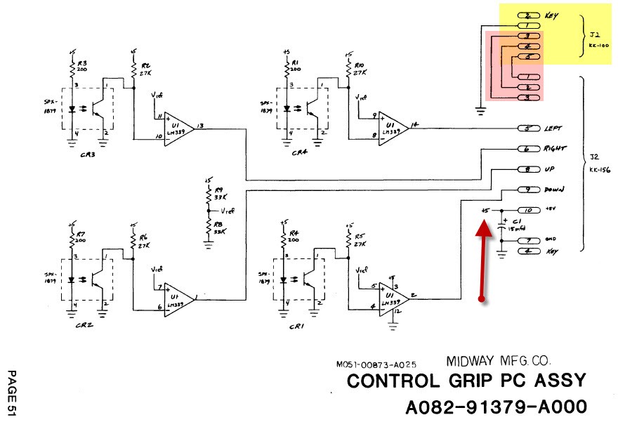

I got my GORF video working after installing a switcher with one of Arcade Shops GORF PS adapter boards. I notice that now my joystick lamps are both working but are VERY dim compared to the way they used to look.
I put a meter on the lamp sockets and measured 4.3v instead of the expected 12v. The #73's are 14v bulbs and are tested good.

Do you know what the "CC" is he is referring to? Clearly, this is the same problem I'm having so I want to switch it around so that I'm getting 12v to the joystick.... just not sure what he's talking about...

On your adapter if you can tell, see what pin 17 is running to now (probably 5v). The schematics are really clear on this being 12, and the lights in the display board are 12v lights, (161) and the ones in the joystick are 14v lights.
Fixed!
Thanks gentlemen for all your help. I was really hoping this thread wasn't going to turn into the debate of using switchers vs. original analog power supply boards...
Yes, the Arcade Shop adapter board for GORF has pin 17 (Blu with Red stripe) routed to the 5v lug on the switcher. I simply removed pin 17 from the cabinet 19 pin connector and inserted it into an available position which was being fed 12v from the switcher - in this case pin 8 was available and I believe there was one other position available too.
Now my joystick lights are nice and bright, my rank lights are brighter than before and the coin counter has a nice strong click sound!

I dunno. I don't think the information is right. Everyone is in the camp that there is unregulated +12vdc going into the joystick to power the 14vdc E73 mini wedge bulbs...
But the official gorf schematics beg to differ:
On the joystick pcb, the 10-pin connector (J2), pin #10 is supplied with +5vdc power.
The schematics also say pin #1 on J2 goes to pin #17 (coin meter #1) on the P/S, which i'm assuming is +5vdc?
On the same pcb, the 5-pin connector (J1), pins 1 & 3 are the fire/trigger. 4 & 5 control the 2 bulb's.
At any rate, if I just wanted to test the joystick by hooking up +5vdc to the pcb, wouldn't the lights turn on? Or does some magic happen with that LM339 (quad comparator) to do this?
I'm the boat now that J2, pin #1 (to pin #17 on the P/S) has to be +12vdc, those E73 14v bulbs won't even glow when i applied direct +5vdc to them, but lit up when i applied anything over +10vdc... Crazy.
So, now the remaining question is I just have the pcb out (no game) and I have wired into the control pcb, +12vdc on pin 1 (J2), ground on pin 7 (J2) and +5vdc on pin 10 (J2), what do i have to short or touch to make the circuitry make the lights turn on? In the game it seems when you land a shot on the enemy, it glows. My guess is pin 11 from J1 on the game board sends the proper signal to the control pcb to pin #3 (J1) to turn on the bulbs.
Not sure what pin 2 does going to/from the driver pcb on pin 2. What's the purpose of this driver pcb?
Ugh, ignore those last 2 posts. That was me thinking out loud.
I figured it out. Simple stuff. Pin 1 on J1 on the control pcb def is +12vdc. The driver board sends a ground to pin 2 on J1 which connects to J2, then lights up the 2 bulbs. I tried it. It works 100%.
The fire button is just an SPST switch on pins 1 and 3 on J2 which goes to pin 3 on J1 that goes to the logic/game pcb on pin 11 on J1.
