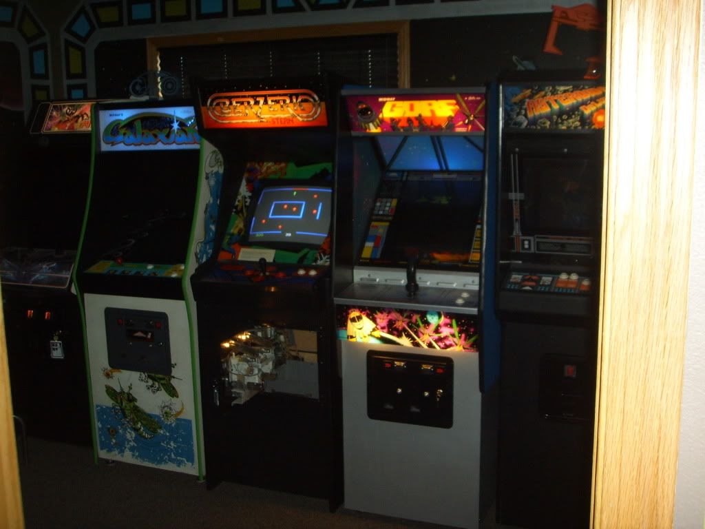

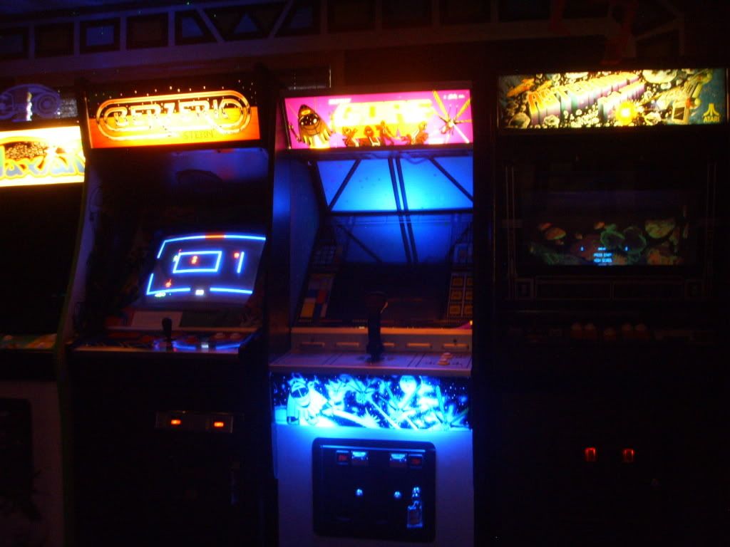

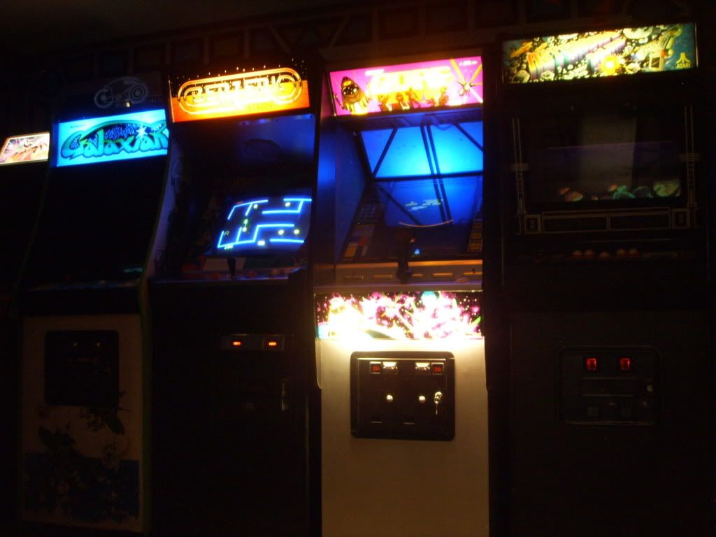

Well I am using 2 25 Watt CFL's and they really 'wash it out' mainly in flash-less photos. With flash, it looks more like this:
They just put out a lot of light, lighting up the Outer Limits and taking away the dark arcade feel:
The BLB's bring the overall lumen level down:
But they do take away the color due to the limited spectrum. Note the pinks/reds and purples are gone. Maybe I should try and find white 15V mini CFLs.
