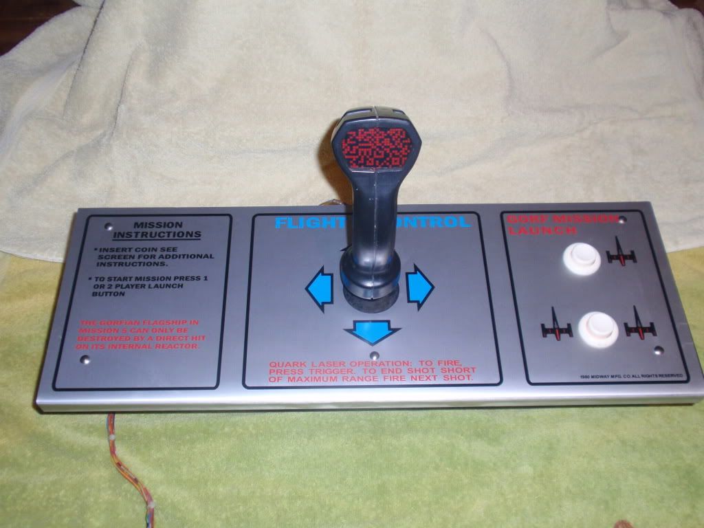

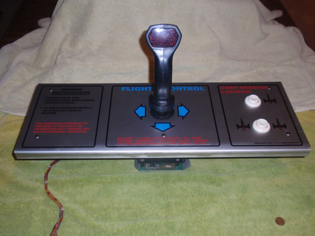

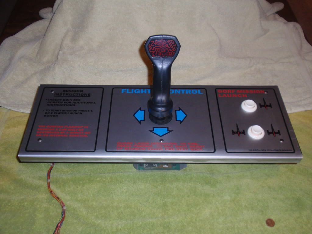

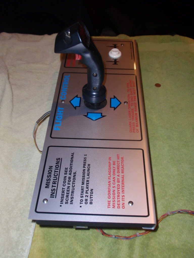

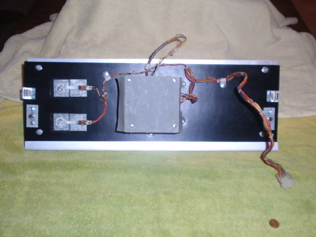

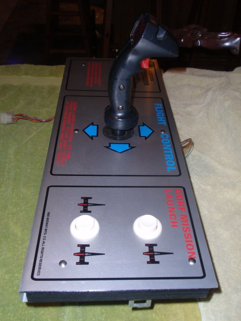

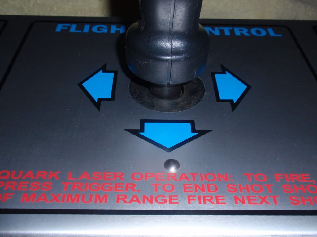

Wow. If you've never taken apart a Gorf flight stick/CP before, and you have one in your future, I feel for you. I thought I could knock this out in a weekend when I started. 10,000 parts, a headache or 2 and several weeks later, I think I am finally finished. In addition to cleaning, painting and replacing rusty screws and nuts, I also picked up one of Rich's last repro panels and found some new bulbs for the stick at NAPA. I can't find my before pics, but here are some afters:

You mean in the handle? Those are just placeholders. The security bolts that go to this stick were painted and still drying at the time of the pic. I wanted to keep it together while I waited. I got excited when I could finally put it back together and didn't want to wait anymore.

I didn't really notice that, what I did notice was the font differences. It's like whoever vectorized this had the "BOLD" key locked on. The original had much finer text. Not sure why it was changed. Here's my original compared to TOG's:
The font on the original panel in your photo is shorter and wider, and a lighter weight. The TOG panel uses Helvetica or Arial bold. The TOG panel text looks nicer IMO.
GORF had a pretty decent production run, it's possible that the font Midway used on the original panels changed over time. The TOG panel might match an original Midway panel from a different production run. Like Midway's Kickman buttons - one run of buttons used the fancy lettering featured on the marquee to print "Kick." A different run of buttons just used all caps Helvetica.
Question about the lights in the handle. Mine are working, though there is a gap between the left and the right light... i.e. a small strip in the middle does not light up; just the left and right side of the stick after firing. Is this normal?
