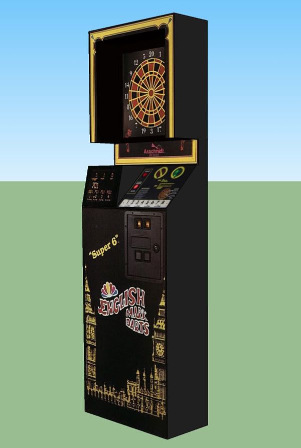

Here's my first attempt at making a cab from scratch. I am having one problem though. The angled area above the coin door... I can past a texture in that angled area but it WILL NOT allow me to modify the dimensions of the texture, etc... basically the whole TEXTURE option is missing when I right click on it. Everywhere else is fine, but not the angled part?! Any suggestions?
Again... I can paste... but I can't modify what I paste...
Very damn good for a first attempt from scratch! You should have seen my first attempt...not pretty.
Uh......
So what is the question? Texture is messed up or something? Are you trying to 'paint' the square area or install a pic onto it. Because it is a flat surface, seems like the easiest method is to File, Import, locate the jpeg files to install there, then place it as an image on the face. Just be sure to begin installing the image on the bottom left corner of the square face, then pull up to the upper right corner. Once it is placed, it'll probably be a little too wide or tall. While the image is still covered in the blue perimeter colors, click the scale icon on the left toolbar there, and move the cursor over the image. You'll see boxes on the image's midpoints. Click and drag the top or right midpoints to get it to fit inside the area you need.
Ah... I had no idea you could "import" flat 2d art... I'd been "painting" the artwork on.
Here... How's this?
That looks perfect! I had one of those at one point, and it looks spot on! Did you take photos for the art?
Thanks... I'm actually pretty satisfied with it being my first. The bottom art, monitor area, art around the head and the head itself came from the flyer. The control panel came from a photo I took of mine some months back.
Looks ultra cool Frizz. Now create an account and upload that thing so I can use it in my layouts. :)
And yes, importing the image is always easier. Only time you'll need to paint something as a texture is when you have a face that is curved or when the face does not have 4 right angles. Most every cpo and marquee can just be imported onto the face. Very quick and easy to make lots of fast games.
