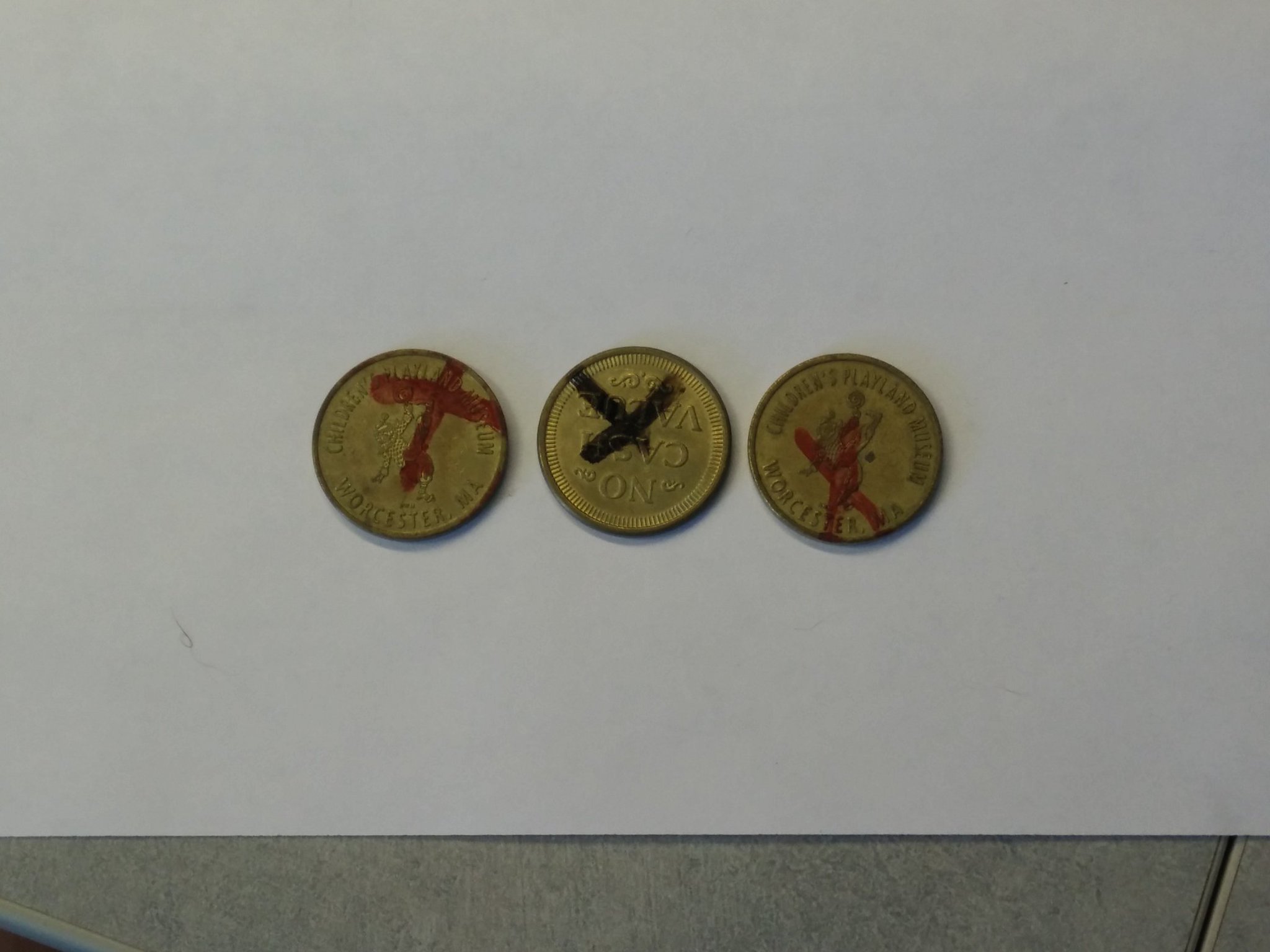

I've got misc numbers of various varieties, but I've got the most (~2000?) of these:
Obverse: Worcester Children's Playland Museum (with a clown)
Reverse: No Cash Value
The op I cleaned out ran his own tokens, so he sharpied 'foreign' tokens and threw them in buckets... nothing a little solvent bath won't fix, and you'll want to wash any bulk tokens anyway.
