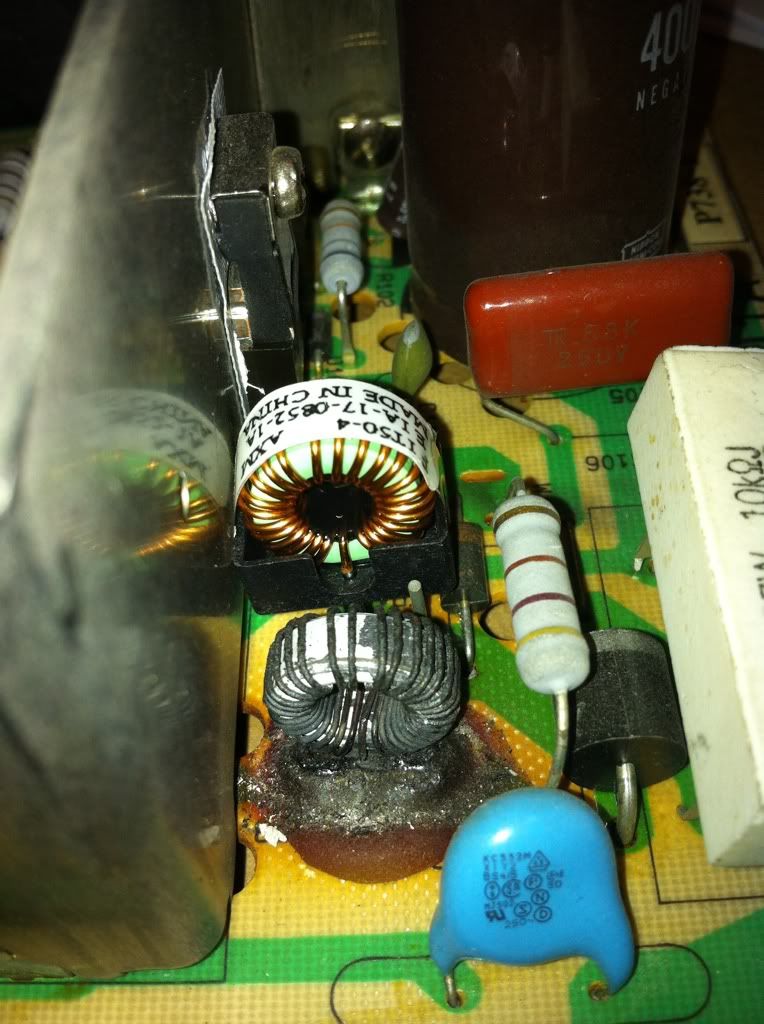

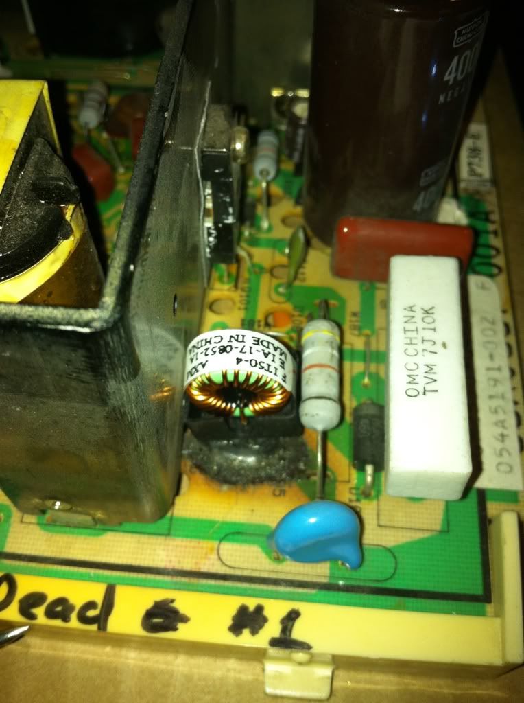

Look at L103 too, all of mine were burnt or gone on the 5 U5000 chassis's I own.
I found one very close at mouser with a much higher current rating, hopefully won't burn again. Haven't tried it, but if the monitor can work with a dead short installed, one with a slightly different inductance should work.
As the rest said, go through the update instructions, make sure heatsinks are on the transistors as specified. Mouser also sells them too.
L103 pics, old and new (not installed yet)
OH BALLS!! man, those char!! But why??? due to bad caps i would assume? I see that alot in flatscrene tvs when the caps get high esr somehow it stresses the coil.
