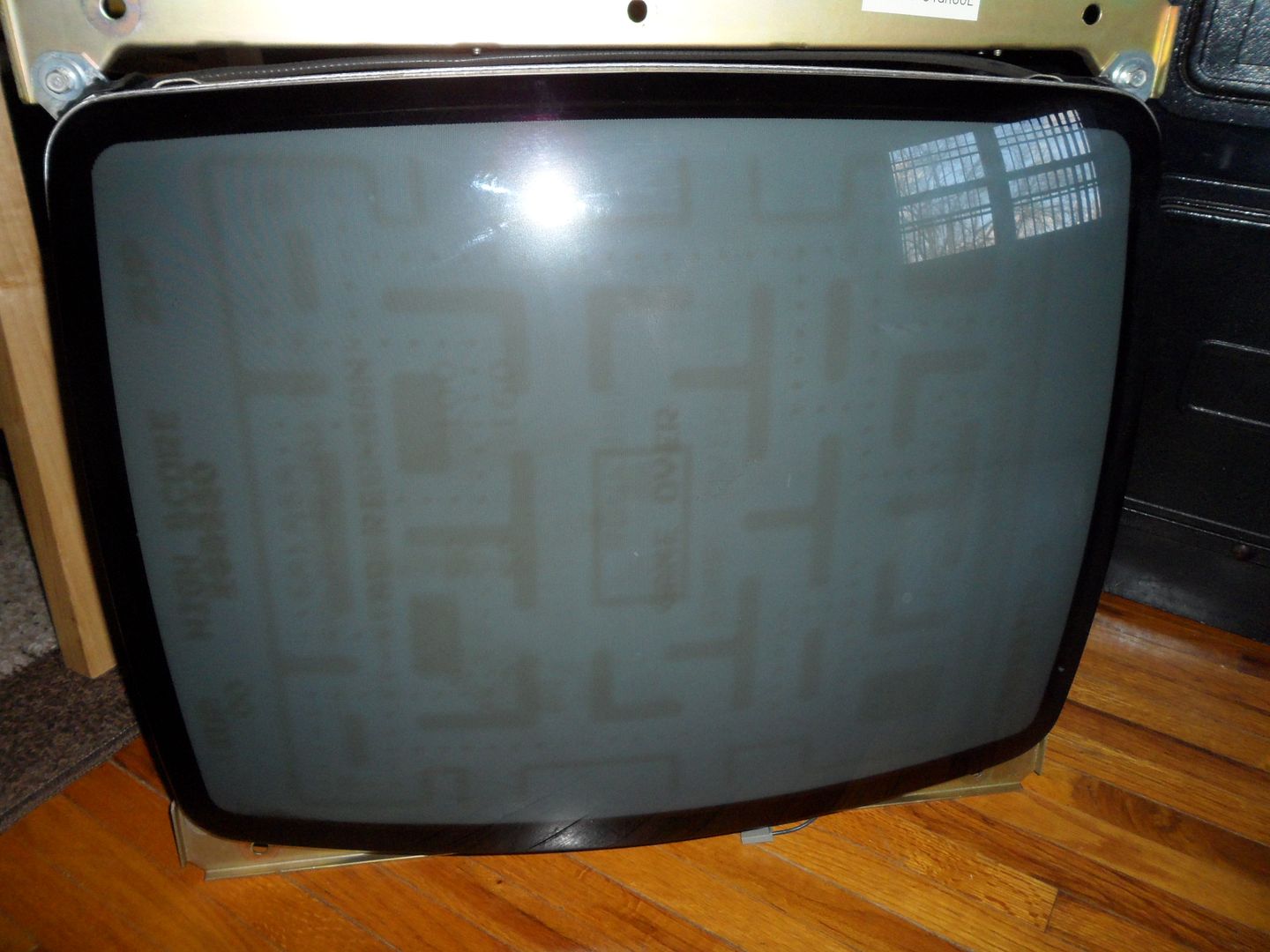

So, I took a chance and told him I'd be by in the morning to pick it up. The price for the tube and chassis was $60. When I got there, I was saddened that the tube actually had quite a bit of burn...

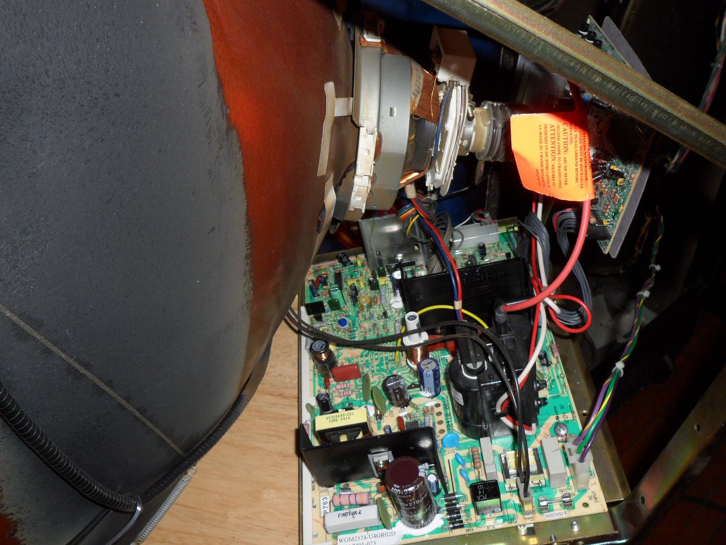

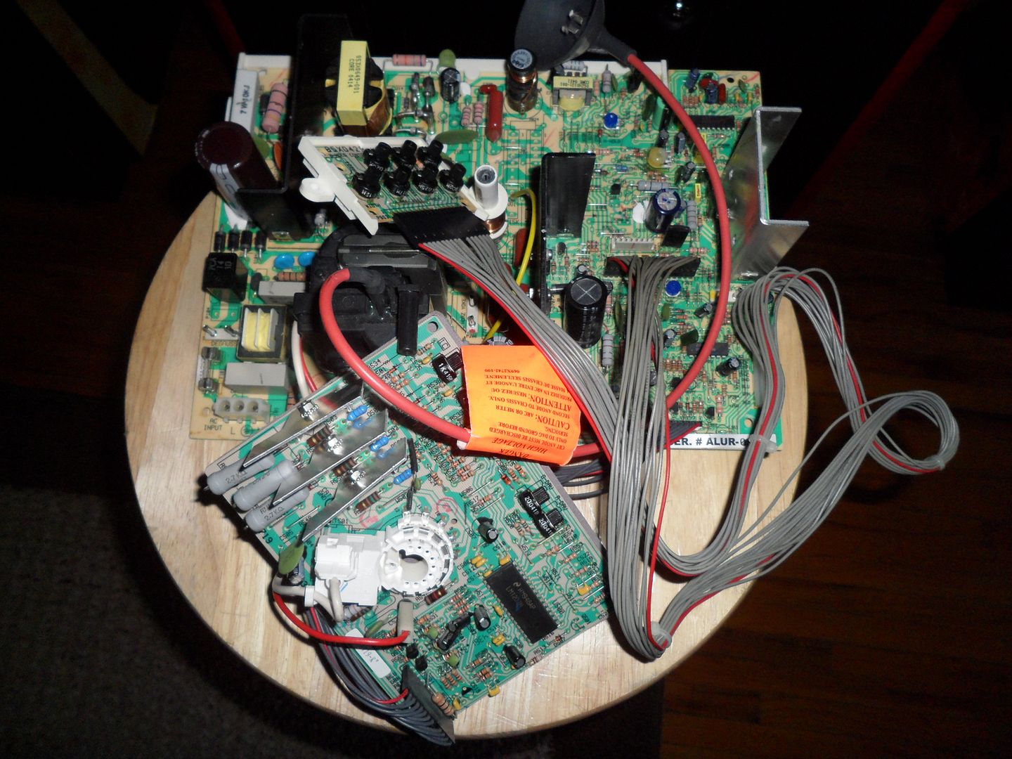

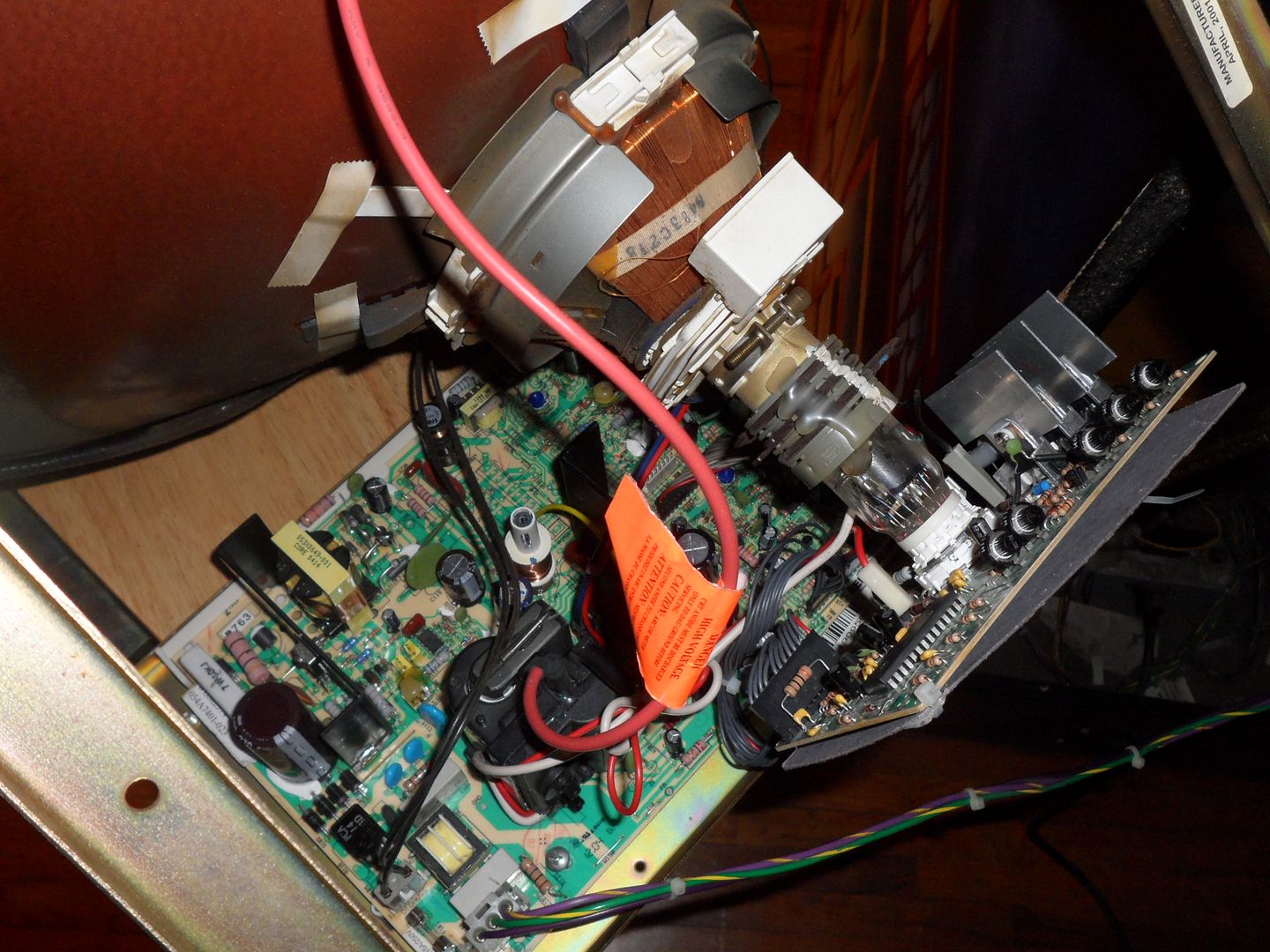

...but the chassis turned out to be a K7400 in GREAT looking shape. It looks as if it was NOS right out of the box....
...but that's where the good news ends. Turns out it's blowing HOTs. He said it was just "ticking" and he changed the HOT and it would still keep "ticking." He also said he changed some of the caps and not others. I verified that the HOT does is fact check shorted in circuit. I haven't really done any other troubleshooting. Any quick advice? I have some new HOTs on the way already, but I also need to know where I can get a FULL 7400 cap kit besides Bob Roberts. Nothing against him, I just don't like going through the Money Order hassle. I can go that route if need be, but if there is anywhere else, that would be better for me.

No. The B+ and the shutdown pots are both still securely glued. The chassis is in such good condition, it doesn't appear that it's even ever been used, even though it has. I felt the price of $60 was fair because I was going to use the tube as a test tube for other chassis' anyway, so the screen burn is not an issue and I should be able to get the chassis going fairly easily. I am about 99% sure the seller tried to test it without using an ISO, so we'll see once I get a new HOT in there how it works out. I've been poking and prodding, taking various readings of diodes and such and everything appears to be good in circuit. Only the HOT reads shorted.
Its a good deal just for the neck board, as it is the newer version with better heatsinks for the transistors instead of the flaky clip on ones.
Thanks guys. I started troubleshooting this today. First step in any troubleshooting is to verify the issue. The HOT was in fact shorted, but I installed the chassis on the tube and sure enough. Nothing. The new HOTs that I ordered came in today so I installed one of them in the chassis and reinstalled it on the tube. SUCCESS! Picture came up and I let it run for nearly an hour with no issues.
I am 99.9% sure what happened was someone at some point in the past did something to cause the HOT to short. They installed a new one but didn't cut off the legs sticking out the bottom of the chassis so when they reinstalled it, the legs shorted to the monitor frame and took out the HOT again.
In any case. It's now good to go and I got a working tube, yoke, and K7400 in remarkable condition. Cost me $60 and $10 for the new HOTs. Not a bad investment. The screen burn is a bummer because it's noticeable during game play. I'd say on a scale of 1-10, it's a 3. Not that bad, but you CAN still see it. As my plans are to use the tube as a test tube for K7400 and their compatible kin, that's ok. The chassis alone in the condition it's in was worth the $60. Here are some pics...
the colors and contrast are great on that tube considering.....nice purchase.
