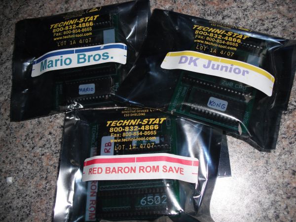

Got these at lunch time today...
And then on the way home I swung by a co-worker's house to pick this up...
Biggest problem is that the backglass needs to be replaced due to lots and lots of missing paint and flaking...
It also doesn't work yet... but I've made some decent progress getting the displays working and solenoids to stop burning.
The wifey and kiddos can't wait for this to start working... so I'm taking off Thursday and Friday to try and please them. :)
