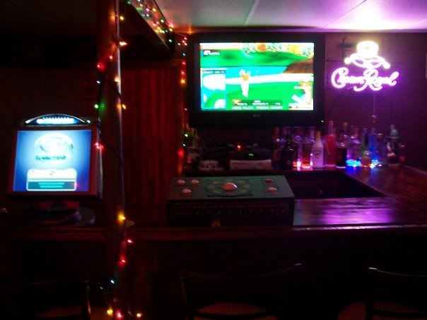

Can a Golden Tee Complete be hooked up to, say a 32" Vizio, like the GT Live machines? How so, if so?
Thanks!
-Mike
Here is my home made GT2005 hooked up to my 32" LCD in my Bar. I am using a Averkey converter. For the Averkey you remove the d-sub cable that is outputing from the video card to the motherboard and plug it into the converter. The converter can then output in s-video, composite, or d-sub. I have mine hooked up with s-video as this tv doesn't have a d-sub.

Sweet set up
I Dig the Crown Royal sign
