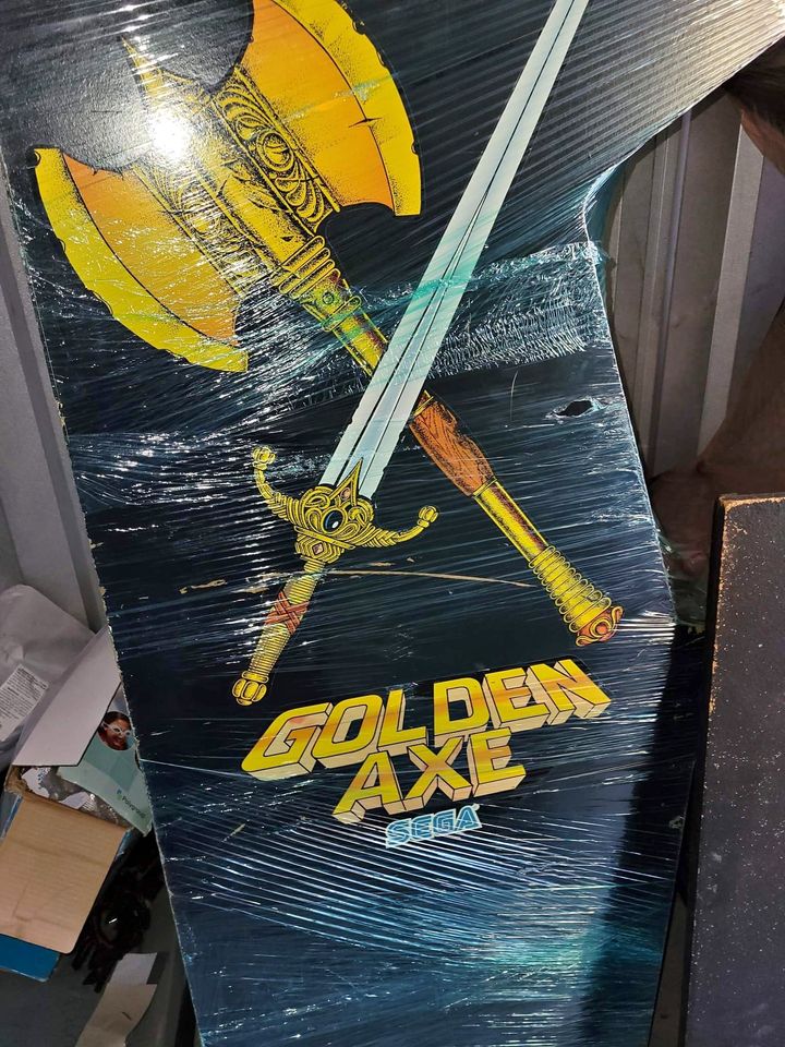

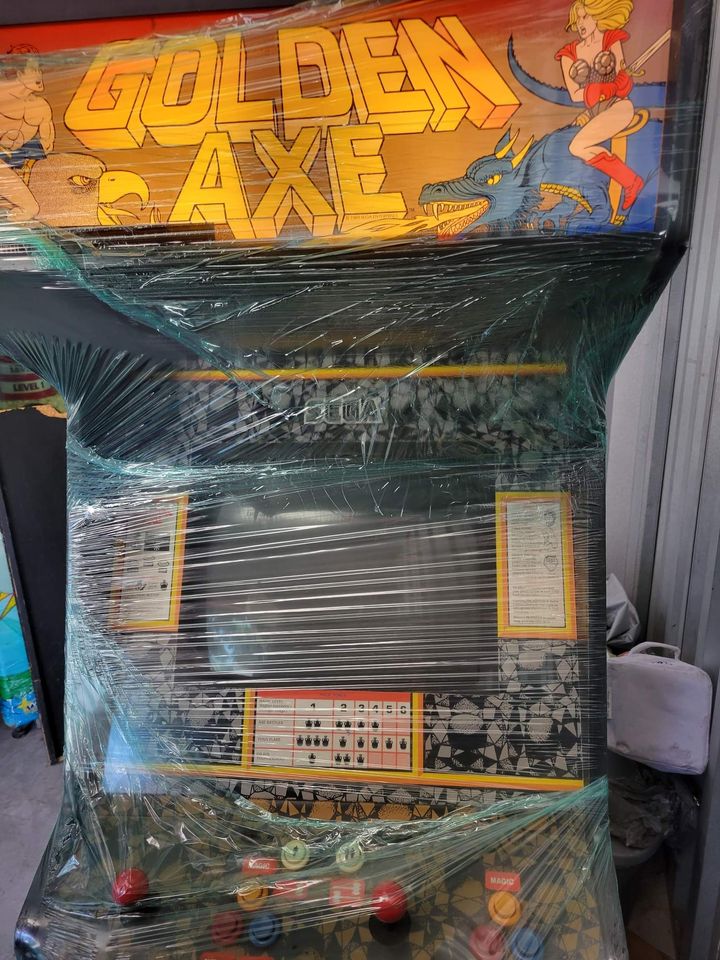

Hello all, so I'm back from Orlando with the Golden Axe, here are the pictures that I promised. It is a HS1 dedicated with labels intact. It's playing blind but has neck glow. The fella also had a Altered Beast that he said he had no idea if it worked. I gave $700 for the pair. The AB plays like a champ but the P1 kick isn't kicking yet. The guy was getting out of the hobby. These were both in a storage unit.

Thank you, the Golden Axe had a loose connection to the monitor and was the focus was blurry. Cap kit sticker was 5 yrs old so I just replaced the fly back. Looks crisp now. The kick issue on P1 was was a crossed wire. As soon as I turned the game on, it started a 2 player game. The kick button and player 1 wires didn't have a connector on the ends. The were just twisted onto the micro but the two were backwards. Easy fix.
