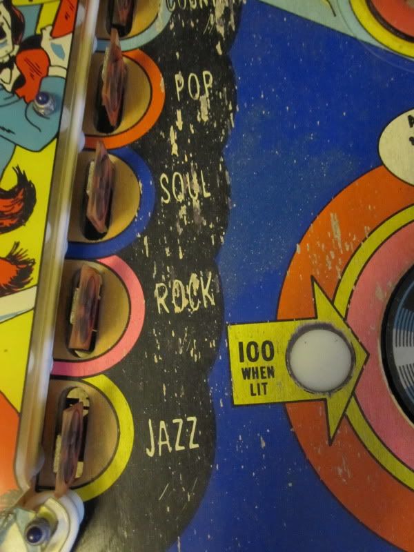

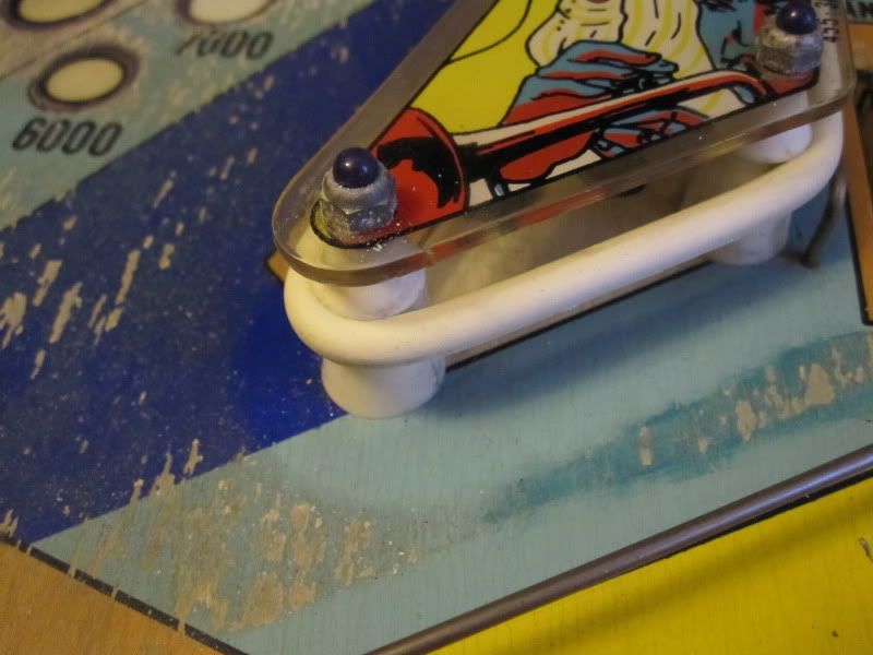

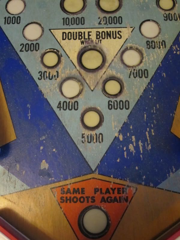

I have another post about a 1975 Chicago Coin pinball machine called "Gold Record". I bought it for $95 and began restoring the playfield. I probably put about $40 into the playfield with paints, clearcoat, sandpaper, new inserts, and new bumper caps.
I'm just finishing up the clearcoat and polishing, so the "after" pictures will be posted soon. My restoration is not perfect. Someone tried to redo the insert circles with magic marker, and it bled through my clearcoat/paint a little. They also had a couple terrible touchups in the blue spaces. I didn't think it would until I had actually sprayed the clear. There were so many colors and straight lines to do that it was really difficult. Also, the wood was literally chipped away in several places around inserts. Inserts were actually falling out on their own when I was moving the cabinet around.
Anyway, here are some before pictures.

This job took about 5 good coats of clear and plenty of sanding. I'm still sanding, so finished pictures may be up later today. The parts where the wood was chipped away (not just visible, literally chipped away by the inserts) took tons of paint and clear to get it level. It's still not 100% level, but I wasn't really shooting for perfection on this restoration. I was looking to get it to play well and prevent further wear.

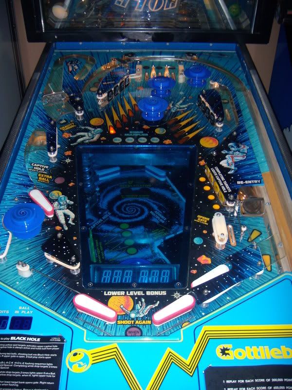

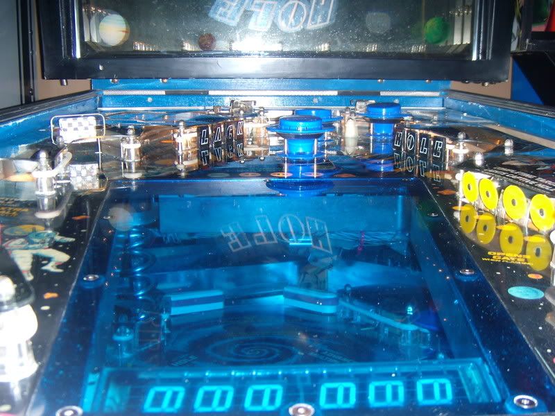

I restored a Black Hole a few years ago and cleared it with spray can Varathane. It's super smooth and glossy. Plays great. It was worn to the wood all around all three bumpers. Check these out while waiting for the new ones :)

Here's one quick shot of the Gold Record as it is right now. The only part I'm upset with is the center insert in the white area. That's where a previous owner used magic marker to trace some letters and the circle. I covered it with paint, but when I clear coated it thee marker bled through and looks kind of crappy.
The flash on the camera makes some of the colors look unmatched, but they are dead on in person.

Here is a good question. On a lot of these older pins you can see where the flippers were in the bare wood areas. Has anyone tried sanding that down and re-staining it?

I actually sanded the flipper area quite a bit and put some natural color stain there. It took care of some of the unevenness, but after a while, I figured it's just getting covered with flippers again anyway, especially closer to the hole. I also evened out the line up on the top a little, but it's like I just feathered it out instead of really getting rid of it. Both are still really noticeable, but much improved.
As far as paint codes....I have none. We mixed these colors by hand.
I think the best part of this restoration was just that I had fun doing it and it made getting the machine worthwhile. I will probably restore the cabinet too, but not until next week or later.
The toughest part of the restoration was redoing the yellow/black circles around the bumper areas. There were mylar circles around each bumper, and when I removed those it took the majority of the paint and some wood with it. So, those areas are probably 80% completely repainted. Circles are not easy.

We just used cheap craft acrylics for the paints. Since it gets clearcoated, it makes no difference. They are readily available and only cost $1. The biggest advantage to those cheapies is that they come in a wide variety of colors, which means minimal mixing to get the colors you need. There were a couple colors (orange and yellow) that were were able to use right out of the container with no mixing at all.
