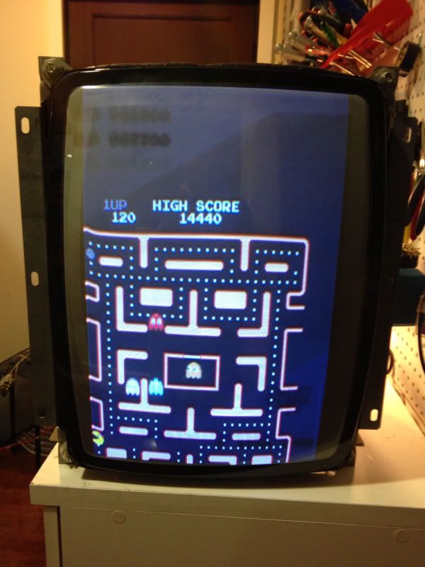

I brought back this dead go7 by installing a cap kit, fly and hot. How do I adjust the Horizontal position? I tried the Horz. jumpers and they don't do anything. The Horz. width coil also doesn't move the picture. Thanks.
I have never seen a picture that far off and not lose sync. start testing everything in the horizontal circuit. I would assume you tried te horizontal freq. pot since you didnt post you tried to adjust it.
The sync was hooked up wrong which is how it was hooked up when I got the game not working. All working now. Thanks for the help.
