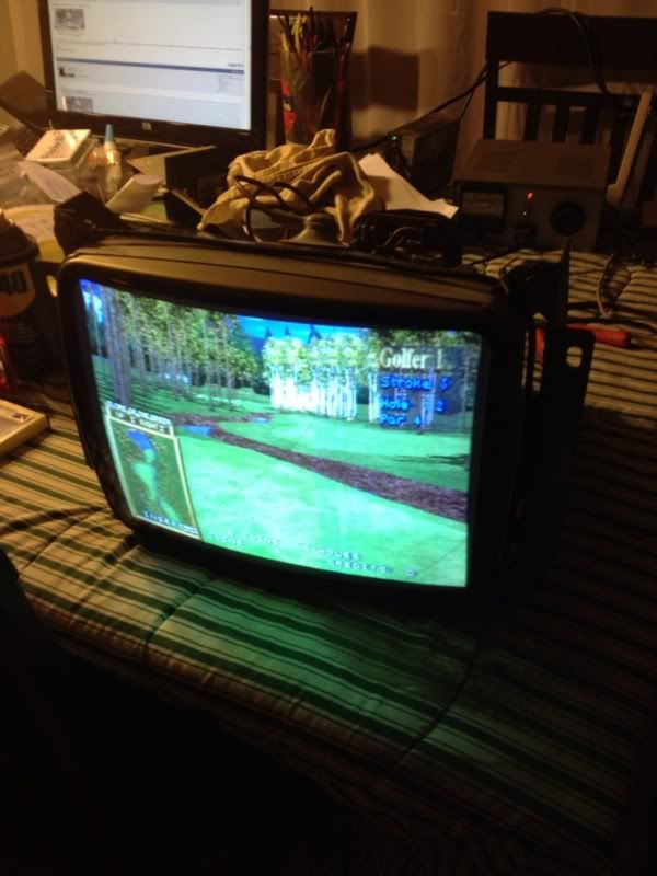

Cant seem to adjust this over to the right what am i doing wrong?
could it be a bad pot?
this is a freshly capped monitor...this problem was there before and after
Thanks

UPDATE:
pulled the pot and tested it...tested fine reading 5k
So rather than replace it just yet, since it tests good...i decided to go ahead and reflow the shit out of the H circuit.
put it on the test bench and after a little adjusting i got it working correctly. However i should have tested it on the bench first..oh well
Now to put her back in the Moppet and see what happens

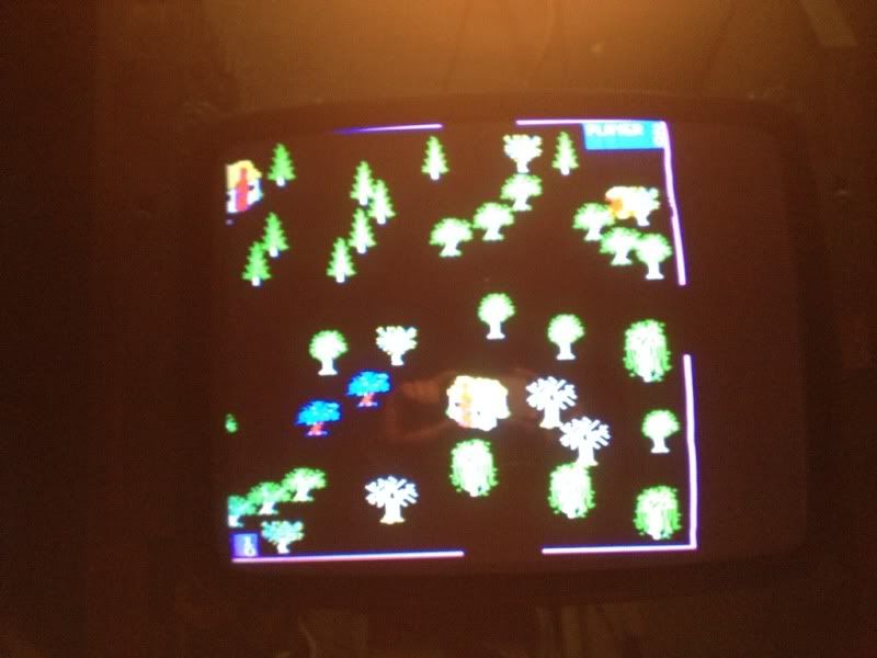

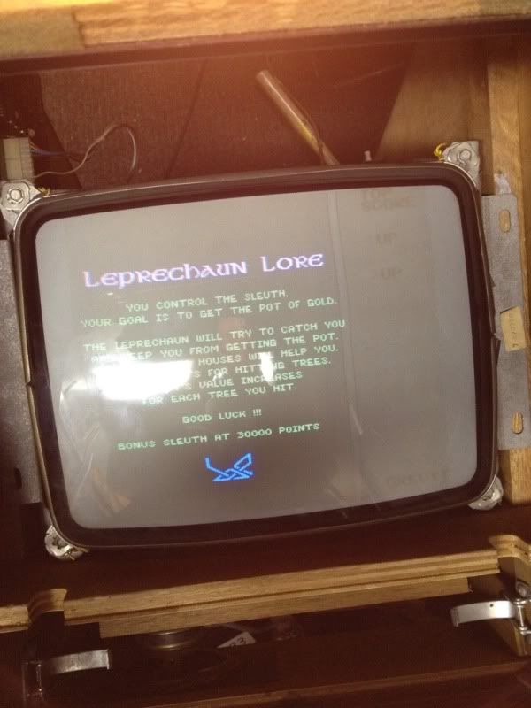

Yet further update: sad news
Still the same in the moppet cab...sync issue for sure
There is screen burn in the monitor and looks like its been this way for a very long time..
Cant find pinout/manual/anything for leprechaun
Anyone here have a leprechaun sync with a go7?
i guess i could hook up a wells and see what happens.
