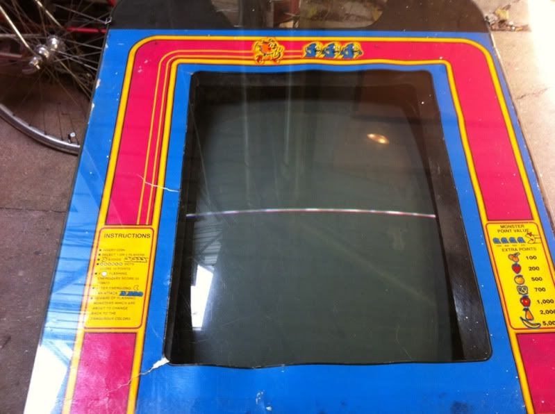

I took a look at a friend's G07_CA0 Ms. Pac Monitor the other day and It's got a collapsed screen. I'm going back to cap it and was wondering if it may also need something else. Wouldn't the line be the other direction if it was a vert problem? Could the horizontal width coil be bad? Ms. Pac board has been tested in another cab and works. Thanks.
width coil
width coil might have just broken off at board. resolder and your good to go.
check if yoke wires at plug or tube are not broken.
