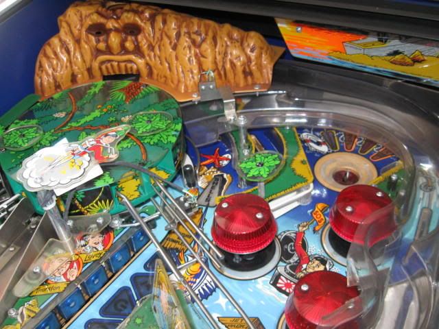

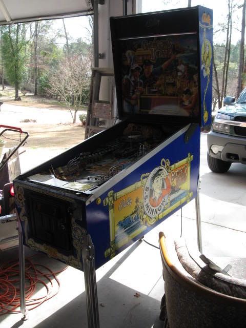

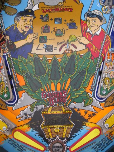

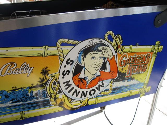

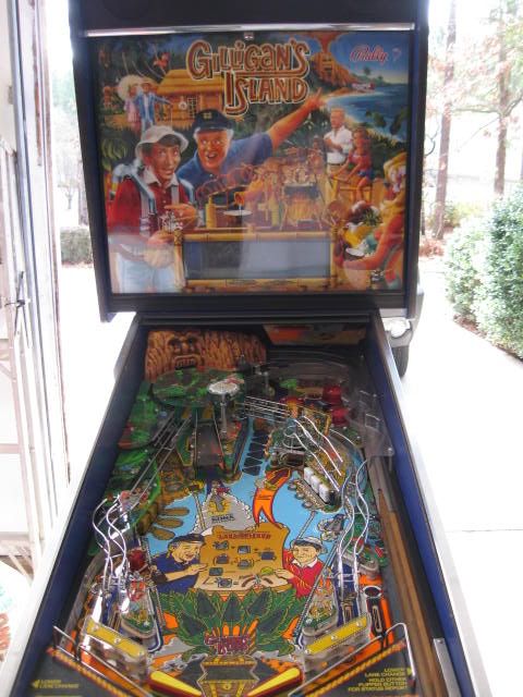

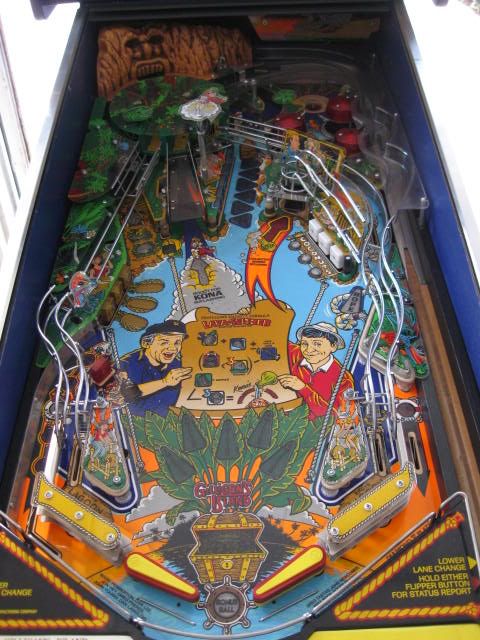

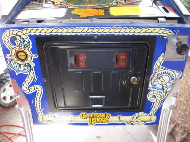

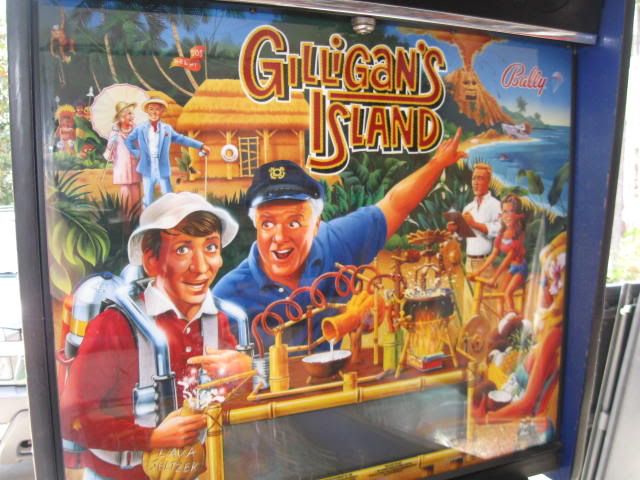

ok...i couldn't resist...went ahead and snapped a few pics:
i'm really happy with the way this thing looks...hopefully the repairs won't be too difficult.
i'll put up some pics of the problem area that i found in a bit...should be easier to see than the video i posted above.
