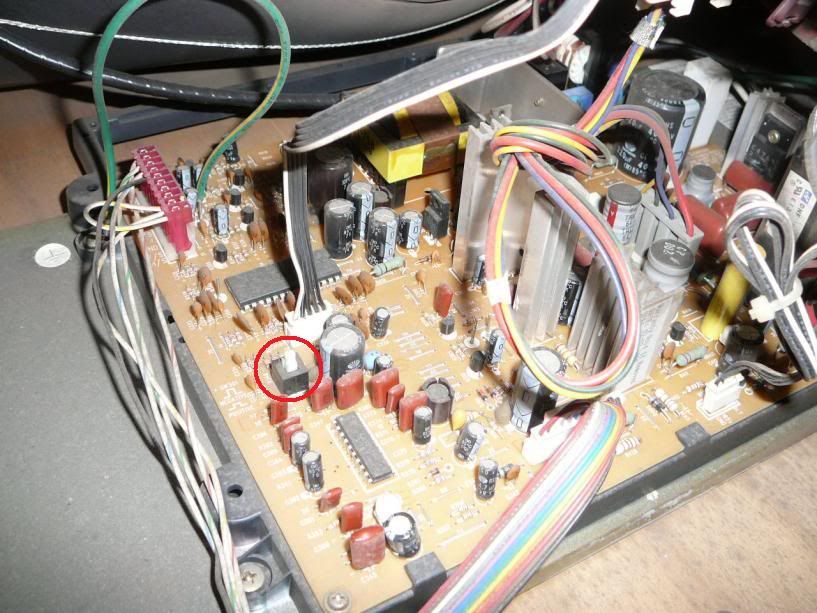

Well. I did it. My 1st cap kit!! Smalltownguy2 was right this sucker had a TON of caps. 35 in all! I plugged it back in and it actually worked! Well, sorta. I am still having an issue although I don't think it's "cap" related. I've attached a link to the video I shot of it. What do you guys think?

Try pushing the white button on the chassis...
Are you talking about that horiz osc pot that I point to at the end of the video? It is very touchy and I believe I will have to replace it. I did reflow the solder pins for it and it may have helped a little. I found a likely candidate. Would it be a 2kb pot?
Nope. It is circled in the pic below. it is a sync selector switch and if it accidentally got pushed during your rebuild, it could cause this issue...
Check the solder on the sync pins. Make sure there's no cold joints or cracks. Reflow the whole header of pins while you're at it. Sometimes just plugging and unplugging the video and sync cables is all it takes to break them loose.
I really looks like your picture is there, you are just missing sync.
Of course there could be any number of other components in the sync circuit that are not working either. If that's the case, then you're outta my league :)
One thing you could do to check for cracked solder joints would be to flex the pcb while it's powered up. get a plastic long tool and press on the middle of the board a bit and see if you get any noticeable changes in the picture.
