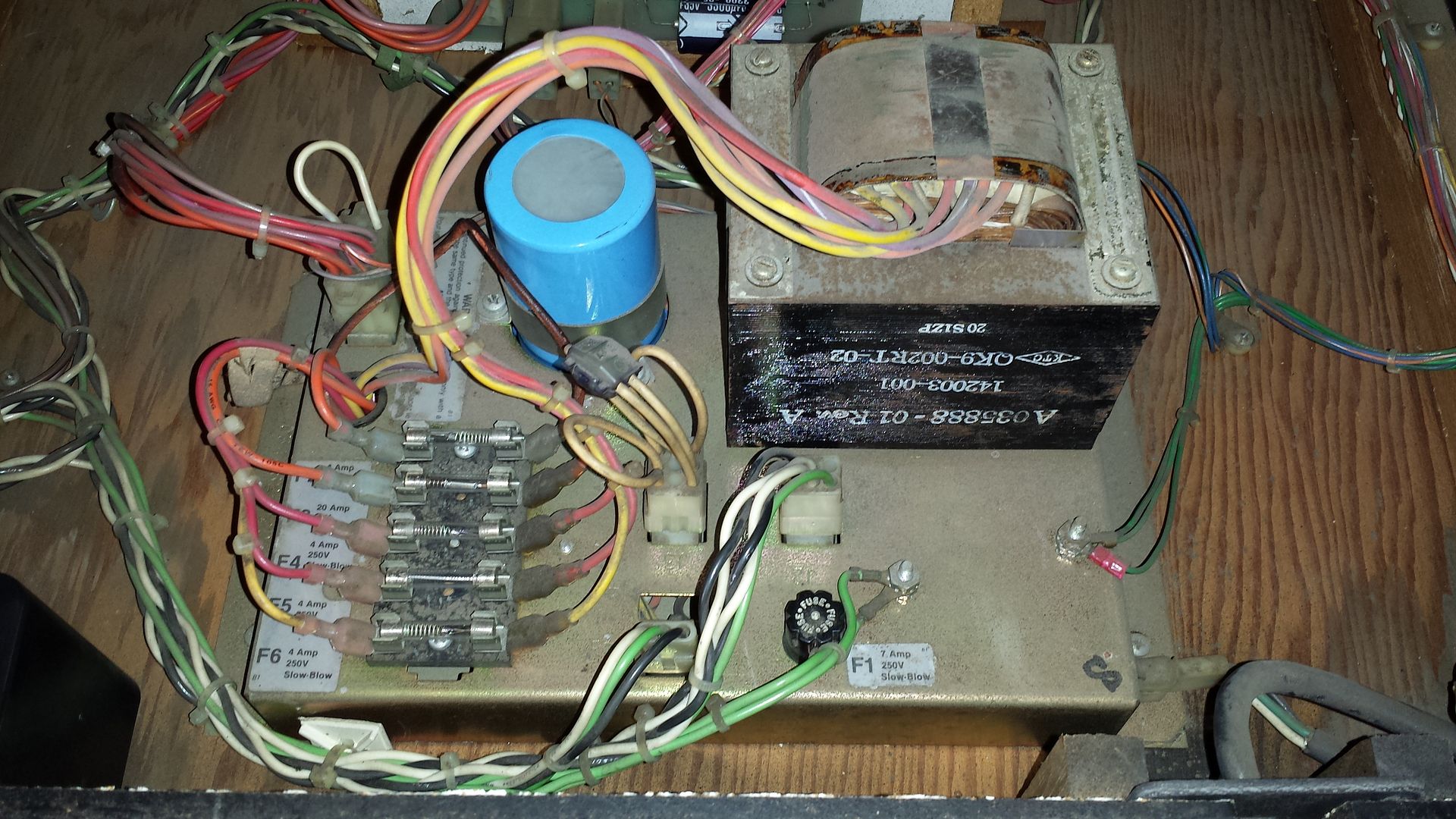

Here is a pic of my power brick. If any of you guys see something thats not right please feel free to comment. I will take all the help I can get and be very grateful. Thanks. Michael

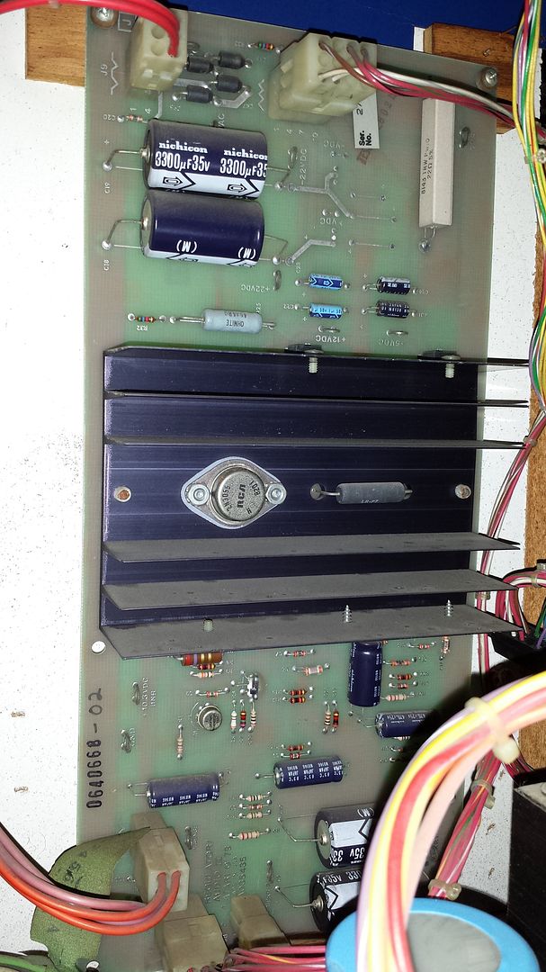

You'll NEED to verify the voltages. There are test points on the AR2 board - the one with the large heat sink - that's the power supply and audio amp all in one board.
Measure the voltages at the test lugs on the PCB. Drops can occur from the AR2 to the board edge due to age/oxidation. Report back on what you get and we can help you go from there.
I removed the whole power brick from the cabinet to give it once over and clean it up a bit. I also ordered a BIG BLUE cap to replace this original one. I should have it in the mail in a few days. Once I swap it out I'll put the brick back in and fire it up. I am hoping for a miracle quick fix but I doubt it. LOL I will check voltage on the PCB then. Thanks for the help so far.

New big blue never hurts. Bridge rectifier is the part on the brick that can fail, but no blown fuses is a good thing. You'll want to recap the AR2 at some point, but the parts that typically crap the bed on there are the 3055 transistor on the big heat sink, the voltage regulator, or the trim pot for the voltage regulator. Are the resistors at R29 and R30 ok?

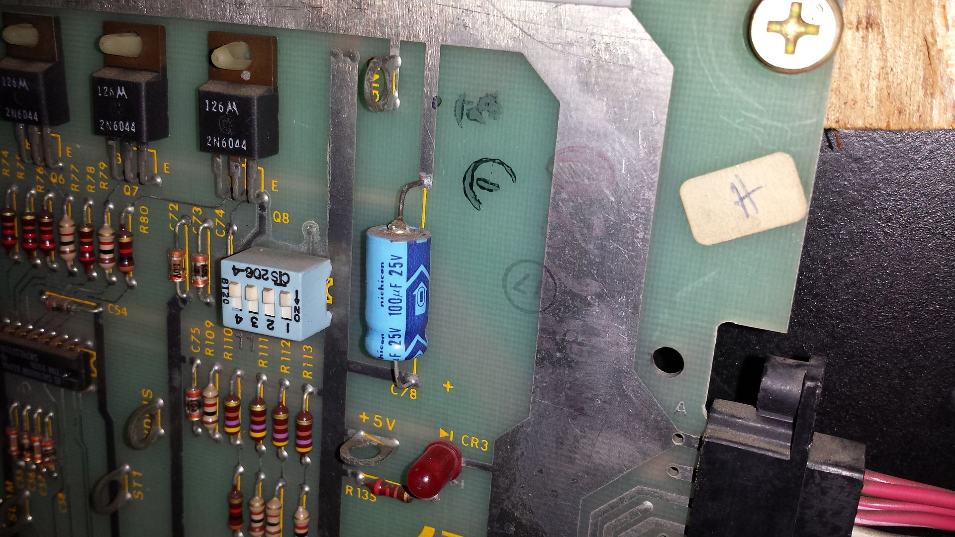

Ok... While I wait for the BIG BLUE to show up in the mail I said what the heck and put the power brick back in and powered it up to check voltage readings. On the PCB I see a +5V little ring and about 4 inches straight up from it is a GROUND ring. When I put my FLUKE on there it reads 9.77 VDC. This is all I have done so far. Any thoughts on why thats reading so high? Or is that high? Thanks. Michael

Don't continue to power the logic board till you get 5.0VDC on those test points.

No, just worry about the +5 for now. Ideally you should have your leads clipped on to the +5 and GND test points and be ready to shut the game off if the voltages are too high. That goes for any game you test going forward too.

By all means recap the AR2, but there's a problem with the +5v regulation there and a cap kit plus power transistor isn't likely to fix it. I'd highly recommend replacing the voltage regulator (small silver can near the trim pot), and get a new trim pot while you are at it. I've found either or both of those bad numerous times when the 5v line was out of whack.
Arc is right. You'll need a load on the AR2 that's provided by the PCB to make adjustments, but allowing 9v to pump through to the PCB for any length of time might take out components on the PCB. You can use the AR2 from your Tempest to confirm that there's an issue with the AR2 (almost a certainty here) in the Centipede. Once you are getting good 5v to the PCB, then it's on to troubleshooting the board if it still doesn't come up.
My first guess - 2N3055 Q3 is short. Can ohm it out and validate. (if low impedance, voltage drop from 10.3Vdc unreg to the noted 9.7V could be seen)
My second guess - LM305 Q1 is dead. Replace.
My third guess - both these parts are bad.
Double check R29 and R30 remote sense resistors are still 10ohm (and not high impedance). I believe this can cause over-voltage.
NOTE: if either sense resistor is shown to be incorrect higher impedance, then this may imply poor edge connector contacts and this would then need to be investigated too.
