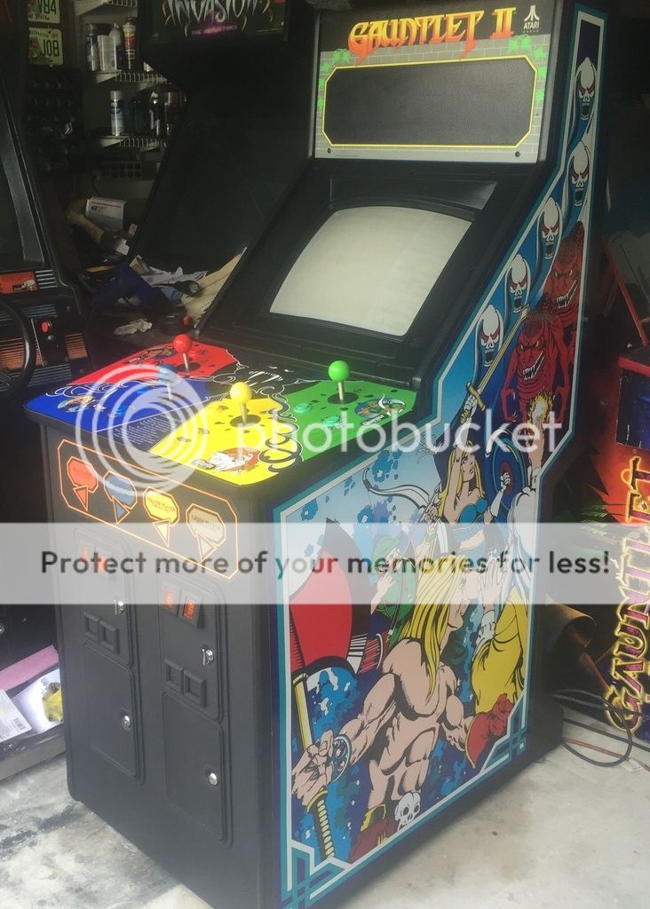

Managed to tick off quite a few things.

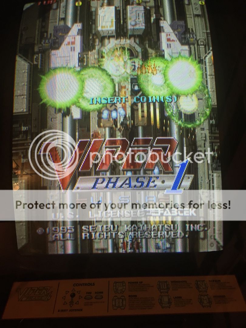

Sat - fixed cold solder joints on Wells 25" and fixed intermittent sound on Seibu SPI mobo (caps in audio section).
Sunday - ground up Gauntlet restore finished! (Sideart and CP installed, Wicos instead of Atari sticks, can't afford Atari prices)

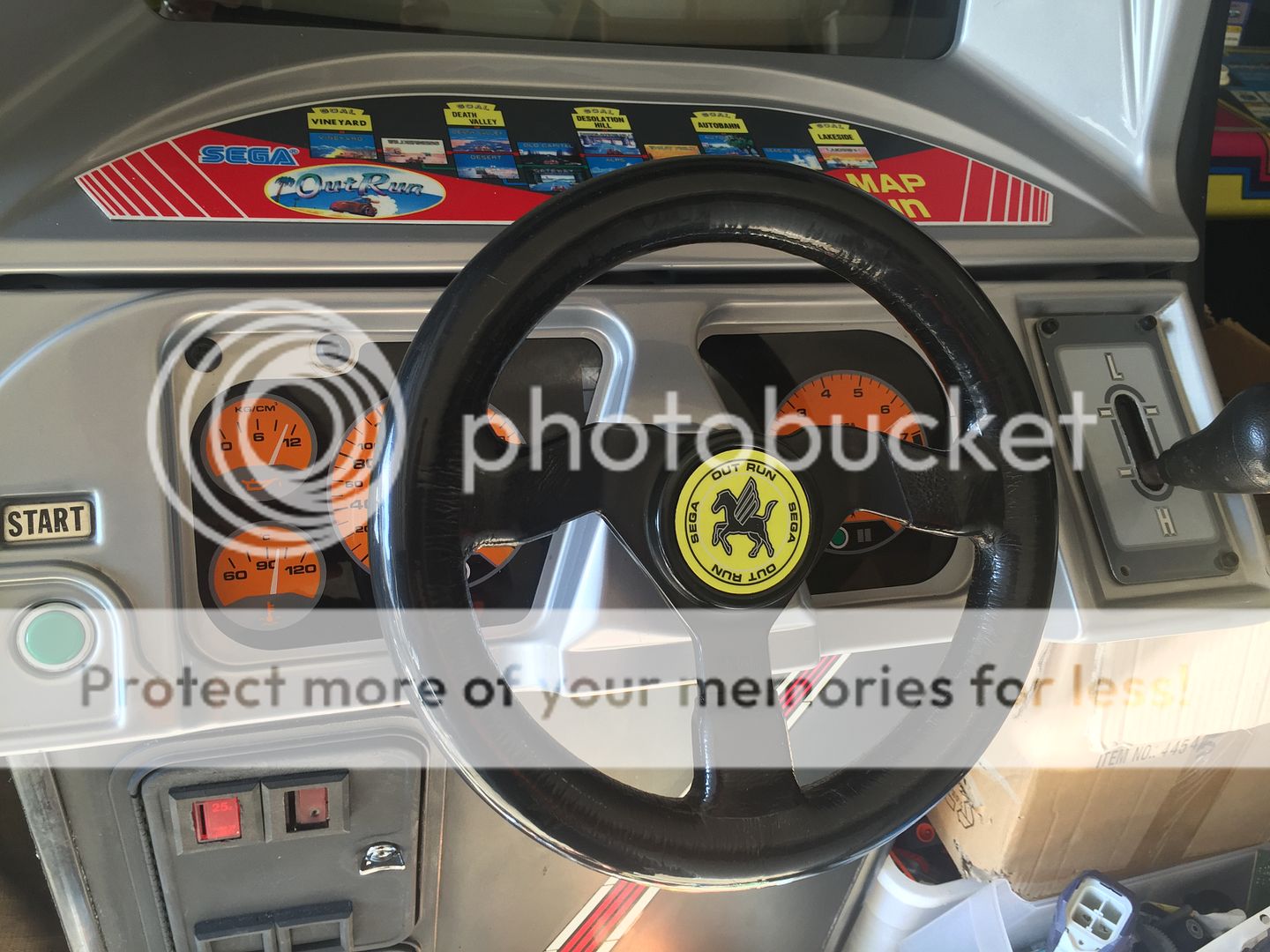

Monday - disassembled Outrun control panel to clean it before installing the center cap I've had on a shelf for 4 months.

That Outrun is looking good.
