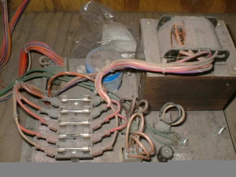

Here is a view of the back of cabinet - transformer chassis at base of cabinet (i know its low resolution - will get better ones soon)
Here is the underside of the transformer chassis... (all in good condition, all fuses are on the top side of this chassis and they have continuity - unless the 'filter unit' is a fuse?? - me still learning!!)

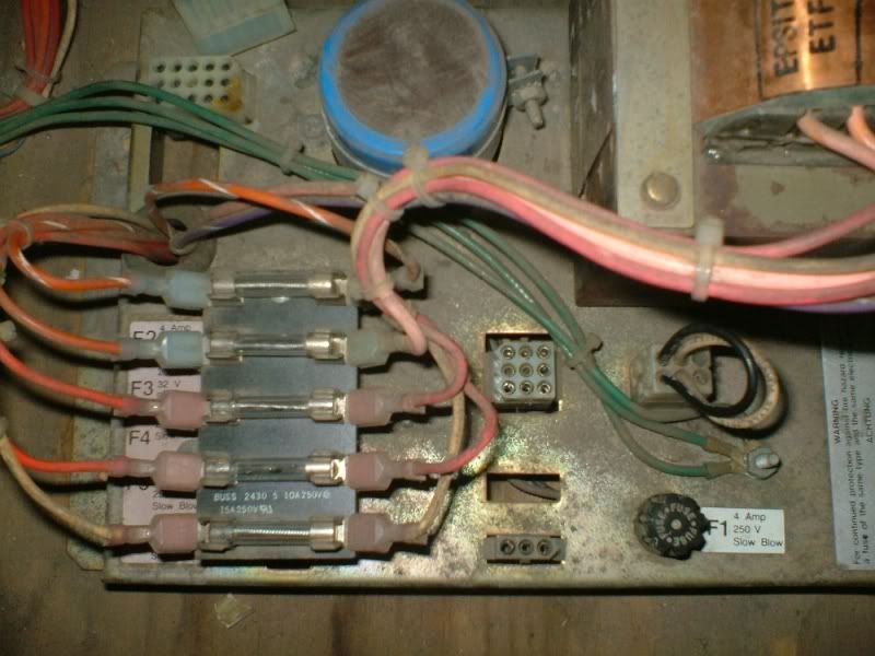

One thing that comes to mind is the jumper blocks which appear on the following picture..... Excuse the dust here - i have since cleaned and will take new photos... Here you see the fuse array and they all check out fine.... top left of pic is the terminal which goes up to monitor (well, the black and white wires from here do) and these 'jumper blocks' for want of a better description, seem fine except the one at the bottom of pic has three possible combinations of being plugged in (has 3 rows of 3 pins on the jumper block and only 1 row of 3 pins on the receiving terminal block on the chassis).... arg... i hope im making sense!!
okay, that is an Atari power brick. Believe it or not, the monitor power will come out of that transformer with the Big Blue capacitor, the five fuses mounted on top, and the bridge rectifier missing, so they have nothing to do with the monitor power.

Is the fuse inside the black fuse holder the one for the monitor on the Atari block? Or is that for the mains coming into the game and monitor fuse is on that main fuse block.

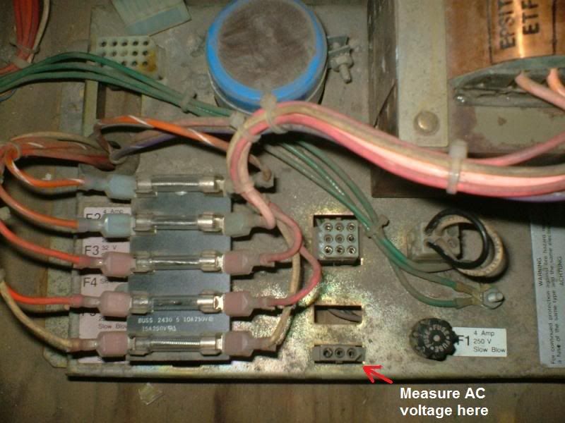

Check the voltage on the outside pins of the connector indicated in the pic below. That is the voltage for your marquee light. If there is no voltage there, then the problem is in your line filter, line fuse, power switch, interlock switch, or the wiring between them....
OK!!!!
getting 117.5v AC there!!! is that correct??

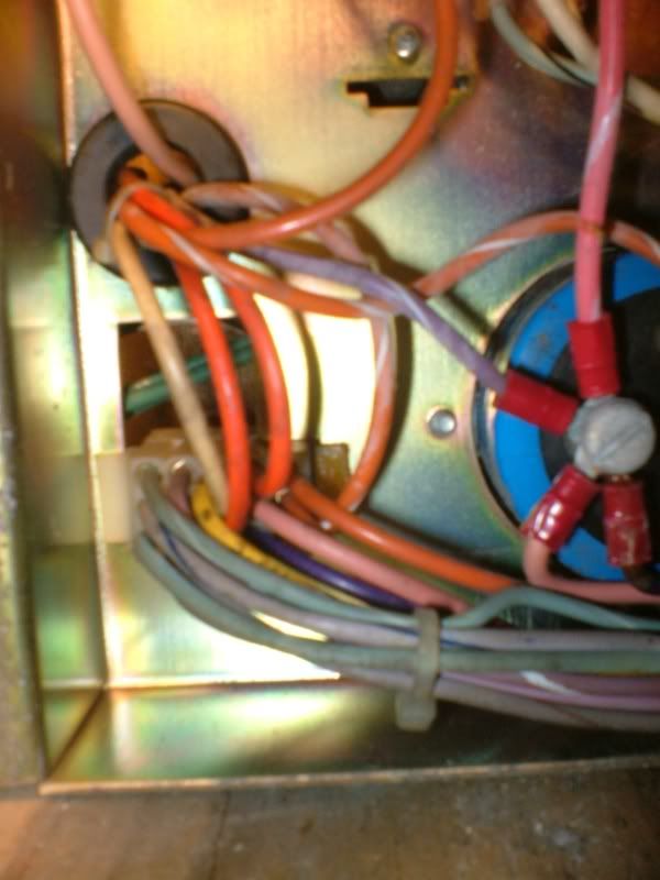

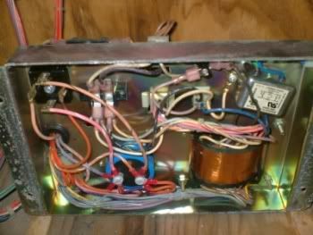

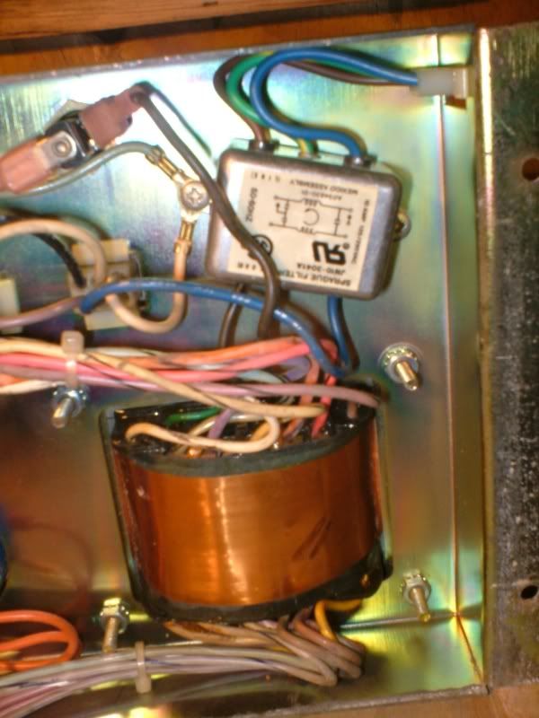

Post a bigger pic of the underside of your power brick and I will check the wiring (later tonight) to see if I can figure out where the power is being lost...
ok here is the underside in several photos.. over two posts!!!
hope you can help modessitt!!! Thanks so far... im crossing my fingers at this point!!!
1 - bottom left... under the terminal that send power up to monitor (and others)
2 - bottom middle
3 - right side
