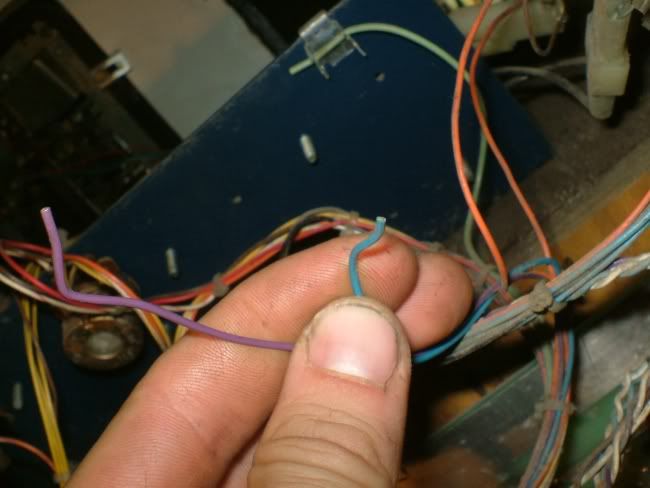

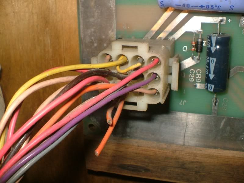

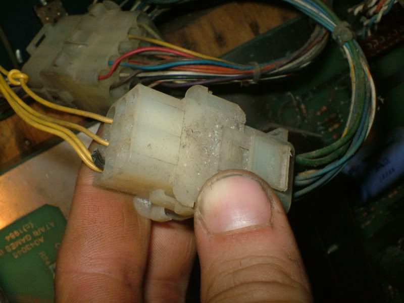

ok... I am due to work more avidly over the coming weekend on this... for now, here are a few more pics to show what we are up against here!!! (calling all miracle workers!!!)
1 - notice the wires that seem to be cut but dont have an obvious place where they should go (perhaps into a terminal...) (arrg.... i got to learn the schematics!!)
2 - here is a block connector near the audio pcb... what the.... notice the two black wires that seem cut close to the block.... ??
3 - mounted on the audio pcb itself... a terminal that has 2 x Orange wires and 1 x yellow wire (look harder you can see it) that have also been snipped....
ooooh dear me thinks!!!!
