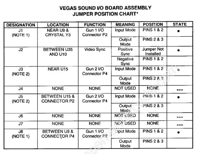

Well, we can officially close the book on this. I looked through a .pdf of the manual and went through both boards. I had bought this game without a monitor, and with everything kind of scattered around.
In looking at the manual, I found that the jumper was installed on the positive/negative sync pins (perhaps a different brand/type of monitor used to be installed in this, IDK), with positive being the default option and negative being the jumpered option. Take the jumper off, game fixed.
I guess I should feel pretty stupid about this. At least I capped the monitor (it looks great), and the game works. Thanks everyone.

I don't know that we are talking about the same thing. Here is a picture of the page in the manual. The only change I made was taking the jumper off J2 on the I/O board. It was installed, therefore on the "Negative Sync" setting.
