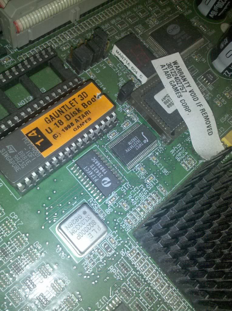

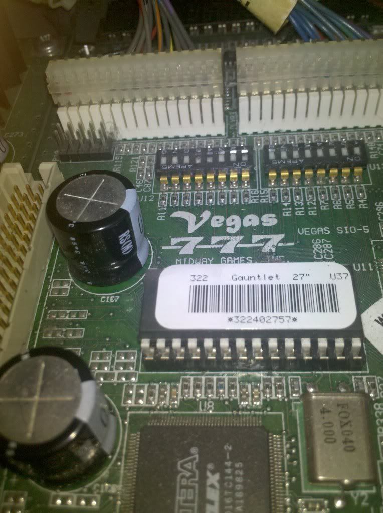

Thought i had a video card problem in this Gauntlet Legends I had picked up since the LCD on board cycled to 8 and flashed 3 times before cycling -. I bought a new replacement card and im still getting the booting tone but it only gets to here on the screen
No valid home blocks found. qid error---edf on file
I have tried to research this but been unsuccessful. I bought this game last week and owners were just suddenly getting this message after about 5 hours of play. I wasn't able to reproduce the message while i was there so i bought the cabinet off them and figured it was a video card swap.
They gave me 4 HDD and the few i tested through the test menu seemed to test fine however one was a dark legacy (doesnt match the roms on board), and the other 3 dont mention the version type. Version type of the rom is 1.4
THanks for the help!
Steve
That would be a hard drive or hard drive image issue.
The fact that you're seeing any messages at all on the monitor means it's not the video card.
Easily enough fixed.
If your drive itself is good but the image is bad, you just need to find someone here with the proper image that matches your roms and get a CHDMAN dump of their drive and you're back to working.

Anyways the problem that i overlooked and caught on these pictures is that that red line on the ribbon cable is on 40 and not pin 1. i just flipped the cable and whalla as i was plugging it in wrong! now 3 of my 4 hard drives work no problem. The HDD that doesnt work is a dark legacy one so that's expected!
