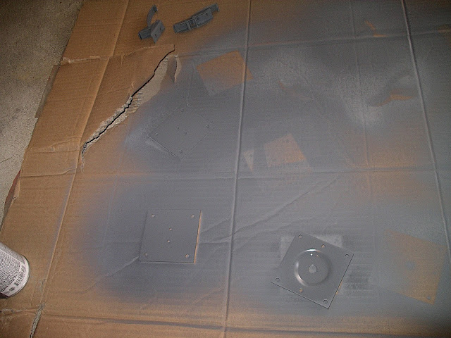

Primed all the hardware going back inside

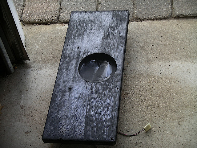

repainted the speaker shelf
its drying in this pic

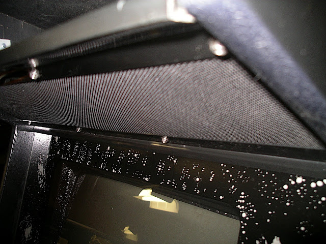

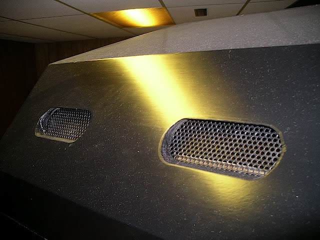

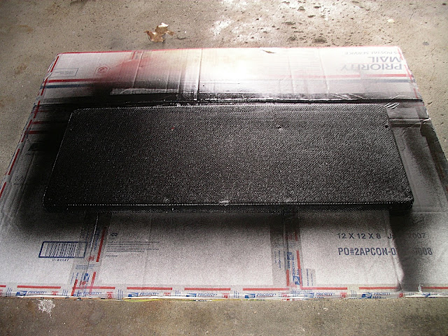

Repainted the speaker grill as well

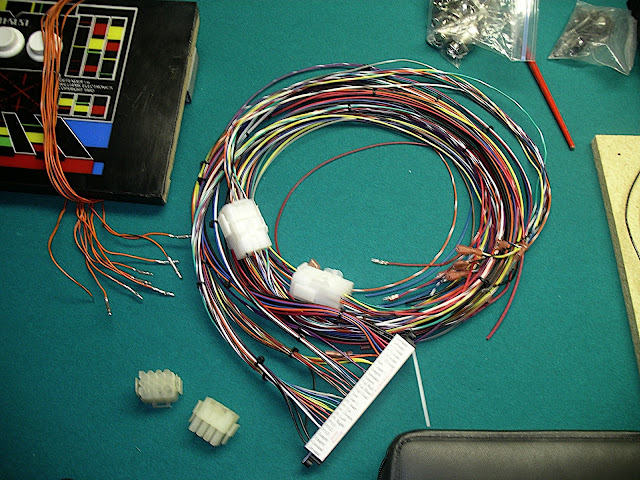

My Bob Roberts harness almost ready.
I am repining the orig cp so I can swap the orig defender cp with the multi cp after I finish that.
I'm getting good and crimping those pins and sockets.....

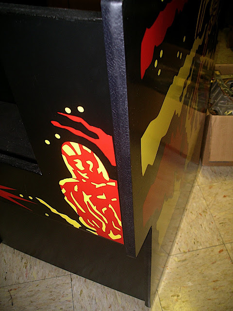

New t-molding installed
Coming together nicely

Its a Bob Roberts jamma harness kit
If you need parts Bob is the man.
I see several jamma harness kits listed on his site.
Economy JAMMA Harness
Super-Super Economy JAMMA Harness Kit
Fully Loaded JAMMA Harness
Super-Super Fully Loaded JAMMA Harness Kit

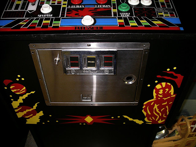

Finally finished cleaning up and reassembling the coin door.
Some fine steel wool and lots of elbow grease and some chrome polish produced the these results
Spun the bolts in my drill against the micromesh pads of progressively finer, and finer grits, they turn out really nice
Before
After
Did a test fit of the coin door
I completely forgot about the metal frame having a specific top and bottom.
At first I thought oh shit I am going to have to make the hole bigger cause it was hitting on the bottom, after I stared at the pieces I finally realized that I had them reversed.
Here is a shot of my first test fit
Another after I realized the top and bottom bracket were reversed
After I was sure I originally measured correctly I drilled the new bolt holes
and reinstalled the door

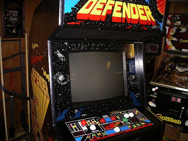

A full frontal
damn gator that came out niceeeeeeee!!!!

Finally the Money shot :)

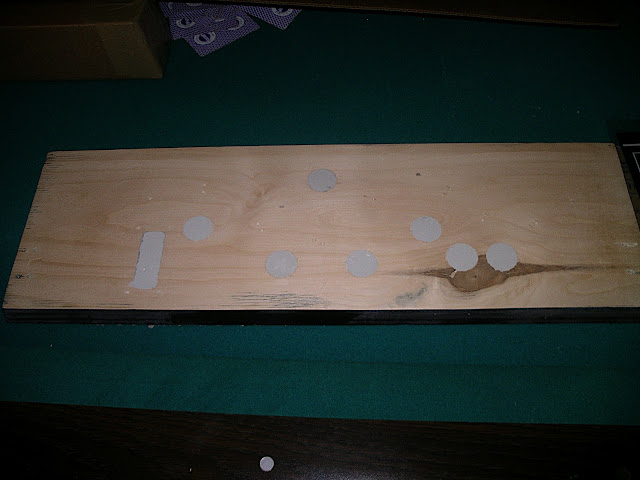

I bought a used Defender cp and stripped it, filled all the holes with bondo, sanded and repeat, painted and finally had the time to cut some plexi. Multi Williams control panel coming soon!
I have to get over to my Fathers house and use his drill press to cut some holes.
Here is the panel after I filled and sanded it.
For the cpo button positions, I used an old broken leaf switch button holder and cut it so just the round piece was left, this way I had a nice positioning tool for the buttons on top of the cpo, I made sure all the button placements looked correct and did not overlap where they shouldn't, and came close to where they should. Hard to explain but look closely at the cpo and you will see my pencil marks I'll use those as a drill guide. I'll will eventually cut theses holes using my Father's drill press so they will be nice and straight.
