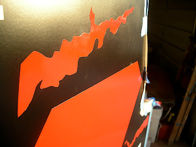

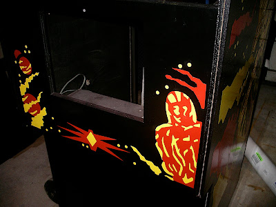

Is that red paint really on as thick as it looks in this photo?
It's an illusion.......I only did about 3 or 4 light coats or till I had complete coverage with no bleed through of the black, I may have waited a tad to long to pull the stencil off, so what appears to be a hard edge is actually paint that skinned over and I don't know "snapped back" after I pulled the stencil. I waited till it was dry and just used a lint free cloth and most of the hard edges just wiped off after it had time to fully cure.
I ran my finger over the edges,with light pressure,just after I pulled the stencil off.
That pushed the edge down and made it look much smoother.
I did this to the edges that kinda pulled a bit and looked a little jagged.
That made them nice and smooth and sharp.

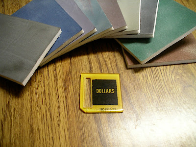

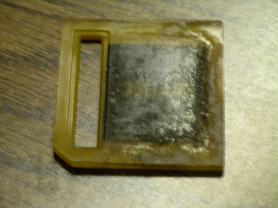

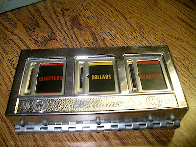

Started cleaning up the coin door and parts
Used those micromesh pads and these cleaned up great
All of them needed a good sanding, but it looks good enough for this job!

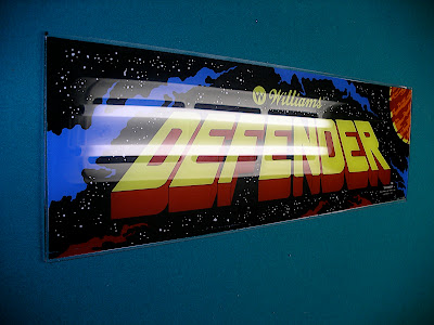

Since I had the pads out I even cleaned up the marquee

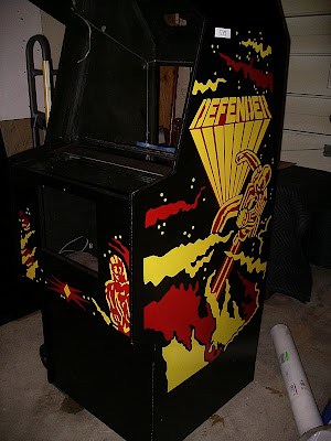

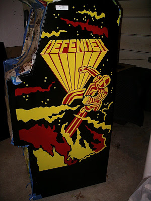

I even finished 2 sides of yellow
These stencils absolutely ROCK!
It looks even better in person!
I can't wait to finish, getting close to bringing it in to finish up the detail work.
Finished up the yellow today
Rt side
Lt side
and front
pretty clean lines for a first timer
Now just a few light coats of clear and inside it comes!

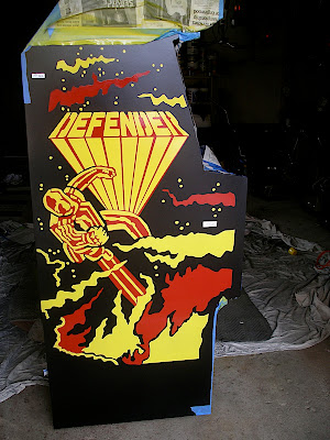

One thing happened when I was removing the last side of yellow.
A small portion of the stencil snapped and fell paint side down on top of guess where,...........
I knew right away that wasn't a good thing.
Right on top of a freshly painted area, so I had paint on paint, I said a few choice words after I pulled it off.
Needless to say, I was more careful after that. It touched up ok but really made me mad, cause the rest is so damn near perfect.
I am hopeful after I clear it, no-one but me will be able to find it.

Red and yellow color?
I saw your stencils and am thinking about doing the same with my multi-Williams. Your colors looks great. What colors and brand did you use for the yellow and red?
Krylon
Red Pepper
Sun Yellow

I repainted the speaker panel and all of the grills, speaker panel grill, back of cab vents top and bottom. I also cleaned up and polished all of the marquee and bezel plastics, which turned out great.

Marquee, and marquee brackets lower and top (Marquee looks awesome after I polished up with novus 2 then 1

Still need to finish the coin door
