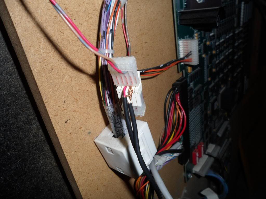

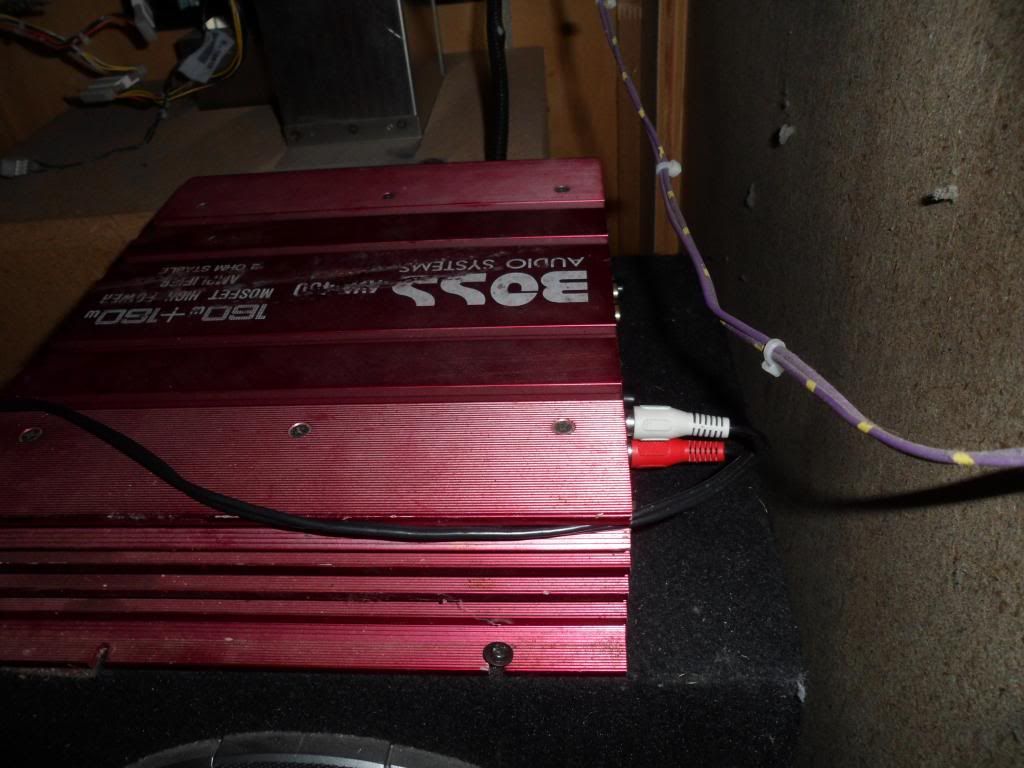

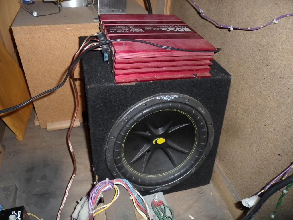

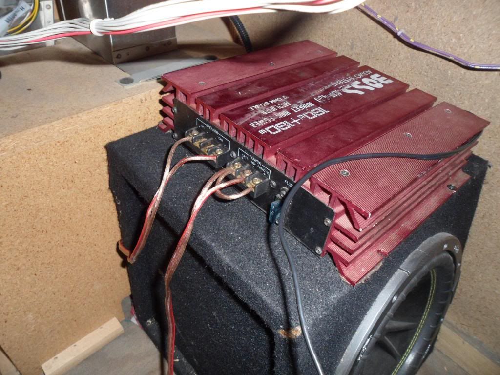

I installed a subwoofer in my KI cab. I had my old amp, sub, and power inverter sitting in the garage collection dust, so I gathered it all up, installed everything and it's...amazing. Here's how it works...
1) Mount amp to top of sub box.
2) Splice 115vac - 12vdc (15amps) inverter power cable to cab's 115vac power.
3) Cut some RCA cables and put them in-line with the cab's speaker wires.
4) Run the wire from the inverter's "+" to the amp's "+12 and REM" connections.
5) Run the wire from the inverter's "-" to the amps' "GND" connection.
6) Turn on inverter and adjust amp volume/equalizer according to taste.
