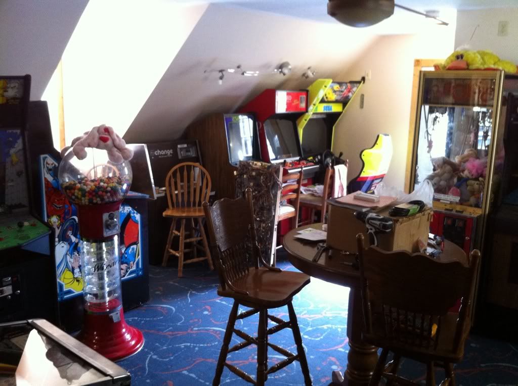

Ok, finally did something.
Eclipse curtains from Walmart at $10 each. Easy and effective. Kid's versions are a bit more colorful. I still use the windows, so I wanted something I could still open and close.
Not 100% blocked light, but it's actually less than what the picture makes it appear. Suitably dark for gaming!
Big improvement indeed! I love my Eclipse curtains so far, it makes it pitch black in the middle of the day. I admit that I got anal about that little bit of light around the edges, so I bought some black posterboard and rubber cemented it to the windows as a first defense (I have no plans to use the windows though).
Do you have any pics of your room with the curtains in and blacklights on?
